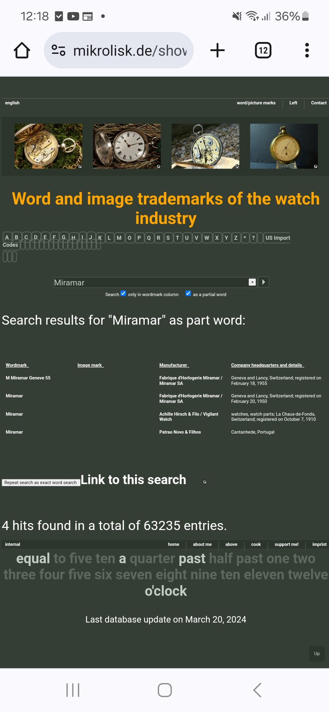

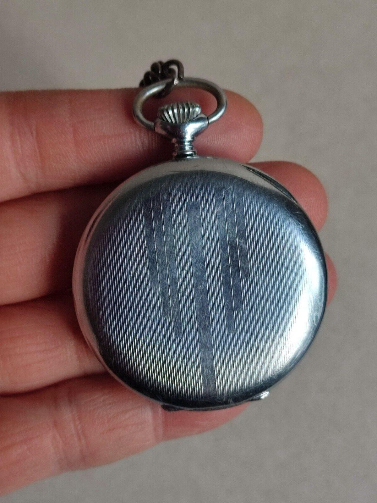

Hi all of you,
I've found a Miramar pocket watch on eBay and I'm looking forward to receiving itĀ šŸ˜€ Meanwhile I'm doing some research, but I haven't found much information about that manufacturer.
Would anyone have interesting details?

I notice the dial feet screws are not present between the plates, maybe the main-plate has them in the side...anyhow the dial will need to come off the view the setting mechanism for finger printing like RichardHarris said...
