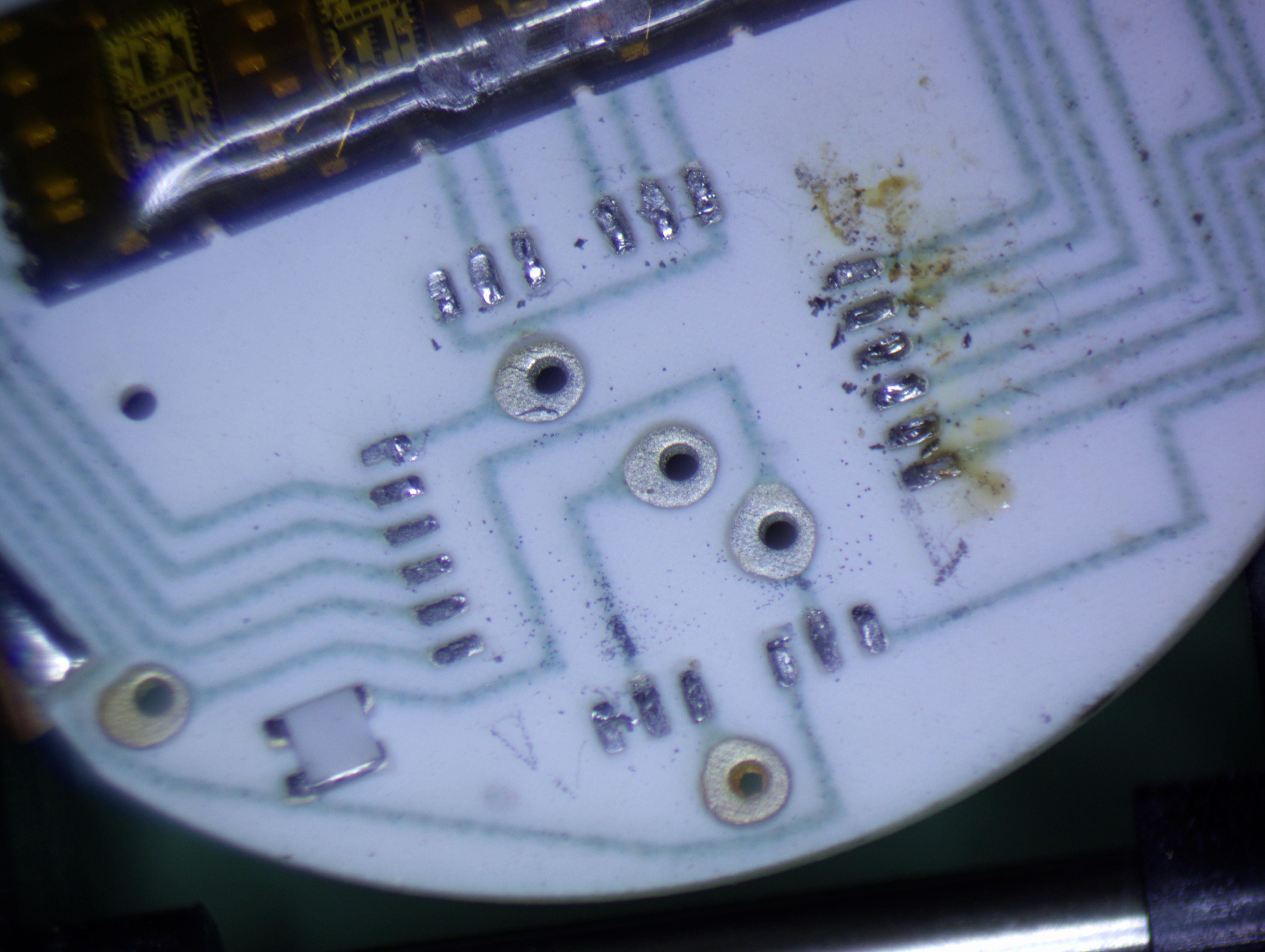

Testing continues. I de-soldered the main chip from the broken board to find out where the vias underneath it go:

And then I took a closeup picture of what I assumed is a trim pot, but when I measure the resistance across it the value slowly rises as if it were capacitive. So I'm hoping someone here can tell me what we're working with.

...I'm already considering turning this circuit diagram into a manufactured PCB. I just have to figure out the mystery square.
Do You consider Youself capable to produce PCB? I mean, You thought the adjustable element is resistor, and now I see that You don't know what is the 'mistery' square. And it is the quartz crystal...
Further more, what You did in the video is absolutelly out of healthy reason, and IF the chip that You touched with the tweezers (conected with the Vcc) is still working, it will be only because there are current limiting rezistors inside for the display segments driving outputs. I hope You didn't touch another legs but only segment drivers...
Do You know what is dynamic indication? This is the type used in this watches. My advce is to find and read some information on how it works, then to understand what type (common anode, common cathode) display is it and how exactly the display driver drives the display. Untill You understand everything well enough, it is highly not recommended to make experiments, especially if they include using power supply.

Thank you for your kind advice. So you're telling me this is the quartz crystal:
And not this:
That's so strange. I thought the first one is a capacitor (after further testing) and the second one is the quartz crystal.
But I'm here to learn, so thank you for your input. I will put the project away until I learn everything I need to know to continue.
Sorry, this is a (small, 3-5 pF) capacitor and it is in paralel to the quartz crystal. And the quartz is on You second photo. I just traced to where it is connected and it is connected on the place where the quartz must be connected, and sometimes quartz crystals have strange look. I didn't have the image of the other PCB side, where the crystal is seen
the thing that looks like a crystal and functions like a crystal is there to confuse you. Is to confuse you into thinking it's a crystal because that's what it actually is. Then the other thing it looks like it has four leads? but sometimes on surfacemount components you can have four leads for component that might only need two leads.
I did realize later it only has two leads, top and bottom.
