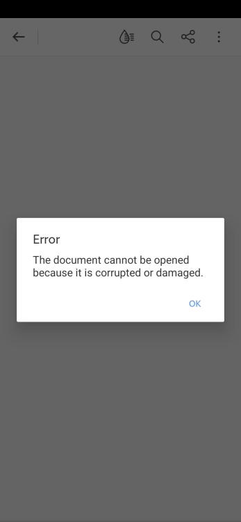

Hello Jon, I  get this.
I opened it too, and can asure that it is good and thorough.

If you have no Powerpoint at Hand (but Libre-Office or whatever..),
to get Access to the Videos in the pptx, make a Copy of the File, rename it to blabla.zip and unzip the File.
Now in the Folder ppt/media you have all Pictures and Videos......
hope this helps some of us
