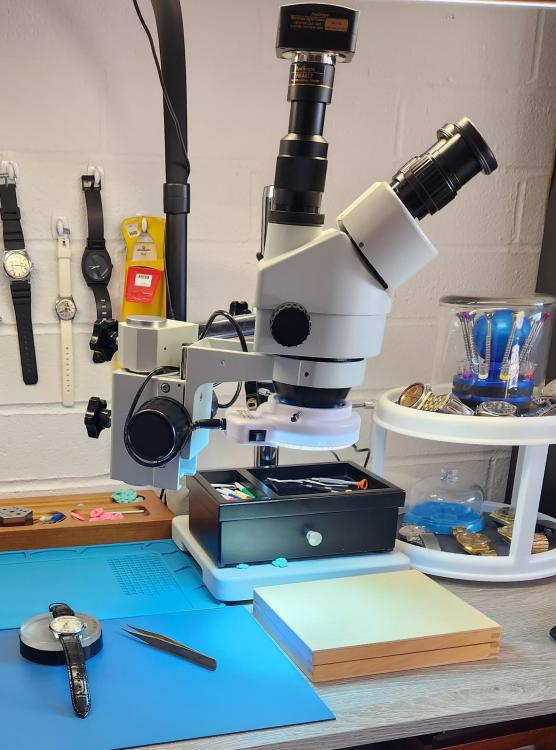

I know this has been covered but wanted to share my experience. I have read all the threads in this subforum and know this is all been discussed in length and it boils down to personnel preference. I think that a stereo microscope is an essential tool and most watchmakers should have one for their low bench. for the other 10% of work on a high bench a 2.5 (inches of focal length) Bergeron loupe is what I use. I got the trinocular and back earlier this year it cost $498.00, all in (without the camera) with the Barlow lens, shipping, tax everything. As Alex Hamilton on his youtube channel and Klaas on Chronoglide says, it is a game changer and WILL make you a better watchmaker. You can't work on what you can't see. You can tilt the head so that your hands are not in the way (this is set at about 6% - i know because on my photo cropping tool I can rotate the image and it gives me ! degree increments that I can use to line up the horizontal lines on the scope). I have a range of working area under the lens of 15 to 20 cm, depending on the zoom. It also has another 12 cm of "play" to adjust the range to fit anyone's bench and chair heights, and seat to eye level height.
The eyepieces can be adjusted to individual eyes both focus for differences in eye strength and width to get the center of your eyes in the center of the lens. The cups can be rolled back on the eye pieces for glasses the same as birding binoculars and adjusting the  eyepieces is exactly the same as on field binoculars in that you use your dominant eye to fine tune the focus in that eyepiece (with both eyes open), then leaving your dominant eye open block it (you can close it but technically you should have both your eyes open when doing this adjustment) and adjust the focus on the other eyepiece. Klaas does a similar adjustment discussion on his youtube channel as well as a couple of other useful tip on setting up the scope. Hope this helps someone interested in obtaining and setting up this tool.
20231029_0827402.thumb.jpg.5028e25b4b6a1c8f7cd577ace9eb18db.jpg20231029_0947002.thumb.jpg.a1c55b07bc5cb8f2bf20b84610669bd9.jpg20231029_0824282.thumb.jpg.0c4d65bbf91a168834c5addf7817fe7d.jpg
Here is my set up. Yes, I know I have carpet, but I do have a chair mat and a nice padded professional stool. Thinking bout adding a second mat and sliding the other one over that will get me to a hard surface under the entire work area.

Nice tidy set up Razz, light,airey and  uncluttered, i particularly like the tall cabinet on the left. I dont know why folk rag so much on a carpeted floor. If you drop something on a hard floor, it bounces and can roll off to anywhere. With a carpet it stays where it lands, i find a short pile carpet perfect, the old magnet and torch find it easily.
Thanks! Yes and with my 2 foot magnet bar within reach, I can sometimes find something dropped within the first sweep or two. The problem is with serious pinged parts, but then hard floors don't help much if it is on the other side of the room (which is much less cluttered as well)!
