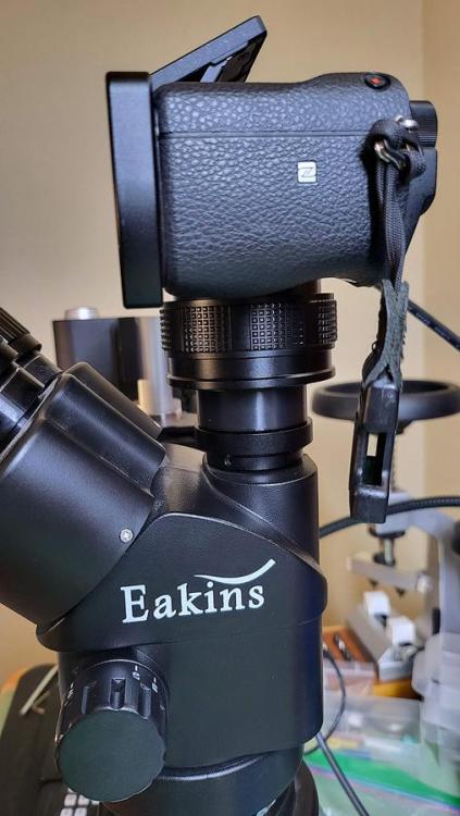

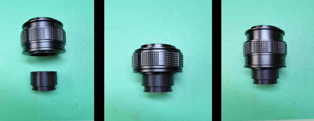

I've been looking for a way to connect one of my mirrorless cameras to my microscope since I got the scope. I've never been particularly happy with the camera that came with the scope, not just from an image quality perspective, but there are some functional issues that really bugged me as well. One of the biggest issues was that if the exposure was perfect when zoomed in, if you zoomed out it was way overexposed. So I would constantly have to adjust exposure by going into the camera menu, dig down to the exposure menu, and then adjust. Every time I zoomed in and out. Then there is the file naming issue where it will reuse the file name as soon as you delete the files from the card. So if you were working on more than one watch at a time and moving the files off of the card, you would get files with the same name when you came back to work on one of the watches. Then the camera just started to randomly stop recording for no reason so I would look up at the monitor and realize the camera had not been recording for who knows how long.
So, I went down the rabbit hole looking for adapters to connect my Sony a6300 to the microscope. Most adapters seem to be for Amscope microscopes which, I believe, has a different trinocular port than the Eakins. But the reviews for the Amscope adapters are hit and miss regardless. I don't think the optics in the adapter are particularly good. But I really couldn't find anything that was as simple as, "use this adapter for the Eakins microscope and a Sony aps-c camera".
I came across this video which looked very promising, although it was for a different microscope and camera. But the video does explain why adapters even use optics. Which it turns out, you really don't need. You can just project the image from the microscope directly onto the sensor and avoid subpar optics. I had a concern for the design he used as the length of the adapter needs to be perfect. If it is off even a fraction of a mm then the camera will be slightly out of focus when the image is in focus through the eyepieces. Seemed like it could entail a lot of trial and error getting the correct dimensions. I've come across M42 adapters in the past that have a helicoid focusing ability, often used in macro photography. Using one of these will move the camera (and sensor) closer to or further away from the microscope and will then let you dial in exactly where you want the sensor to be.
So the adapter drops into the trinocular port on one end (and is fixed with a grub screw) and on the other end it screws into the M42 adapter which you can then focus using the helicoid. The image is parafocal between the eyepieces and the camera. It works perfectly. I actually get a slightly wider FOV in the camera compared to the eyepieces. When zoomed fully out there is some vignetting and I get a FOV of 68mm, compared to 61mm through the eyepieces. When zoomed all the way the FOV is 10mm in the camera and 8mm through the eyepieces.
If anyone is interested I have freecad and stl files on Thingverse but it looks like there is a 24 hour hold until it is published so it should be available tomorrow.
They don't seem different.  I believe that both will take a 28mm screw in camera adapter and if you remove the threaded ring from the port, you can use that other style of adapter that uses a grub screw to hold it from spinning.
I think it depends on the camera.  The sensor size and if the camera itself has optics.  I know when I tried a 0.35X C mount adapter with my camera, I got an increased FOV for the camera compared to using a 0.5X C mount adapter.  With zero reduction in magnification, then I would have a tiny FOV for the camera.  So, I definitely need some optics in there to decrease magnification in order to maximize FOV.
I thought that I had seen some Amscope's with fixed photo tubes on the trinocular port but I may be thinking of other scopes.
Regarding not needing optics in the adapter I probably could have been more clear.  I was specifically talking about adapting full frame or APS-C cameras to a microscope. What I was saying, as he does in the video, is that optics are not necessary if you are able to position the sensor where the plane of focus is. Most of the small sensor 'usb' cameras have the sensor in the body and those will need optics to pickup the image at the plane of focus (in the tube) and project it onto the sensor (in the camera body). He shows one of those cameras, and then at 1:42 he shows another USB camera that actually has the sensor in the tube, not in the body, so that the image falls directly on the sensor and optics are not needed in that camera. With full frame, APS-C and likely micro 4/3 cameras, you should be able to position the camera with an adapter that doesn't have optics such that the image is projected directly on the sensor and those sensors are large enough that reduction optics shouldn't be necessary.

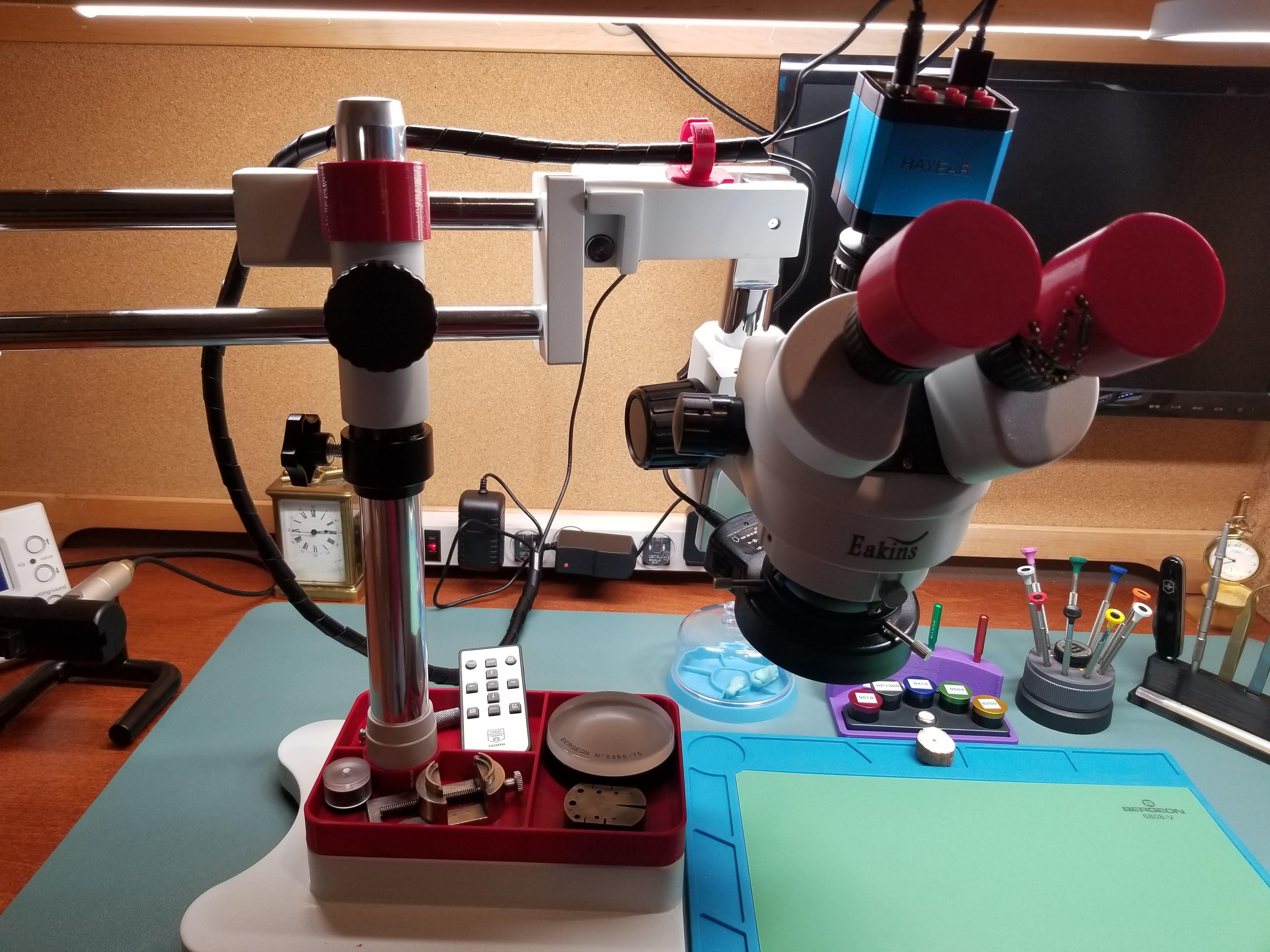

I've been adding some 3D printed accessories to my microscope.  Found the STL files online and tweaked them to my liking.  Though, I might do a bit more tweaking of the cable guides.  I like the extra storage that the tray provides to make some of my commonly used tools handy instead of having to dig them out of a drawer.
I happened to have a length of cable sleeve tube handy to also help tame the cords.  I traded out the old thick and stiff HDMI cable for a new slim and flexible one.
Edited by gpraceman

The 3D printed accessories are super cool. One of these days, I'll get my printer operational again, or I'll sell it and get another. Actually... I think I'll take advantage of the holiday season and get it on FBMP this afternoon... What am I waiting for?

Just what I need, another gadget to spend time and money on, but you better give me the model number of the 3D printer.  It does look pretty cool, sigh...

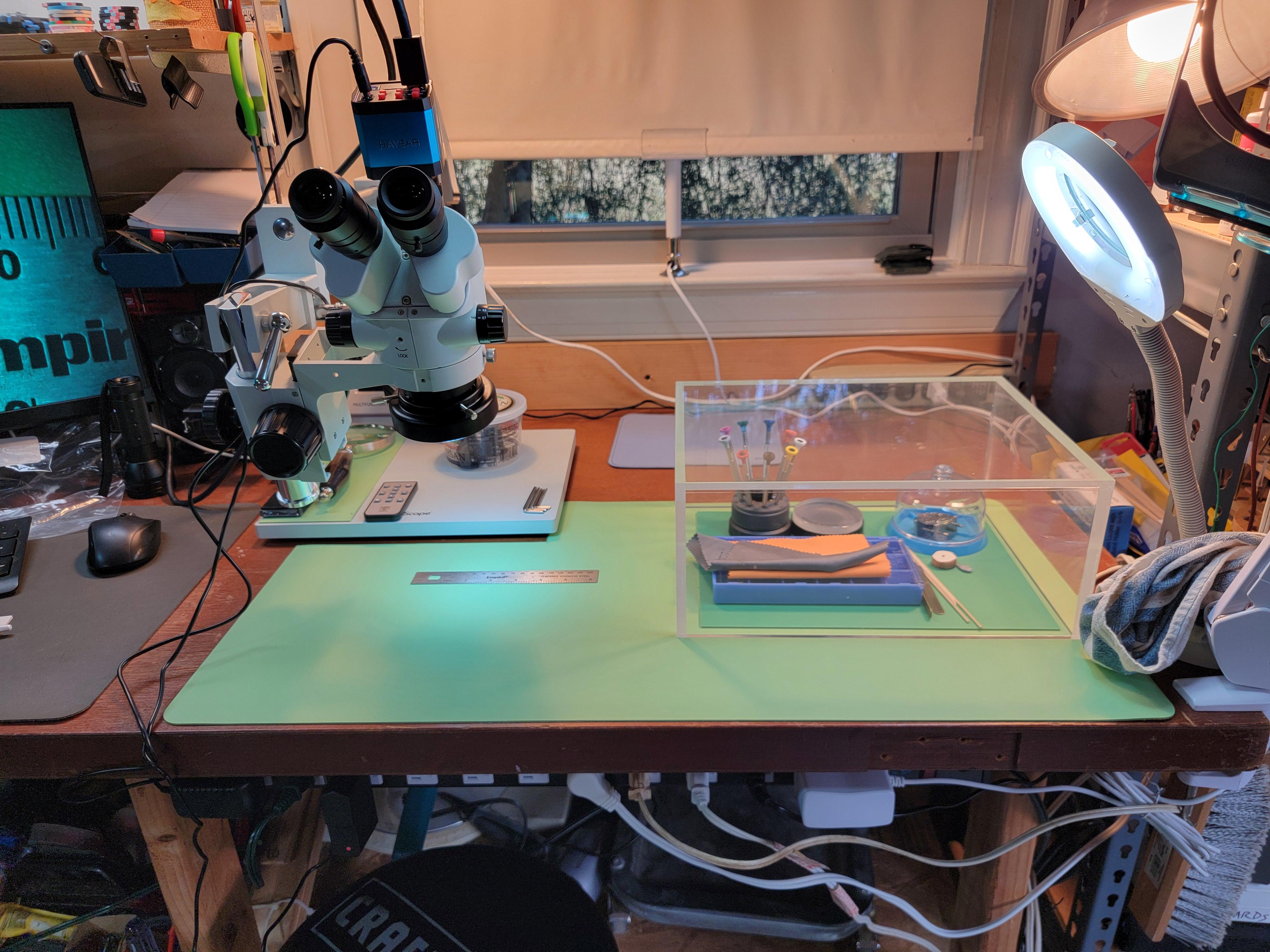

So I finally got my Amscope after @gpraceman reminded me about the simul-focal feature and ordered the SM-4NTP 7X-45X (I actually sent one back to get that feature).  I have a 0.5x barlow on the objective lens and a 0.35x on the camera per Alex Hamilton.  As others have commented, the FOV on the camera is much smaller.  I wonder if anybody has tried a 0.25x or 0.20x barlow to increase the FOV more in line with the eyepieces.  I'm tempted to order one from Amazon and return it if doesn't improve it.
Also, how do you record videos and take snapshots with the hayear camera?  I downloaded software from their site but one you unzip it, it's a .bin file rather than an .exe file and I cannot figure out how to load that in windows.
The other thing that's a bit frustrating is that I can't really get close enough to the eyepieces with glasses on, even if I take off the rubber eye-guards.  I think that parameter is called eye relief or exit pupil or something like that.  I have a pair of really good binoculars and they have the ability to actually pull the eyepiece outward (IE, make it longer) that increases this value and makes it possible to wear glasses.  I'm not an optics expert but I'm wondering what people with glasses do.  Taking them off works of course but it's a hassle.
My last concern is I just noticed that viewing the carera image on my monitor I see a darker region on the right side.  I don't see that through the eyepieces.  Has anybody else seen that?
All in all this is a great product and I'm glad I invested in it.  I'm already doing some watch work under it rather than with a loupe on.
A Barlow lens will affect FOV for both the eye pieces and the camera.  As when trying the 0.3X Barlow on my microscope, it does increase the FOV for both, but you have to lift the boom up to nearly its limit to get it to focus and you lose the ability to use the full zoom range (I only got up to about 2.5 zoom).  I like the upper zoom range for doing jewel inspection.  The 0.3X Barlow can be handy for taking photos/video of a wider area, like a full movement.  Though, I am a bit lazy and don't want to change out lenses to do that.  My solution, until I try a camera with a larger image sensor, is to use my phone to take a photo through the eyepiece.  I 3D printed a mount for my phone to do that.  I get a circular image, but I can get an image of what I see through the eye pieces.
I have only seen 0.35X and 0.5X C mount camera adapters.  If there was such a beast as a 0.2X or 0.25X camera adapter, then I think for my camera's image sensor size that I would see vignetting in the corners and maybe a bit out of focus near the edges.  As camera image sensors are rectangular, there's only so large of a rectangle that you can fit within a circle, before you get clipping in the corners.
The camera comes with a remote that has a button to take a snapshot and another button to take video.  That is assuming that you have a micro SD card inserted into the camera.  Can't say that I like the remote, as the buttons can get stuck in the pressed state if you don't perfectly press the button straight down.  Though, there are snapshot and video buttons directly on the camera, so you don't have to use the remote.
The other option to recording/snapshots is using the USB connection.  You can use capture software like Microsoft's Camera app, which comes with Windows, to take snapshots and video.  You only get 30 fps through the USB connection with that particular camera, whereas with the SD card you can get up to 60 fps, if that matters any to you.
Do you have your diopters for the eye pieces set right?  Turn them both to the silver line on the side.  Focus the microscope using the focus knob.  Then adjust the diopter on the eyepiece for your non-dominat eye until the image is in focus.  Then you should be able to zoom in and out without having to mess with the focus but maybe a smidge.
Check the optics on the camera mount adapter.  You may have something on the lens.  I noticed on the 0.5X adapter that I got with the microscope, it looked like there was a bit of silicone grease on the lens.  I haven't tried to clean it, since I am using a 0.35X adapter to maximize the FOV with my camera (it had clean optics).  If you turn the adapter and you see the dark region move, then it is an issue with the camera adapter optics; otherwise, it could be something on the prism for the camera within the microscope's head.
Mine is a modded Ender 3 Pro.  If I was looking for a beginning printer today, I'd look at an Ender 3 NEO or Ender 3 V3 SE.  The NEO is essentially what I have modded my printer to be, but I like the PEI bed over a glass bed.  There is quite a learning curve to these things.  But once you get familiar with using one, they are oh so useful.  You can find many free designs to print online.  I use https://yeggi.com (essentially a search engine for 3D designs).  I'll find designs and tweak them if necessary, using Tinkercad (free).
It may be a matter of prescription, but I find I can adjust the eyepieces to be in focus with or without my glasses on. @gpraceman mentions the silver line, but there are two types of heads/eyepieces: one has the adjuster built into the head, the other has it built into the eyepieces. This was discussed some number of pages back, and the result to my mind was to get the head with the adjuster built in (what gpraceman and I both have) for cheaper eyepieces. AmScope seems to push the adjustable eyepiece variety subtly through which scopes come up in results, etc. The silver line situation may be different in the other setup.
I imagine if you look through the eyepieces with your glasses on, and your prescription is good, you should have no trouble getting things in focus. Assuming no user error, and getting a little more distance in the lenses is the answer, I wonder if you couldn't unscrew the Barlow a few threads or put an o-ring or some sort of spacer under the eye pieces.

Thanks for that.  I guess to be clear, with my glasses on or off the image is pretty much still in focus but I cannot get a full sized image with my glasses on, IE cannot get close enough to the eyepiece.  But I'm finding that I like the monitor a lot and even though the FOV is smaller I find myself looking that way more and more.  Well, I do have to crane my neck as it's off to the side but I'm thinking of mounding my monitor directly behind the bench.
