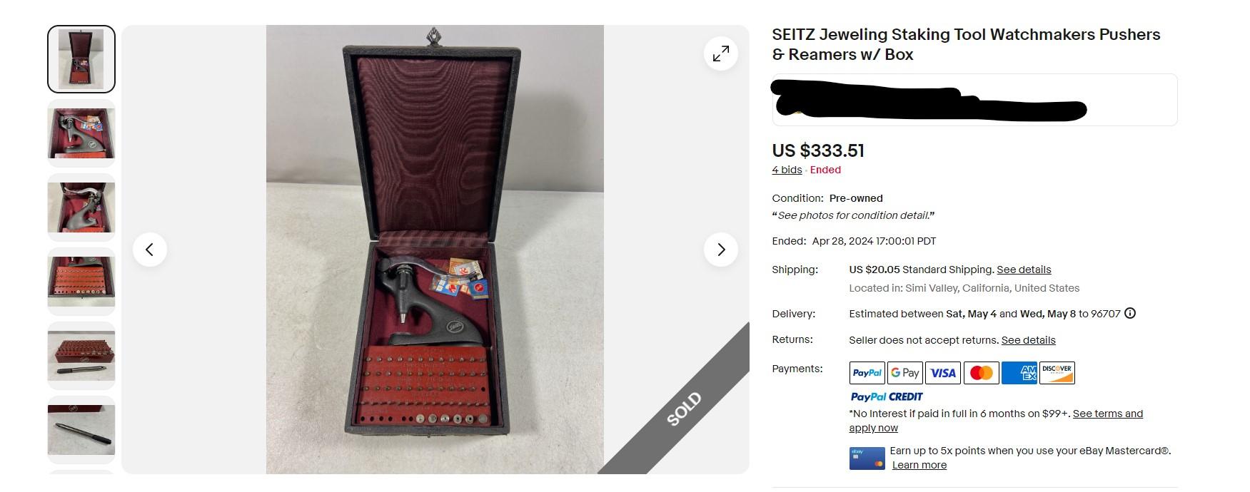

I recently bought this Seitz tool on eBay, but it is missing some pushers reamers.  I ended up ordering new parts for those that were missing before I received the actual Seitz tool (bad idea).   Upon inspecting the pushers/bits, I noticed 23 of the 56 provided with the set had no numbers. Further inspection revealed a huge difference in the quality of those unnumbered.  Do all Seitz pushers/bits have a number on them?  I'm pretty sure that 33 of the 56 I received are cheap Chinese knockoffs.  The worst part is that I ordered $80 of parts to replace the missing pushers/bits, and now I'm looking to return the tool.
I'm not crazy, right? If these are Seitz parts, they should all be numbered, correct? The first two pictures are the Seitz (numbered), and the other pictures are the suspect parts.  Will I even be able to get a refund?

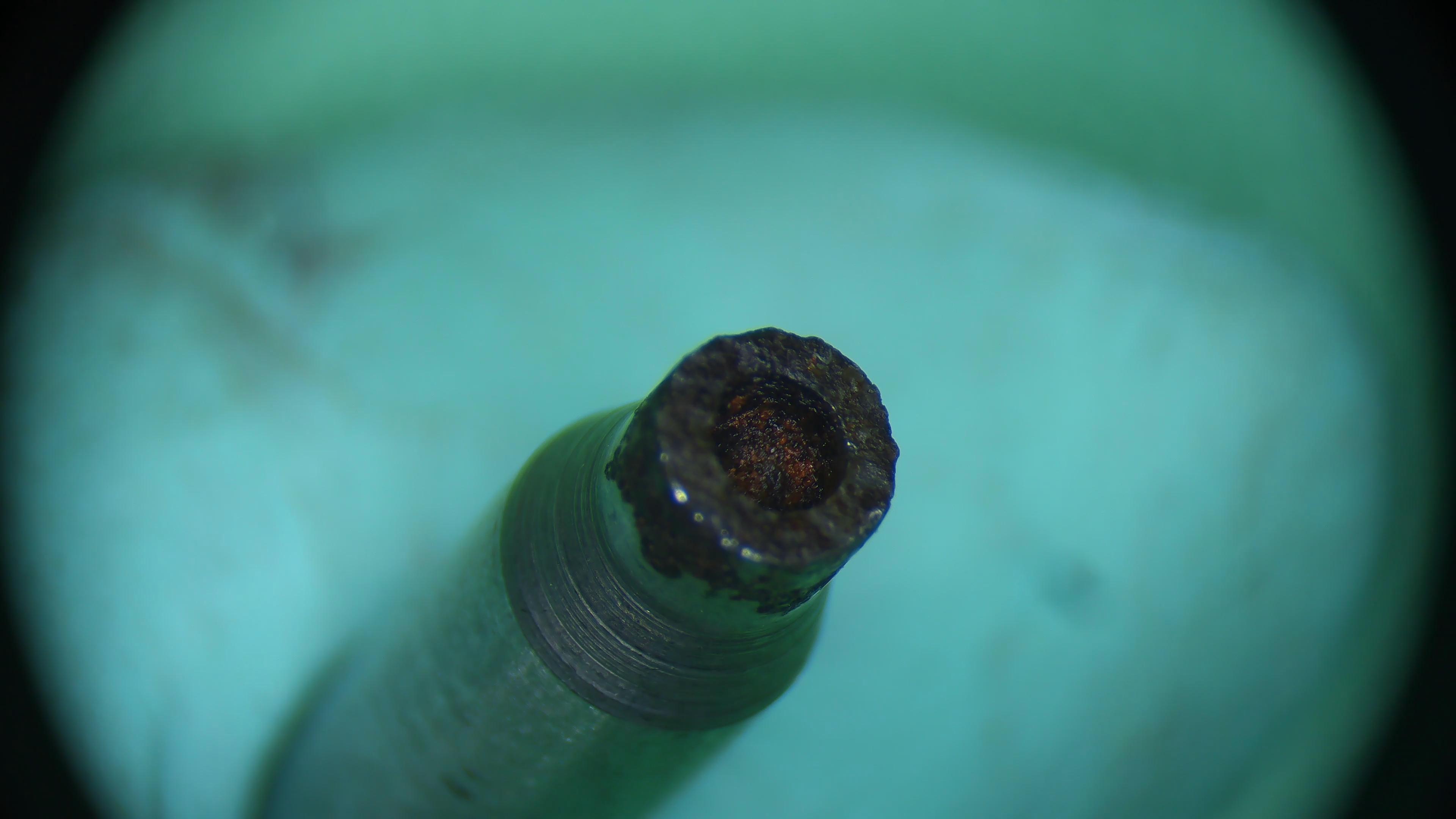

I agree with you. I'm currently looking at them under magnification, and they are consistent in shape and form for each section (flat pushers, pump pushers, concave, reamers, etc.). Though, a few are in bad condition and need to be replaced.  Before I cancel the return I have already initiated on eBay, can any of our members check to see if there are inconsistencies in markings on their sets?
Also, I have included a snapshot of the bottom of one of the pump pushers, which are very unique in shape.  Can someone tell me if the bottoms of their pump pushers match this photo?
I'm hoping that Seitz had some inconsistencies in manufacturing over the years regarding markings.  Crossing my fingers.

The shape of the bottom of the pump pushers is the same as your photo. The only thing that may not be the same is that the slotted insert (looks like a screw but is in fact a bayonet) should be brass. Yours looks the same colour as the steel but that could just be the lighting.

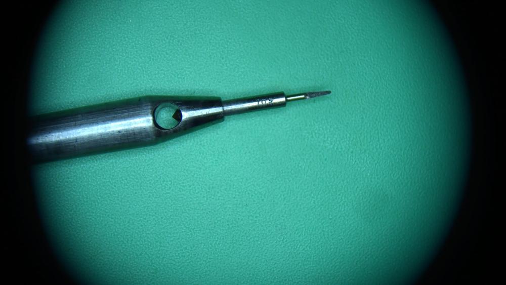

Does this reamer look like it fits the reamer plunger?
Yep, that's exactly how it should fit. The reamer shank is tapered and the socket in the spindle is also tapered so that the one centers in the other and is gripped tightly. If there is any wobble when the reamer is seated as far it will go then there is a problem.
The cross hole in the spindle is to allow you the push the reamer back out again. If the reamer seated much deeper then it would limit the access for pushing it back out again.

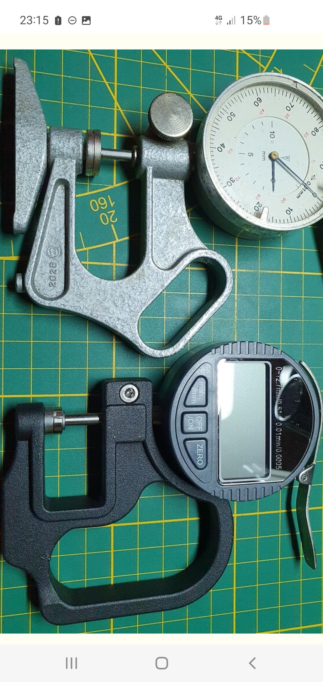

You might want to look for "thickness gauges". They are used for measuring things like paper or leather etc. They are spring loaded like the feintaster. If you file a small section out of one of the anvils, you can measure balance staffs the same way as you can with a feintaster. They are cheap as well (found these for €10..).

I have a micrometer like this or my analog Mitutoyo.  Having the little table to set things on is nice.
