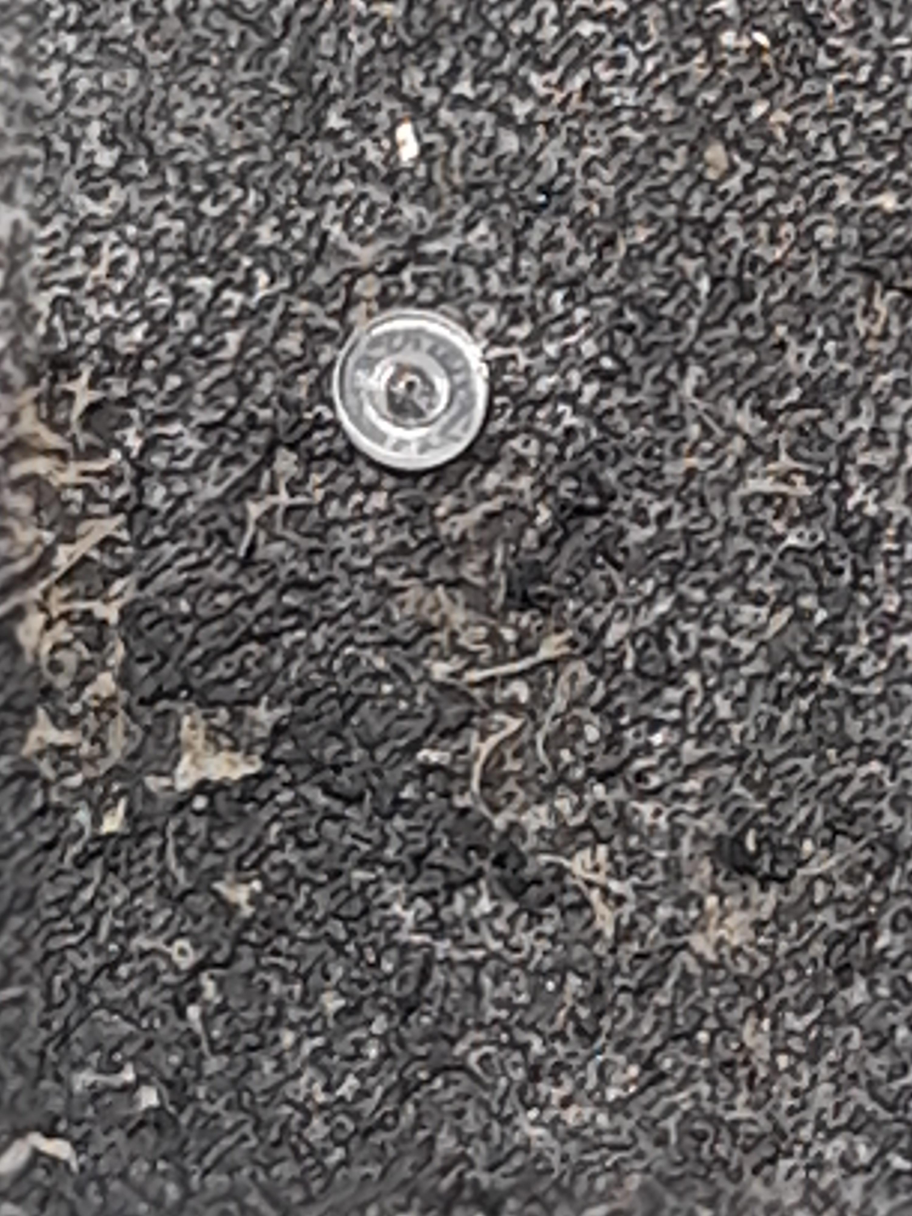

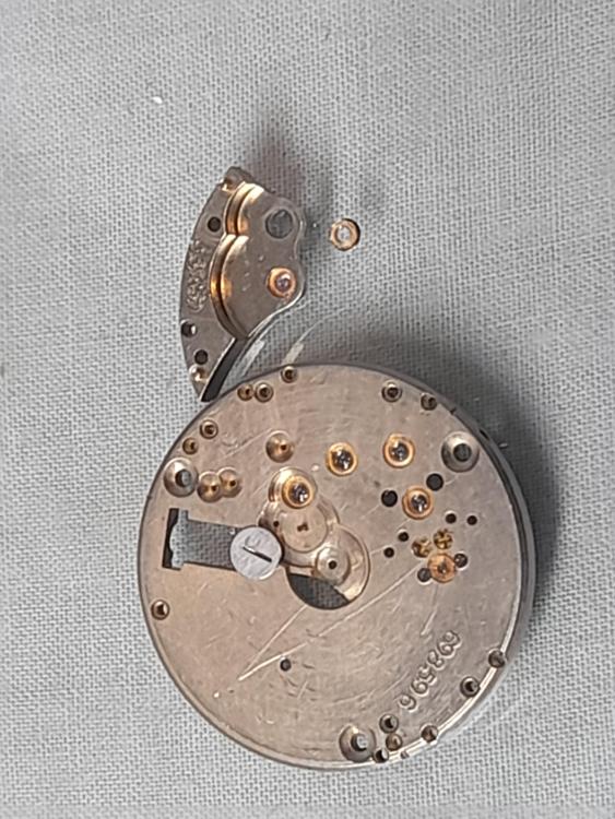

Sorry I'm back again the reason why had   push the jewel out was someone had fitted a wrong one a couldnt get any end  and side shake with the old one ...I'm replacing it.
