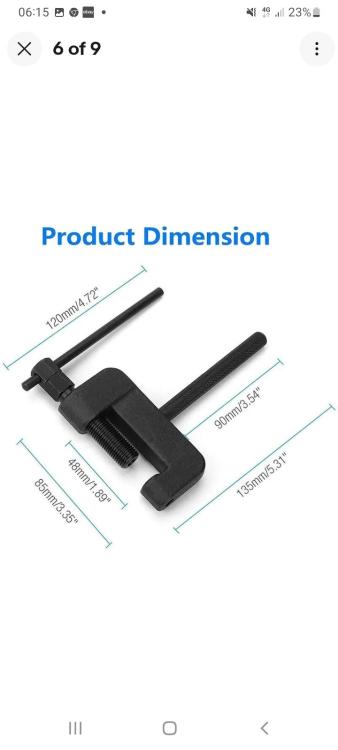

Its not something i have had to do yet, @Waggybut wouldn't any type of press be able to do this ? What about an adapted chain link  extractor work or a micrometer with some sleeve pushers made to slot over the ends.
Something like this:

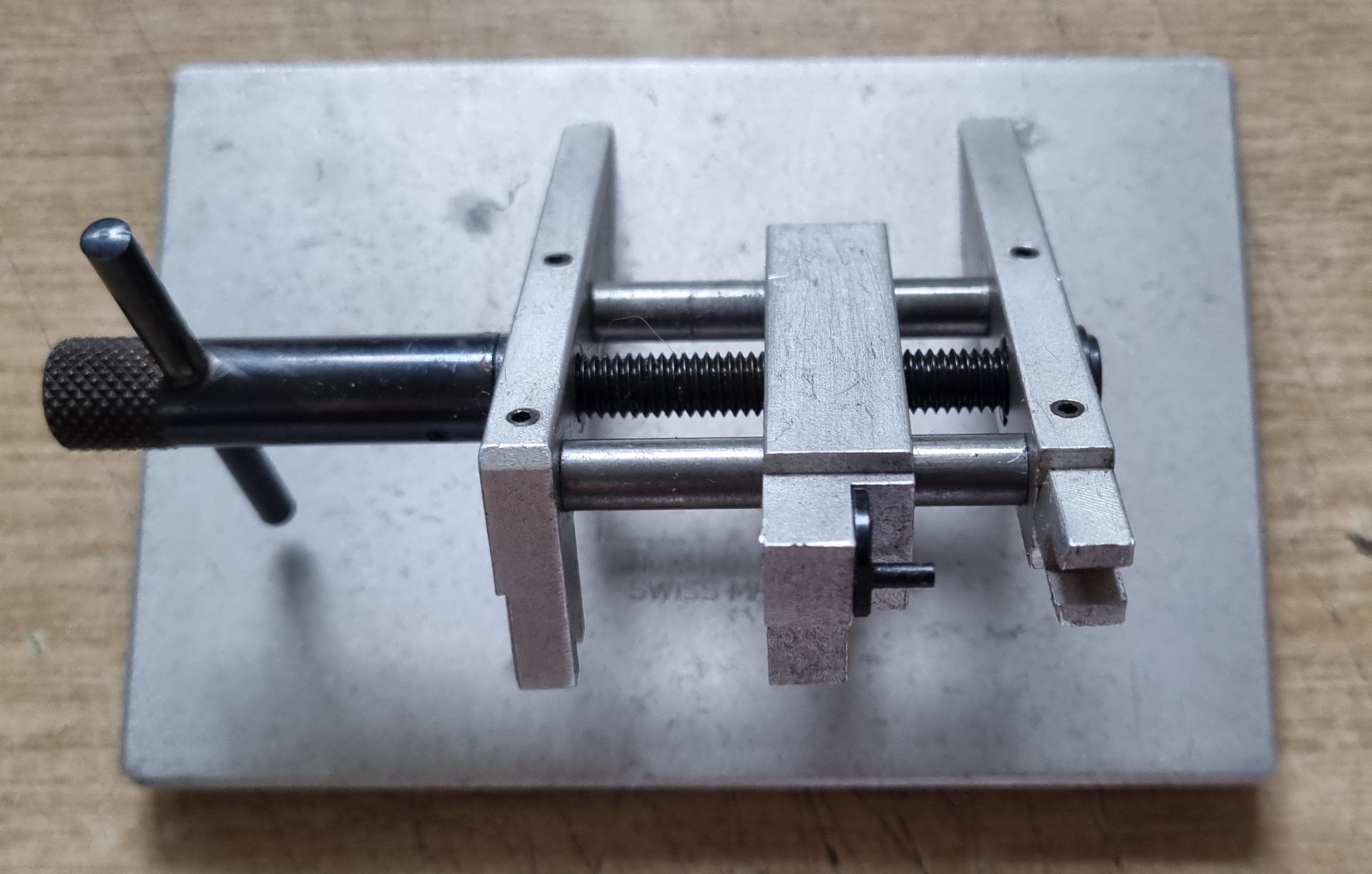

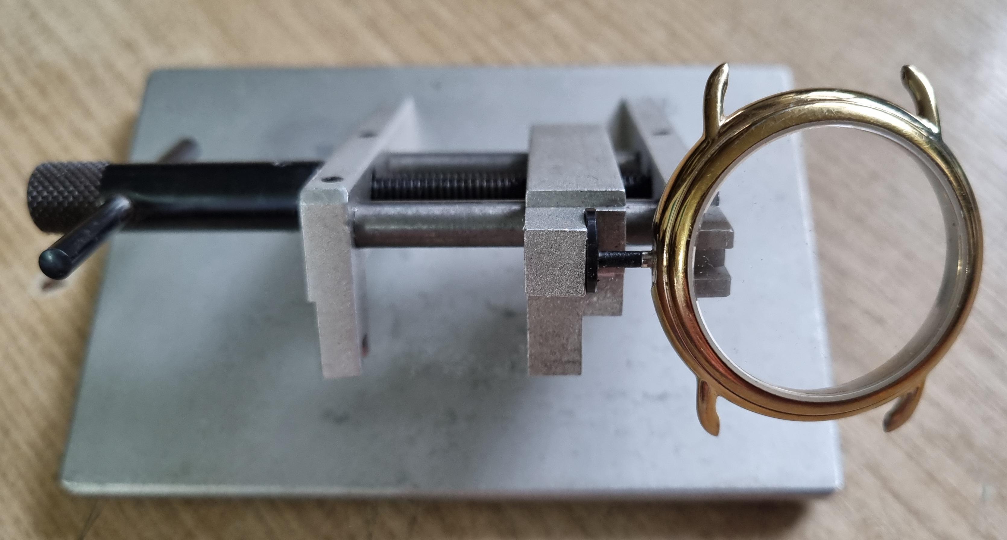

This is what I use.
It's an Etic 350.110 which I have seen described as a pusher removal / installation tool but it works just fine for pendant tubes too.
Here in removal mode...
And here in installation mode.
As you can see the hole where the steel pusher pin fits into the alloy frame has plenty of meat around it giving considerable strength.

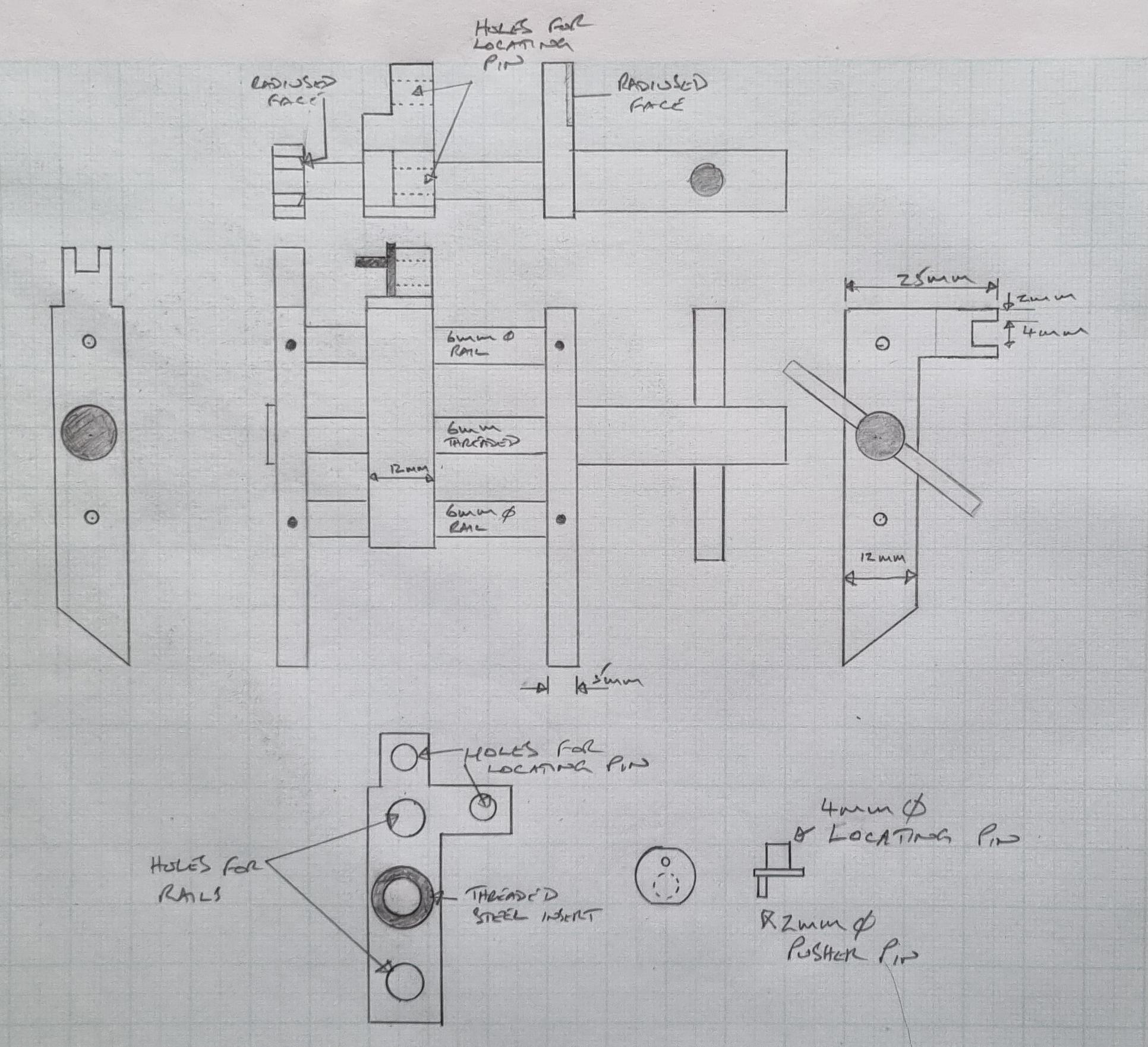

Could you provide some dimensions?  Some of them aren't critical but some are, I could probably make a version of it.
leave it with me, I'll see what I can do 🙂

As promised
I think I've included the most relevant dimensions but the paper is 1mm squared and the drawing is 1:1 so most of the information is there just by counting squares, but let me know if you need more detail.
I have omitted the base for clarity. The frame is some aluminium alloy but the two guide rails, the threaded bolt, the threaded insert for the bolt, and the pusher plate are all steel.
The pusher plate can be installed in either of two locations depending on whether you're installing or removing. Important to note that it has flats on it to lock its orientation to the frame. Also that the axes of the pusher and locating pins are different.
Hopefully the drawing and the photos in my earlier post will give you all the info that you need.
Have fun 🙂
