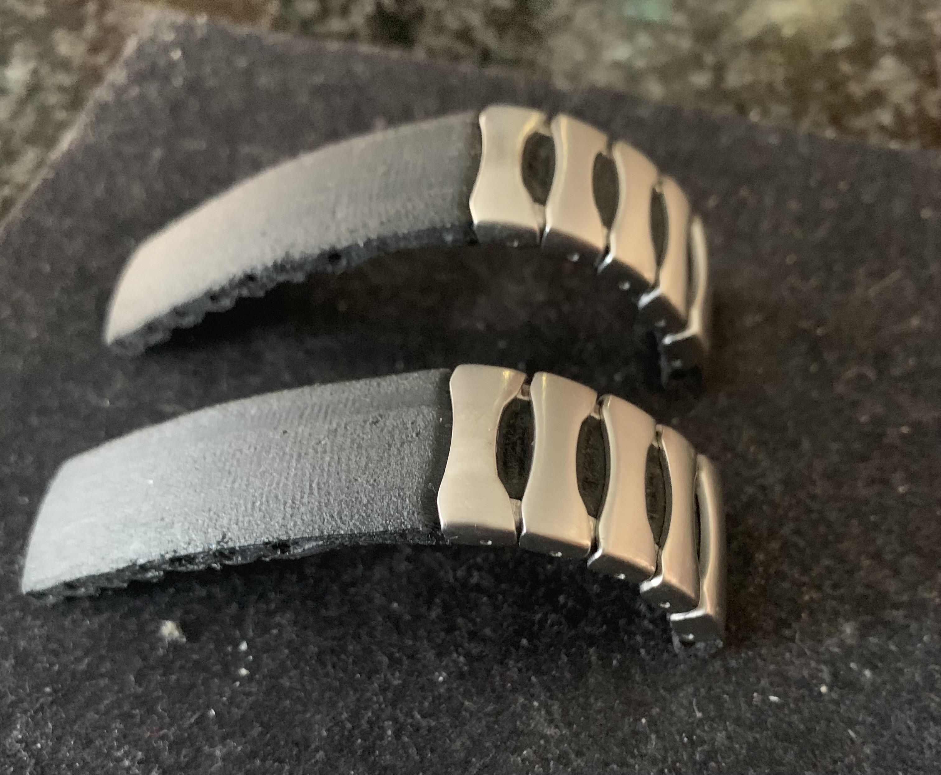

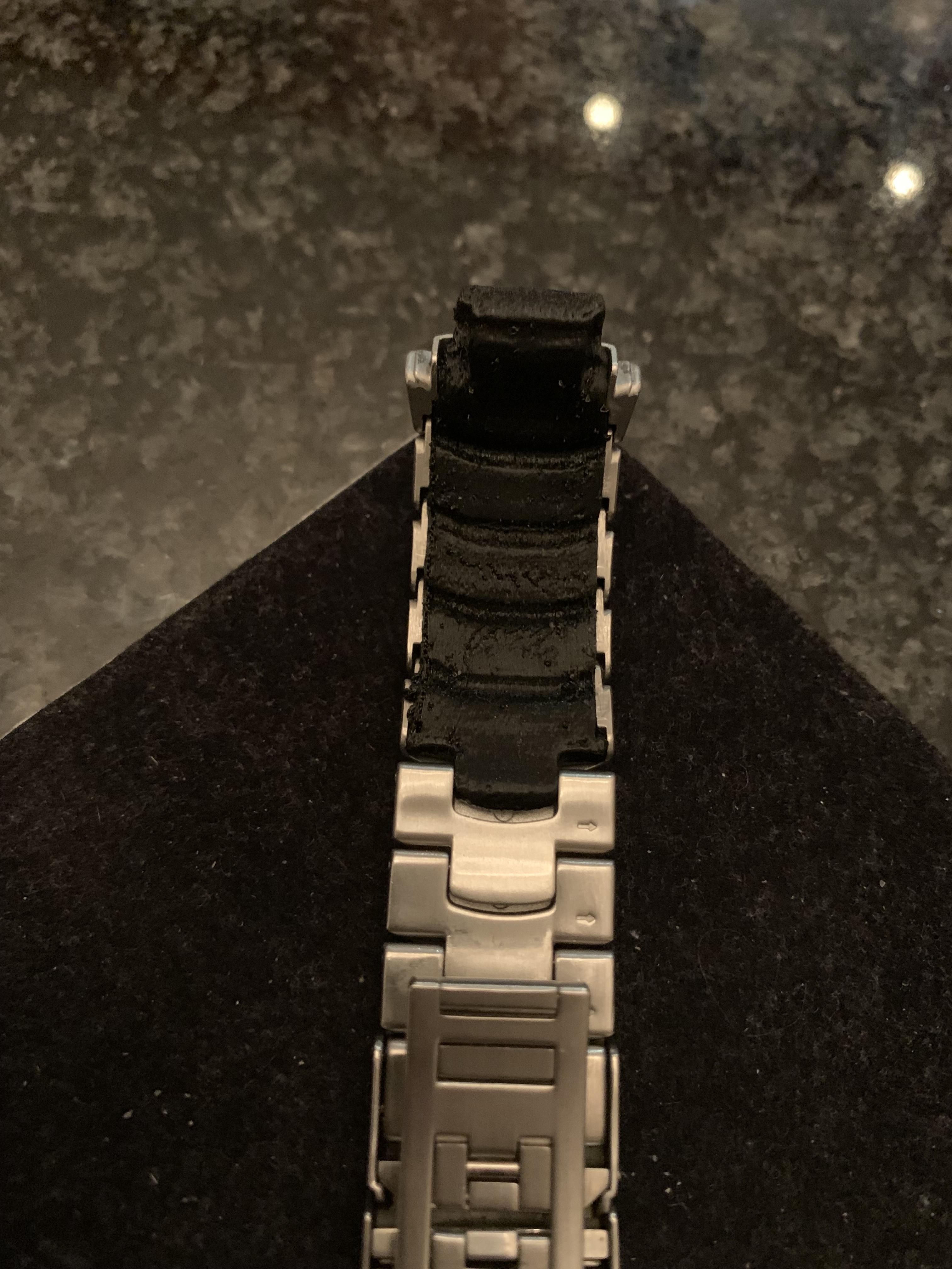

Hello WRT members in my last post I mentioned about maybe try doing 3m22-0d39 straps. I got a request for this model so gave it a try.
We kept the openings closed and we found out the strap would be much stronger. Gonna show you the result with the metal armor mounted on the strap.
I fixed 2 3m22’s on request.
A earlier project was a 5j22-0a70 with a broken rubber strap insert.
