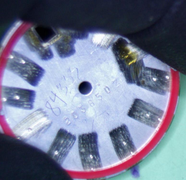

Okay, now I have a question. After installing the dial, I noticed the date wheel wasn't working. It worked without the dial, and I noticed there's this red plastic spacer ring under it.
The thing is, the date ring drags on the inside of the spacer. I checked the ring and it is symmetrical top and bottom--no ridges or rebates or anything.
I checked my disassembly photos, and it was just there stuck to the bottom of the dial when I took it off.

Have you replaced the date ring or is it still original?
You may have to try taking a bit off the inside of the ring as I think you'll struggle to find a replacement.
Thank you both. I just spoke with the owner and he verified that the watch worked when he put it in a drawer for several years, and the date wasn't working when he took it back out.

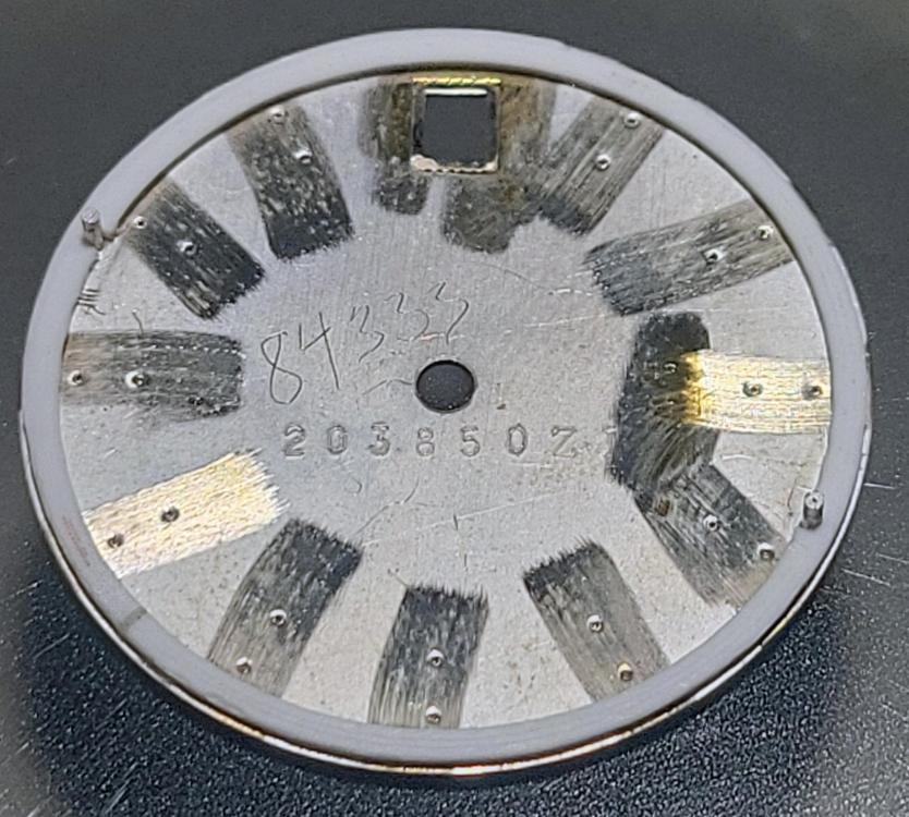

It is fickle for sure I put the spacer ring on the dial being careful to get the notches correct around the dial feet and carefully get the dial feet in the holes. If the dial is not seated correctly it will rub on the date ring.

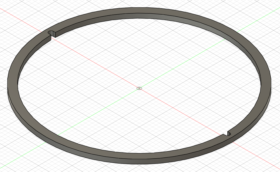

I decided to have a friend 3d print one. I tried sanding the inside, but it's very thin and flimsy, especially where the dial feet go through, so it was not easy.
Broke out the mic and dusted off my old CAD skills. Fingers crossed!
Okay, we got some good news and bad news.
My friend was able to print something very close. I very carefully cleaned the edges with an X-acto knife (you may notice the blood stain at 7 o'clock) and opened up the dial foot holes with a drill bit held in a pin vise. And what do you know, it worked perfectly.

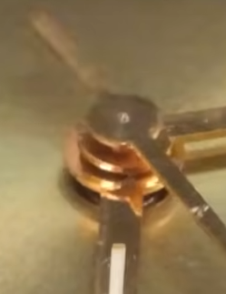

And now there's a new problem: the center seconds arbor. I can't seem to get the second hand pushed far enough onto the arbor because the pinion springs in when I push the hand onto it. This was the best I could do:
I did a little research and found Stian's 1000 video, where he notes:
Quote
When you press the seconds hand on there's nothing to hold the seconds pinion from being pushed back, unless of course you put on the bridge for the automatic module. Then that bridge will hold it back.
The movement is actually designed to put on the rotor first because the rotor post will actually press against the seconds pinion, but even without the rotor post in that hole the bridge will still hold the seconds pinion in place.
Quote at 21:01 here:
I do have the bridge and post installed. The only thing not installed is the rotor itself, but it fits over the post so it's not holding anything back.
Anyone have suggestions?

Same here, but it fouls on the inside of the crystal, so I'm assuming it should be a little deeper.
Looking at Stian's video, it does seem like it should go on a bit further, but his also springs in the same as mine, so maybe not?

Yes, just as in the video, with the retaining spring sitting on the sloped shoulder of the seconds arbor.
Okay, I adjusted the hands a bit and everything seems okay now. It sets a lot more easily than I'd expect, but I'm hoping that's just how this movement is. It's running in now.
