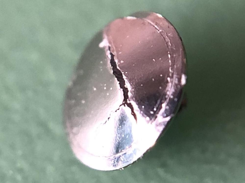

Now the watch is finally opened safely and correctly and I have made a first inspection. As expected, the rotor was so loose that it could not rotate. I have taken many pictures (more than needed I guess) and do not want to anticipate your reactions, comments, and observations but feel free to ask questions if you want something clarified or photographed.
The last four pictures in the series show the rotor after cleaning. I am very curious about your reactions, comments, and possible recommendations, especially from those of you with experiences with Rolex such as @Jon and @Knebo. Of course, comments from all of you are more than welcome!
This jewel is from the automatic device bridge. All the jewels on it look the same.
Edited by VWatchie
A design flaw Rolex refuse to let go of is the fixed axle, when others use bearings and because people listen to that chat about waiting for your watch to lose time, feeling stiff to wind, blah, blah... This is the obvious result of waiting for something to go wrong, which is a rotor turning without any lubrication which wears the axle to ridiculous proportions and takes the plating off the movement and rotor. If it is serviced often then this doesn't happen so often. The customer will give you a story with their watch, but the movement will always tell you the real story.
I usually replace the axle, and definitely when it is like this
Two things to watch out for, leave the calendar cam jumper spring in situ when cleaning and make sure you part the friction fitted cannon pinion that turns the date corrector. If it isn't taken apart, cleaned, lubricated, it will likely fail as a safety feature to stop damage if the quickset is engaged whilst close to midnight. Easily missed. Great movement to work on. Be careful not to mix screws up, as two are really similar and I've made that mistake. I think it was the crown wheel screw that is under the bridge, hence a normal right hand thread.
All that wear created a great abrasive dust throughout the whole movement which settles in where there was something to stick to, such as lubricant. Now that has dissipated it has left that abrasive dust to do its work. Hopefully the damage isn't too bad, but I reckon you'll have some pivots to polish at least.
Edited by Jon

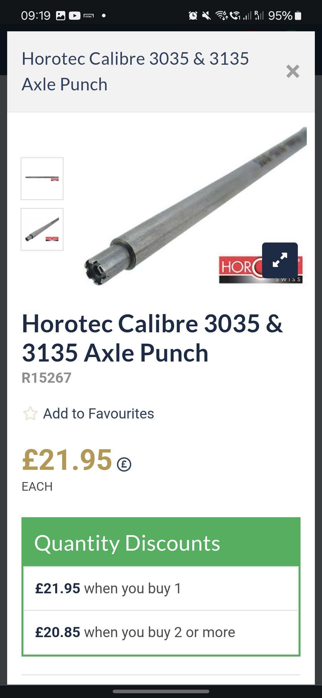

Something that I reacted to was the appearance of the riveting. When I look at my Horotec stake, the crown has six protruding sections that are driven into the axle. When I look at the worn-out axle it has 12. In the article that @Knebo refers to it says:
"The steel used in these axles is extremely hard and the
diameter of the rivet is large enough that it is quite difficult
to form a good rivet using traditional methods similar
to those used on a balance staff. Although I have seen
many who have tried."
Could it be that the wrong type of stake has been used or is it perhaps Rolex original? In addition, it looks to me as if the riveting was too hard (11th, 17th, and 21st image in my previous post) that it affected/damaged the rotor itself. Am I wrong?
Edited by VWatchie

Oh dear @VWatchie, that doesn't look good 🫣
Changing the rotor axle is obviously imperative.
I hope not all pivots are affected by this metal dust and that you can seve some/most of those that are affected. I think I recall seeing a video of yours where you looked like an absolute master on your Jacot lathe. So if anyone can save those pivots, it'll be you. Otherwise prepare for ridiculous prices for NOS parts.
I wonder if the jewels for the rotor axle are unaffected or need to be changed, too.
I don't have enough experience to really judge the axle rivet. But it looks correct to me. Probably original Rolex.
My Horotec punch for 3035 & 3135 also only has 6 segments. But I've just discovered that CousinsUK now also sells their own brand stakes for Rolex axles and that one has 12 segments.
Screenshot_20240623_091900_Chrome.thumb.jpg.6e8cc31d0c563ba8ffb87d0844f552f5.jpgScreenshot_20240623_091836_Chrome.thumb.jpg.5cf41fea1bc33351603967dd221590b3.jpg
I think you'll be ok with either.
This is why i prefer some mineral lubrication in a movement, when it gums up, i think of it like an auto service due indicator.
I agree! Synthetic oils are both a blessing and a curse.

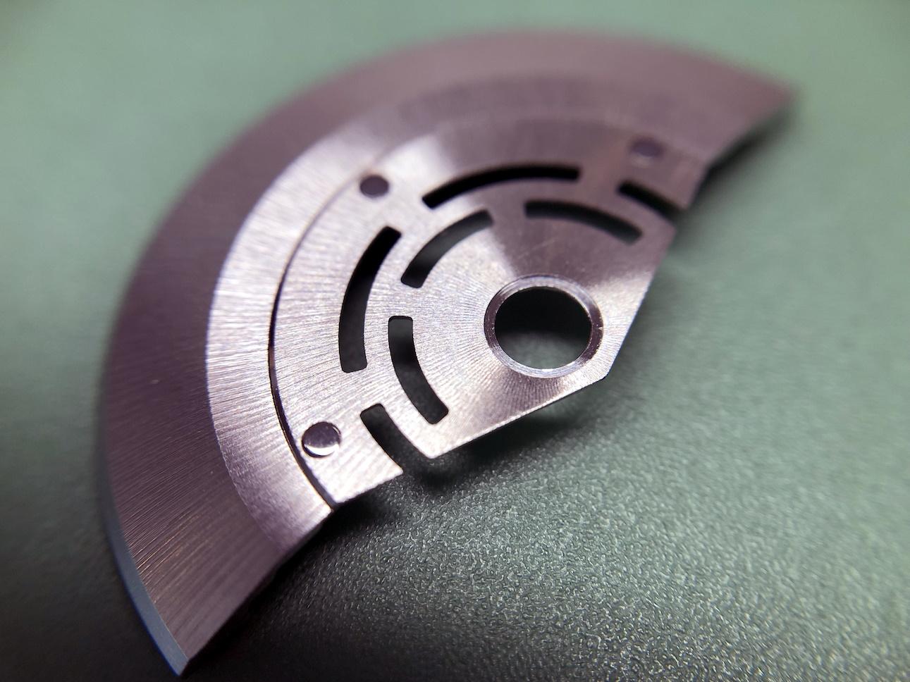

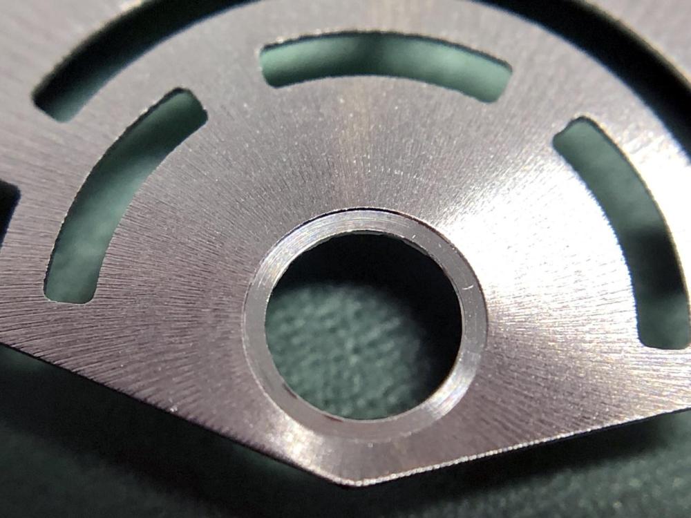

The first step is now complete. Hard to avoid "a slightly" elevated pulse before the first hammer blow but it may not be so strange when what is under the hammer can cost several hundreds to replace if something goes wrong. Repairing a Rolex by hitting it hard with a hammer feels unreal 😆
The operation appears to have been successful so far. The rotor looks completely intact without a trace of impact. I was worried that the decoration would be damaged or even worse that it would bend, but I now understand why the rotor is not at risk of damage. 100% of the energy from the hammer blow ends up on the rotor axle. I had hoped that the axle would come off after the first blow but I had to hit it three or four times, and really hard before the axle came off and the rotor jumped up a bit.
Now the next pulse-booster remains, to rivet the new axle. Wish me luck and shout if you see anything strange in the pictures. Now I'm going to have a cup of coffee with real cream and breathe out 🙂
That looks great, @VWatchie
When you insert the new axle (before riveting!), check if it holds in place by itself (i.e. a bit of friction). If it just falls out, it may be good to take a flat punch that just fits as indicated in the picture below and close the hole ever so slightly.
But before you actually do that, maybe @Jon can confirm/deny that this is a good idea.
I have just checked it and the axle does not stick when pressed into place. I estimate the play to be 1-2/100mm, i.e. very small. Nevertheless, I would assume it is good or even necessary to shrink the hole so that sufficient friction is achieved.
When you shrink the hole on a barrel bridge, you use two dome-shaped punches opposite each other and then open the hole using a smoothing broach. That works really great, but maybe it is a flat punch that should be used in this case!? I am still unsure of the practicality of it so all tips are welcome.

The rivet will do the job of holding the axle in place even with a small amount of play in the rotor, unless the hole is really sloppy.
11 hours ago, Knebo said:
Starting st 9.52, he starts talking about this issue and the flat punch he uses.
OK, so same video that you linked to previously. I missed that part so I'll take a look again. Thank you very much!
OK, thanks! Since the play is far from really sloppy, I think I'll simply try to hit the axle without trying to reduce the hole first. Should I use my steel hammer (55 grams) or do you think I should hit it with my newly purchased brass hammer (84 grams)?
The head of the brass hammer is bigger and heavier than the steel hammer and that will make it easier to hit the right spot. Also, I'm hoping that the brass can protect the axle/rotor if I hit too hard. I don't mind if I get a deep gash in my hammerhead. Or, the brass is simply too soft for this job, yes? I have no experience with brass hammers so I find it difficult to make a judgment on my own.
Use a hammer you feel comfortable and are used to using. It has to be suitably heavy enough though. I find a watchmaker hammer with a 25 - 30 g head is way too light in weight, so I use a brass hammer. in a job like this I like a heavier hammer and reduce the weight of the blow on the stake, because all the action is in the wrist, rather than a hammer that is slightly too light and you end up hitting it much harder with less control.
I don't think you realise how hard this has to be hit, but you have to be careful going over the top and destroying the axle and damaging the rotor in the process.
