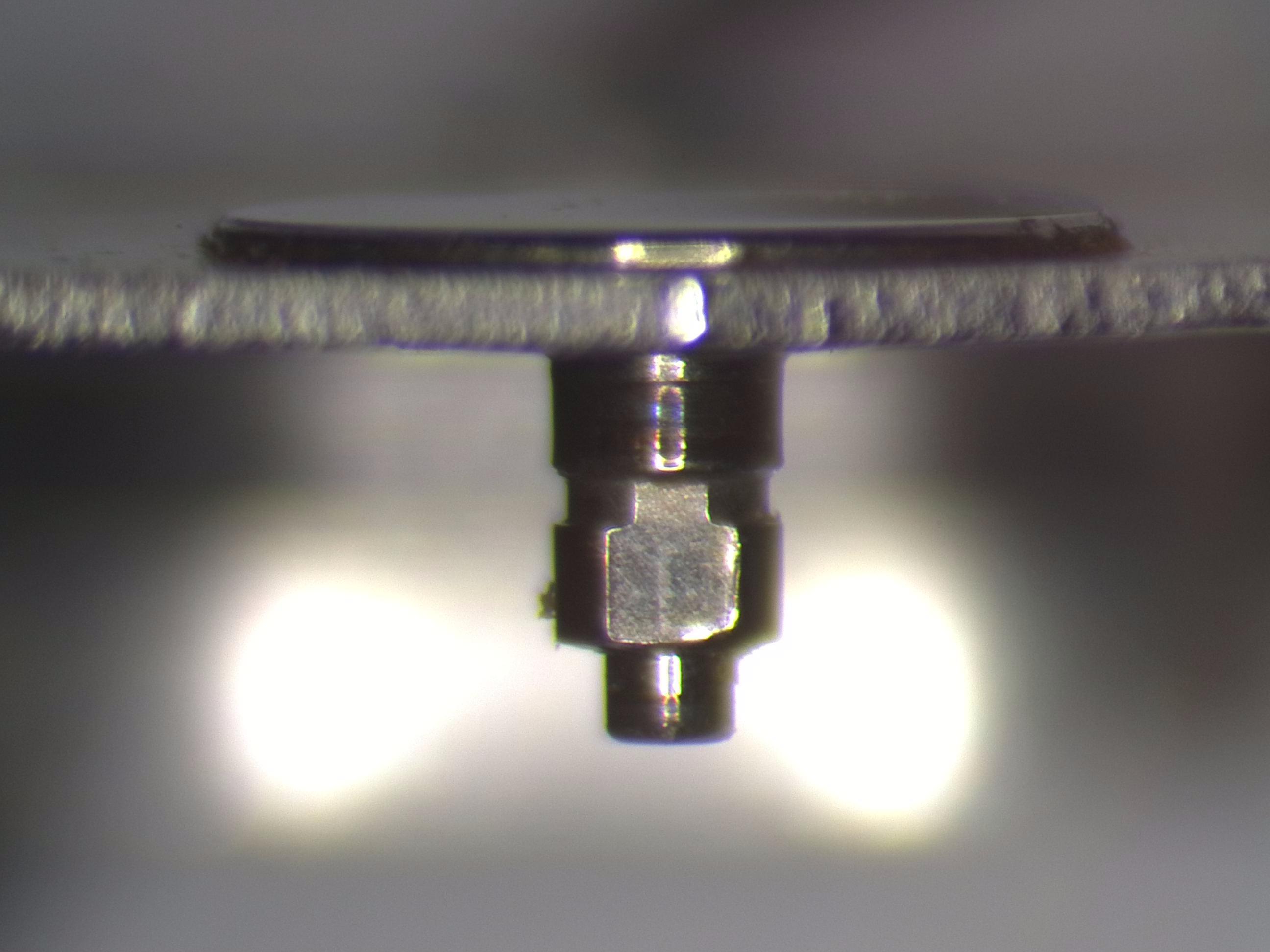

On 5/28/2024 at 4:26 PM, Knebo said:
make sure you know how to deal with the reversing wheels (Epilame..)
As I understand it, but please let me know if I'm wrong, the two reversing wheels should be treated with Fixodrop and then only the side of the arbor should be oiled. Correct?
Yes, Fixodrop and then only a tiny amount of HP130p on the arbor as shown below.
This is my one main concern about Mark's video (and I can't believe I'm saying this in HIS forum 😅😞 he also applies a bit of oil on the clicks which os clearly not what Rolex suggests. While he probably knows what he's doing and is maybe so precise that the oil will forever stay on the vertical surface of the click (and never travel between the steel wheel and the purple surface)... but it's certainly not necessary and a risk I'd avoid.

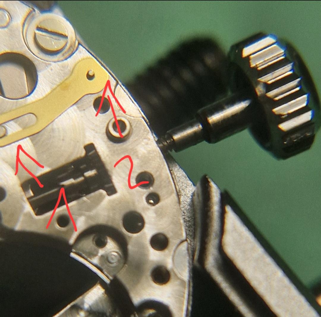

15 hours ago, VWatchie said:
I'll be honest, I don't really understand the risk. Can you elaborate? Maybe this part is very thin and fragile?
Yes, not obvious.
The hack spring does have a groove on the mainplate. So it's correct positioning relies on two pins/posts. One of which is only there of you have previously already assembled the keyless works (which Mark does afterwards).
If you don't previously assemble the keyless works (to get the second pin), you need to position the hack spring careful and also watch out not to move it too much in the process of putting the bridge. Otherwise there's a risk of flattening/breaking the tip that is supposed to touch the balance.
Later, when assembling the keyless works, you also have to be careful that the pin from the setting setting lever goes into the hole of the hack spring and does damage it.
In sum, I feel that it may be better to assemble the keyless works first! Avoids both risks in this regard...  I did it that way and it didn't cause my any other problems.
But Mark and Rolex manual suggest doing the train side first...

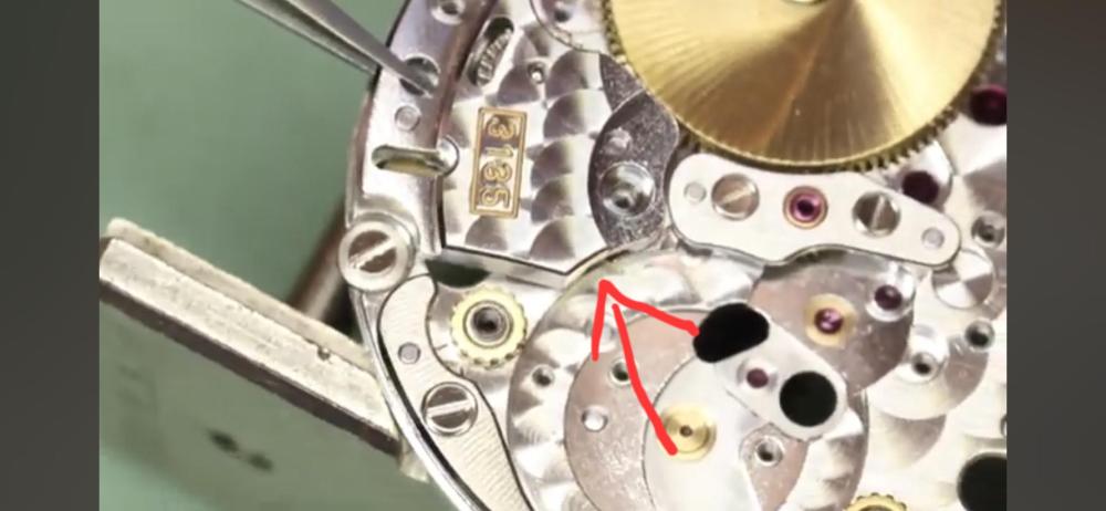

These pictures from the first two seconds of Mark's second video in the series.
You see, only one post for positioning of the hack. But he knows what he's doing, of course. And the tip of the hack spring (arrow on last pic) doesn't get squeezed between mainplate and bridge.
Screenshot_20240627_093609_YouTube.thumb.jpg.bf5c64c8c2eb8c78f8f9bb015fea46f3.jpgScreenshot_20240627_093621_YouTube.thumb.jpg.4f316e47c63ef65bd09e51bd847feaf8.jpgScreenshot_20240627_093639_YouTube.thumb.jpg.fc3a527f4ae7fae676f52c1a228e604c.jpg
And from my own pictures:
- without keyless works:
- with keyless works:Screenshot_20240627_093410_Gallery.thumb.jpg.61df094fdfcc573cfca2ec93a05f2f9b.jpg

The left handed screw on the date driving wheel has a special screwdriver head to fit, so beware. it can be undone with a screwdriver, but careful not to slip!
The date driving wheel needs to have pressure of the jewel that is on the arm pushed against the cam under the driving wheel taken off.
When the left handed screw is removed, take the tension off the spring shown with a blue arrow, then remove the driving wheel and release the tension.
When it comes to service manual for any watch movements, if you know why you use a lubricant in a certain situation, then I wouldn't pay too much attention to them. I certainly don't as I don't believe in most assembly order, or what lubrication.
Reversing wheels don't get lubricated with 9010, maybe several decades ago, they are lubricated with  HP1300, as all modern automatic watches are. I know I'm opening a can of worms here! Old service manuals will say to use 9010, but we don't do it like that anymore.
I always start with the gear train or barrel, never the keyless work, as the clutch and winding pinion have to be held in mid air to pass the winding stem through them.
Once the calendar plate is removed, you'll see the jewel hard against the calendar driving wheel post.
This pic doesn't have the jewel in situ, but I have highlighted where the jewel will be. Take a little tension off the spring and rodico the jewel off.
Keep that spring in situ when cleaning. It is might break if you remove and replace it.

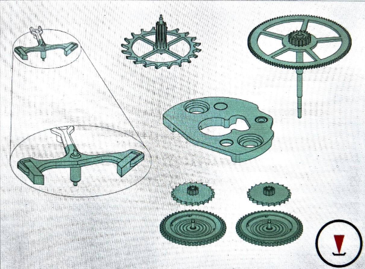

When it comes to epilame on a modern Rolex, these are the parts to do in the picture. Don't oil any teeth on the reversing wheels. The risk of oil migrating between the teeth and the red disk is big and will jam the reversing wheels eventually, so nothing is used, except HP 1300 on the arbors

The pivots of the pallet fork? Or do they mention cleaning off the epilame afterwards (also escape wheel pivots)?
The Rolex manual that I managed to find only refers to the pallet jewels to be treated.

The Rolex service manual pic was from an up to date service manual, so what you see is epilamed. Personally, I dip the pallet jewels in so the pivots don't get any epilame, but I don't worry about the escape wheel pivots. I know it's fine, by opening up automatic watches I serviced five years ago and not seeing any brown dust around the escape wheel pivots or any problems in their timing, amplitude or general running.
I'll also continue doing that out of precaution and habit...
...but this is definitely good to know!

This is my one main concern about Mark's video (and I can't believe I'm saying this in HIS forum 😅😞 he also applies a bit of oil on the clicks which is clearly not what Rolex suggests.
I don't think you have to worry one bit about Mark. As you say, I'm sure he knows what he is doing and why. Anyway, since he doesn't disclose the reason for oiling the clicks I will follow Rolex's recommendation. Speaking of Mark's YouTube channel I must say it's still one of the best, if not the best. I'd love to see more videos from him.
This is a valuable tip, although I believe this is for a different Rolex calibre (not the 3135). Can you recall which one?
Yes, that must be the safest way to do it! Mark uses a pair of tweezers to remove the jewel and you can see how difficult it is as the tolerance between the jewel hole and the post for the jewel on the yoke for the cam is minimal.
Do you keep the cam yoke (being pressed by the spring) in situ too?
3035
Yes, keep it in situ. For some reason I thought you were working on a 3035.
Here's a pic of a 3135 spring in situ. Push the spring out of the way which allows the date driving wheel to be removed and the tension taken off the side of the arm with the jewel on the end.
You can see the hole in the stop lever which the setting lever goes into. Dead easy to line up!

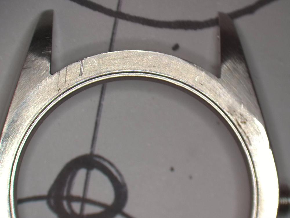

The last pic is the carnage that someone inflicted on the case trying to get the bezel off! Jeez! That is one deep groove!
Even one of the bridges had the part number scratched into it. Classy!
  • Sad 1
Words like ignorance, impatience, and greed come to mind.

I made a very quick video of changing the axle from a Rolex 1570. When I've got more time I'll make a better one with commentary to put on my YouTube channel.
Here's the link to my cloud where you'll find pics and vids https://drive.google.com/drive/folders/1uo47kyawtE-nTPkc9gVr9Z_I261oX-PR?usp=sharing
The trick is, when you have the axle in place in the rotor and it isn't a tight fit holding it in place you have to make sure when you are holding the rotor on the stump that the rotor isn't angled down in any direction, because the axle will rivet in at an angle which could really damage the rotor and ruin the axle.
Also, you'll notice the original rivet had twice as many rivet marks; the generic punches only have six. Don't worry about that, they work fine.
You have to hit the riveting stake sufficiently hard enough to rivet the axle in place, but not so hard you'll crack the top of the axle, which is easily done.
This pic is a worn axle. Compare the pic to the next one of a new axlewornaxle.thumb.jpg.45a443272a61ecd858a1a6d4f100c5ee.jpg
Here's the new axle
This is the new axle rivetted in place. Notice only six rivet marks
  • Thanks 2
