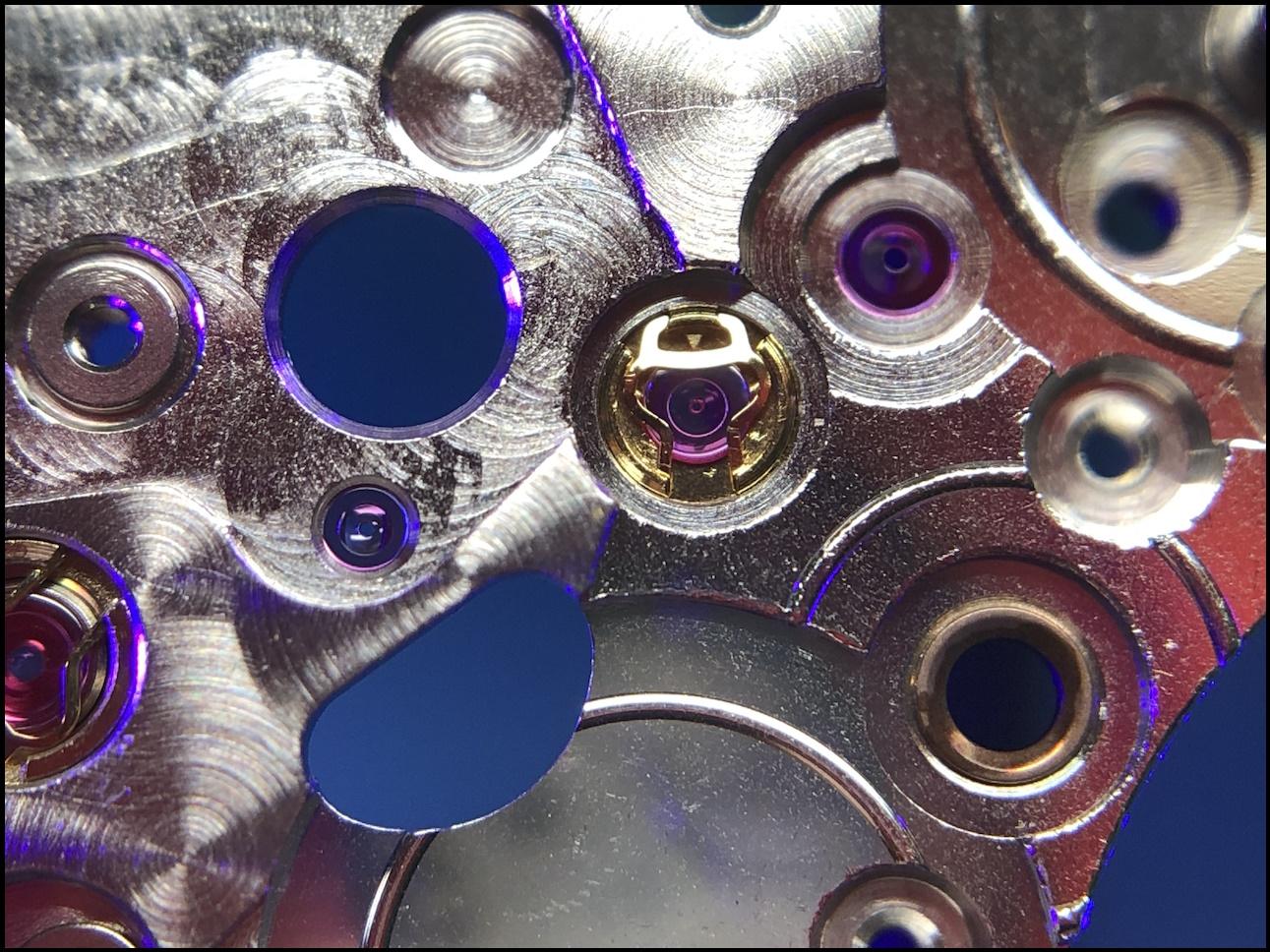

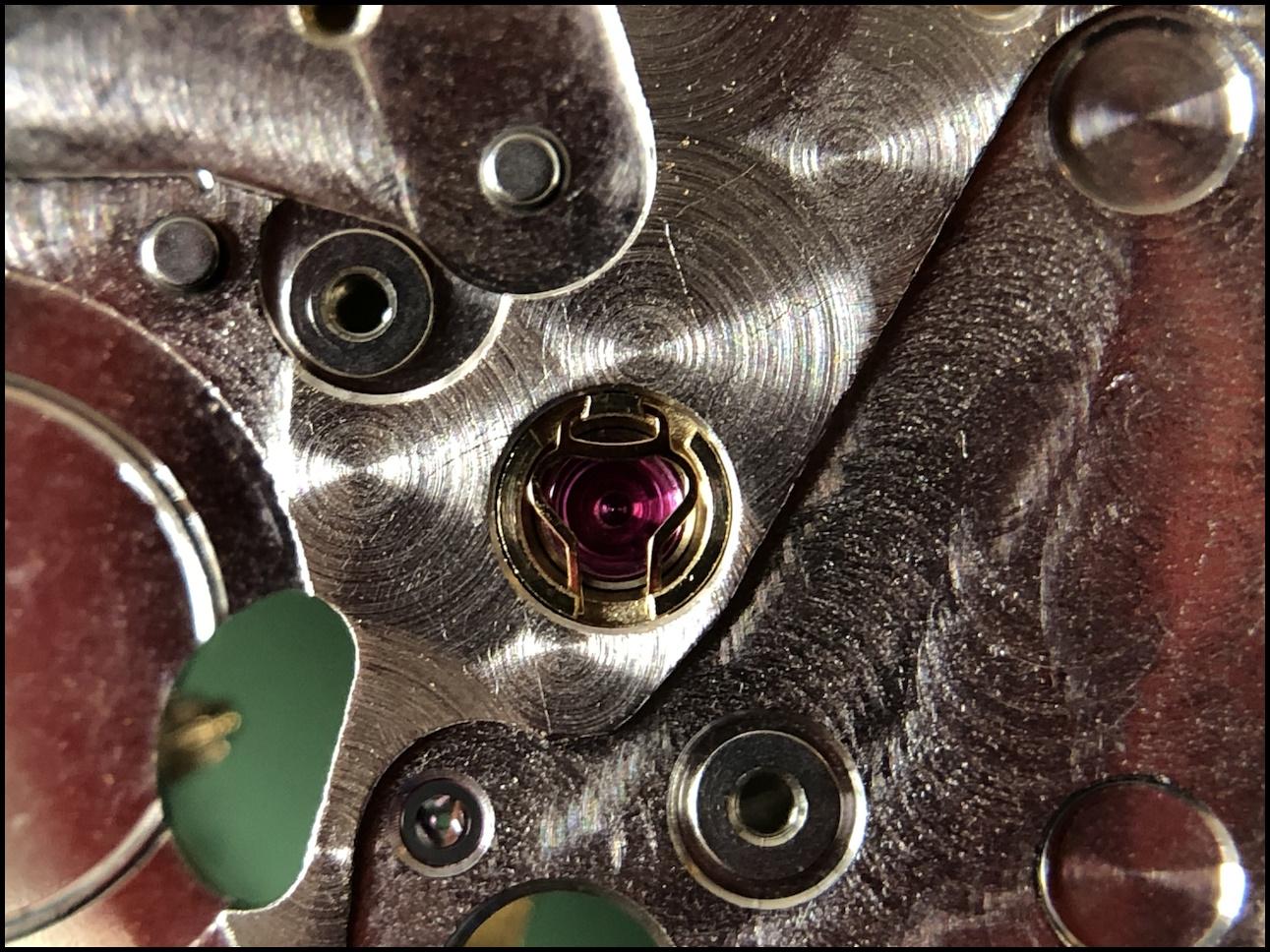

Here is an update for those of you who are interested. Yesterday I tried to oil the anti-shock system but failed miserably. I tried between five and ten times. It was not a pleasant experience. I got it somewhat right but far from acceptable so I gave up. I took a long walk to relieve the pressure and felt defeated, not to say failed 😟
After a good night's sleep, I looked through my stereomicroscope (40X) in the morning (having a day off) and realised that it was even worse than I had allowed myself to accept yesterday. However, filled with new energy, I removed the cap jewels and chatons, cleaned them in Horosolv and rinsed them in IPA.
What I had failed to do over and over again was to place the chaton perfectly on the cap jewel, causing the oil to end up sticking on the chaton and spread out. The margin between the cap jewel and the chaton is almost non-existent, so if you fail to lower the chaton perfectly, you're screwed. This is in line with the precise fit between the parts of a Rolex watch but in this case, it was no help. It probably works if you have an extremely steady hand and practice long enough but you shouldn't wobble more than a few hundredth of a millimetre.
I then remembered that I had an automatic oiler (Bergeon Automatic Oiler 1A) that I had not used for several years because I learned to oil cap jewels manually with good precision. When you lower the chaton towards a cap jewel on the IncaBloc, the margin between the cap jewel and the chaton is wider so you do not need to be as precise.
By lubricating using the automatic oiler I got a satisfactory result. Maybe it was a tad too much oil but I still feel very satisfied. I don't think there is much risk of the oil spreading if the movement is subjected to severe trauma, which is why you want to avoid too much oil. Too little oil would shorten the service interval. Now that I look at the pictures again I think the amount of oil looks more or less perfect! 🙂
When everything was done, I tested the free oscillation of the balance in all positions (apologies for the background music that I did not think of) and if I may say it myself, it looks wonderful 🥰

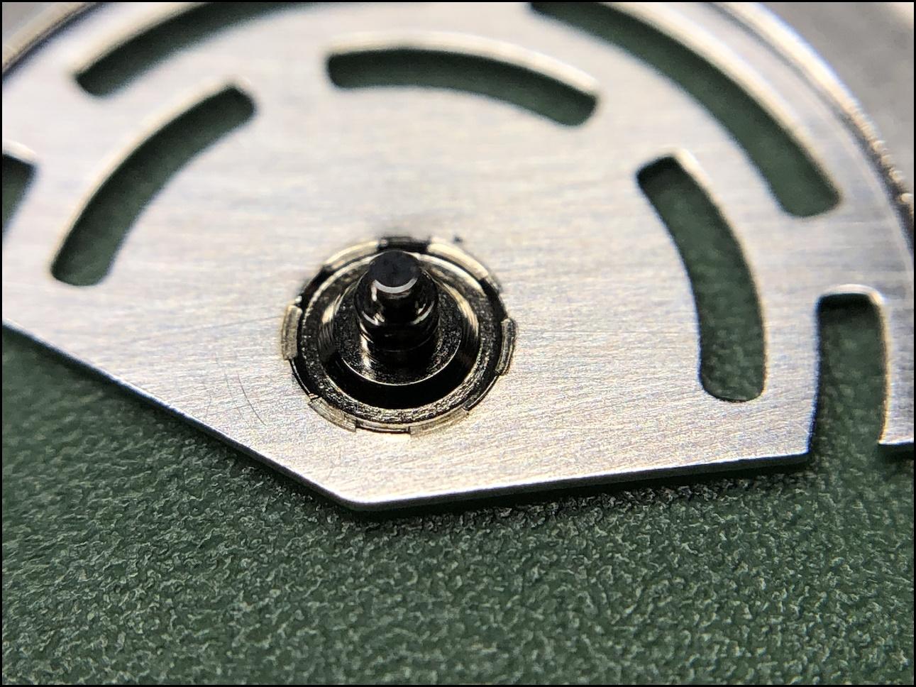

So, my watch repair friends, the agony is over. The new axle has been riveted! As I lifted the brass hammer to whack the punch, @Jon's words suddenly came to mind: "I'm sure you will ace it. What you believe, you become!"
I haven't yet had a chance to test it, but as far as I can tell it looks good. Thanks for the practical advice, explanations, videos, articles, and encouragement. Invaluable! 🙂👍

Did you have to give it a decent whack as suggested?
It does look good.
Yes, indeed! I’m pretty sure I used a bit too much force but was saved by my newly acquired brass hammer. The next time I know I can use a bit less force.
I should have bought two axles. One for practice (without the rotor attached) and one for the actual job. I do recommend getting two axles because it is difficult to assess the force needed when you’ve never had the chance to try it.

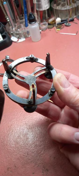

I assembled the automatic works this afternoon and although I haven't mounted it and tested it on the watch I expect it to work perfectly. I can't feel any shake spinning the rotor. Of course, there is some shake (or it wouldn't spin), but it appears minimal (as it should) and within the specifications so I feel pleased about that. Given how extremely loose the rotor was before I started the repair, I was worried that other parts, besides the axle, would be damaged, but that fear has been put to rest.
There is not much remaining before I can return it to the owner!

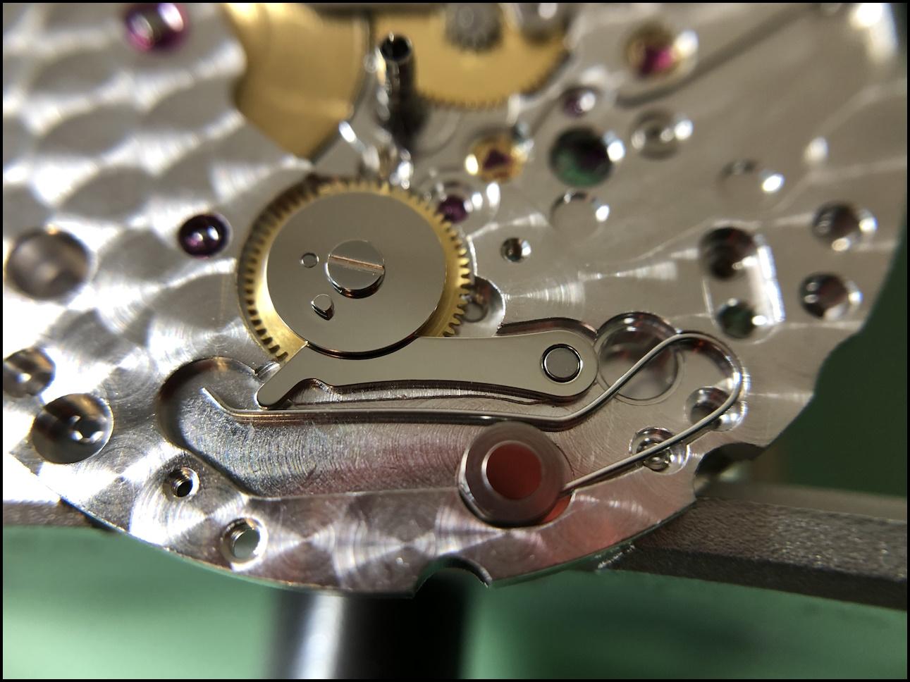

What I found very interesting is that the Rolex  2135, i.e. a calibre from the same generation of movements, implements the same date mechanism in a more watchmaker-friendly way:
As you can see, yoke and spring are secured by a screw each. So you can just take care of that first, then add the jewel and snail cam (then the wheel, not pictured). I think it reduces the stress of multi-tasking.
Indeed, and thanks for sharing the picture. It makes me wonder why the 3135 calibre isn't designed similarly. Perhaps the 2135 is a newer movement!?
