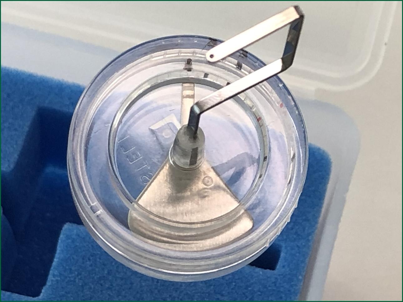

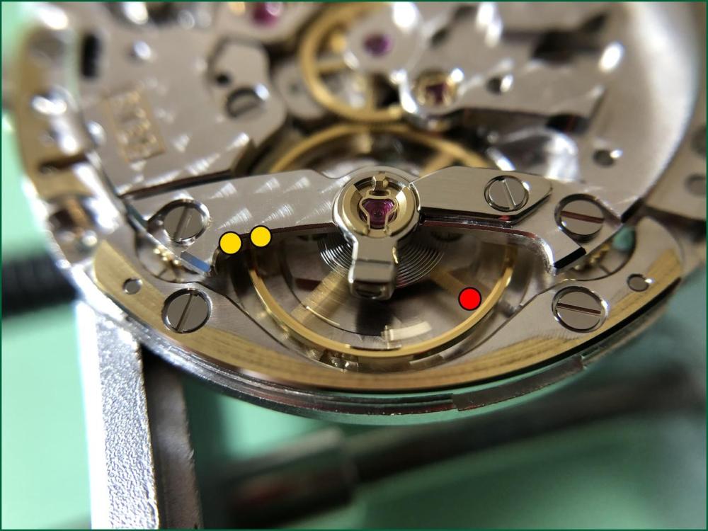

Yesterday I regulated the rate using my newly acquired Microstella tool. What I feared could become a difficult and gruelling experience turned out to be very pleasant. When I finished, I reflected on how much easier it would be if all movements were regulated similarly to this Rolex calibre 3135. It turned out to be not only quite simple but also very precise.
@Jon's tips and video as well as @Endeavor's and @Mark's tips (links in previous posts) were very useful. I don't have a tripod for my phone so I can show how I held my hands but at least the picture shows my setup except for the watch itself which is a junk watch as the Rolex watch is currently spinning on my Cyklomat.
I am right-handed so I held the tweezers with my left hand which could rest safely on the wooden box and handled the Microstella tool with my right hand which could rest safely on the work bench. The advantage of this type of small (and inexpensive) case holder as seen in the picture is that the Cyclops eye above the date display is in a cavity in the holder which means that the watch case wont tilt.
In general, I think it's easier to regulate the rate while the movement is on a movement holder as seen in Jon's video, but I still decided to do the adjustment with the movement mounted in the case, and since Rolex advertises the Microstella tool this way I wasn't too hesitant.
By letting the inside of the tweezers rest against the balance bridge (the yellow dots), as Endeavor describes, I got good stability and could grip the rim of the balance wheel without the risk of accidentally moving the tweezers sideways, lengthwise, or vertically. After that, it was no problem to place the tool over the Microstella screw (the red dot) and rotate.
Following Rolex's instructions, I stopped the balance wheel by pulling the crown out to its extreme position and then carefully rotating the balance wheel until the first of the two screws needing adjustment was aligned with the most convenient way to hold the Microstella tool in relation to the screw. What I didn't realise, which scared me a bit in retrospect, was that the impulse pin could have caught on the outside of the fork horn as I rotated the balance wheel. I guess you can probably feel if that would happen, but I think you need to be a little observant of this which is why I mention it.
The tool itself I bought at Cousins. It is a rather expensive Korean clone of the original Rolex tool and works well but does not give a feeling of really high quality. What is critical is that the fit with the Microstella screws is precise and there is nothing to complain about.
Something to complain about is the weight on the inside of the tool which is supposed to always hang vertically and indicate how much you have rotated the tool. On my copy, the weight rotates so slowly that it almost loses its function. Perhaps I got a Friday afternoon model but maybe it can be adjusted. To compensate, I made marks with a permanent marker on the wheel to make it easier to see how far I should rotate it. It worked well.
When rotating the Microstella tool, you must try to keep an eye on both the screw and the tool. There is a risk of focusing only on the tool and slipping off the screw, thinking that you are still rotating the screw but in reality, you are only rotating the tool. The screws are seated with relatively high friction (as Jon mentioned) but because we are working in a microscopic environment, there is still a risk that you do not notice that you have slipped off the screw while rotating the tool.
So, that sums up what proved to be a pleasant experience. The current rate while the watch is spinning on my Cyklomat is +1.6 seconds/day so I think I'm done, and I'm pretty sure I didn't upset the poise. I'll do some measuring on PCTM a bit later.

The final challenge was to regulate the rate with the Microstella tool as described in my previous post, which I did in two rounds, most recently yesterday. Here are the final results measured with PCTM. Each measurement is averaged over three minutes.
It is very satisfying to see that all values and performance tests, including the rate, are now well within Rolex's specified limits.
