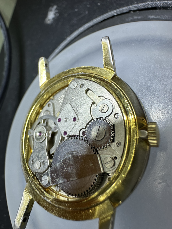

Slippage when winding
I have seen a few posts with similar questions but the suggestions don't match what I am seeing.
When I wind the watch with the crown it winds a little and then all of a sudden slips often releasing all the power.
I can't seem to identify why. With the case back off I see nothing move when the watch slips.  The crown wheel stays meshed with the ratchet wheel - the crown, in-between my fingers does not slip.
While winding I do not see any slippage between the winding pinion and the crown wheel - the teeth look OK...
I can wind the watch all the way up to full wind by manually pushing the ratchet wheel around with my brass tweezers.  From this I believe I can rule out that the issue is with the arbour / hook / bridle...
But if it is none of these then what could be going on?

It would've been helpful to give us a watch model number? Usually slippage like this would be the mainspring and the mainspring is usually in a barrel which means you can't see anything.

The watch has an EB 8800 movement - here is a nice close up...
It could, in fact, be a broken bridle. If the bridle has snapped off there would still be sufficient friction to allow the spring to wind ... to a point. Once the point where the spring tension overcomes the friction it would tend to release completely rather than incrementally.

I was afraid of something like this and yes the pictures helpful for those that have never seen one of these. The problem with a watch like this made at a bargain price and they do things a little bit differently.

It's possible the mainspring is slipping on the other side farther into the watch. As I said these are made differently cheaper than a standard watch and we probably need a better image of the mainspring barrel itself. Like for instance you notice the upper pivot well if you do you're seeing things as there is no upper pivot. So another words is a strap holding the barrel in place and it's definitely made differently than the standard watch. Which means conceivably it slipping on the other side as things have worn out and you may not be a loose see that on the other side.
One of the annoying problems with technical information that you download is conveniently when it was scanned the technical was not because they just wanted the parts lists. So we can see that the mainspring barrel in this case doesn't have an arbor. In other words it goes together a little bit differently than a standard watch and it's possible that it still has defect and is slipping somewhere in here.

Thanks for the input - but I don't think this is the case either. I have inspected the spring and it looked fine with the bridle locked against the ridge on the barrel wall.  And as I said, I did manage to put a full wind on it using my tweezers without any slipping.

I have just taken the watch back out of the case and removed the dial to see if I can see better.
Strangely I was able to wind it  a few times without slipping when it was out of the case .  But when I try to release the power on the mainspring by holding back the click and slowly letting the crown turn, it slips.
Problem Solved!!!
I went through my bag of "Watches I never wish I had bought / bid on" and found another watch with an EB 8800 (a 1 jewel version with a bent hairspring) and decided to swap parts until it worked.
After trying the mainspring barrel I tried swapping the winding and sliding pinion - turns out it was the winding pinion.  It was very hard to see on the inspection. The breguet teeth on the winding and sliding pinions are very shallow on this movement and didn't look obviously broken.  At 22x mag under the microscope you can see they are worn - but I missed it at the 10x.

Well, what is written here can't be explained with the wear of the winding/sliding pinion. Probably it is some kind of delusion from You side. But it prevented the people from pointing the reason of what is happening. Otherwice, this kind of wear is one of the common problems of winding works in watch movements. It meets often in old or cheap movements, or particulary in negative stem system pocket movements where not proper adjustment of the sleeve that guides the stem is done.

I too thought that a slip between the winding and sliding pinion would not cause the mainspring to release its power.
Here is my hypothesis as to what is going on:
The watch has an EB 8800 movement (pin pallet - no pallet stones) where the barrel lid doubles as the barrel arbour.
When the winding pinion slips a shock of pressure goes through the crown wheel and is transferred to the ratchet wheel.  This shock lifts the lid of the barrel and that causes the mainspring to slip inside the barrel (possibly at the hook end)

Lol yeah not a great movement then.  I think the arbor is pressed onto the lid on those. I seem to remember quite a big clumsy looking thing and awkward to get in position. So maybe the arbor hook is not catching the mainspring eye deeply enough, other shocks might also cause a release .
