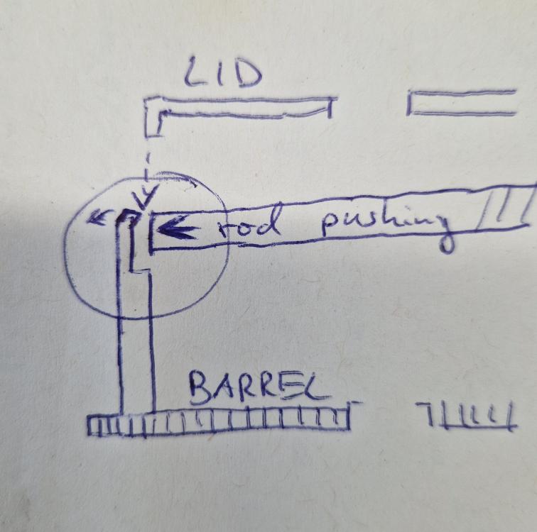

I use a 3mm carbide rod with a crisp flat face (steel is fine too), and, holding the barrel vertically, under the microscope, teeth resting on a hockey puck, I carefully slide the rod along the part of the barrel that clips to the lid, pressing quite hard to deform the metal back out. If you don't do this, when you go to press the lid on it will catch, causing damage to the lid and barrel, often with no feasible repair. It's actually ok to tilt the rod a little after getting the lip straightened, to form a slight bevel around the perimeter to facilitate the lid going back in.
It's not a fun job to do.
Thanks for taking the time to describe this.
I this what how I should imagine it?
Swing the rod 90 degrees, it's the side that does the work. If you have a lathe you can grab the barrel in a wheel chuck and hold the bar in the slide rest, turn the headstock by hand while applying pressure- much less awkward than holding the barrel by hand.

@nickelsilver gave an excellent explanation how to manipulate the barrel with rod once opened to facilitate closing it again without damage.
Thank you @Jon and @nickelsilver again.
I took the plunge and opened it.
It came off with no problems at all. However, upon close inspection, I could see the "lip"/burnishing. So I followed @nickelsilver's advice and tried to gently bend the metal back out. I used a bracelet tool for it... and quite frankly, I'm very happy with the result.
I tested my success by reinstalling the lid. Went back in smoothly. And off again.
I guess when I install the new mainspring and the lid, I'll try to burnish the edge of the barrel back towards the lid.
