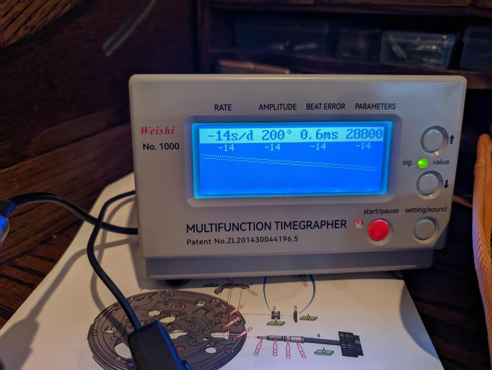

I will post a pic or video of the time grapher when I get off work. When I first bought this watch it ran "ok" +8seconds/day for probably 6 weeks. Then it stopped suddenly at night tapping, shaking, manipulation of the crown wouldn't change anything. After that I started on a service and as soon as I had the crown out and the movement holder screws out it started again so I stopped the service and put every back. It worked well again for another few weeks and then it stopped (I knew it was going to as I hadn't done anything to fix it in the first place) again. So I did a full cleaning and service. It worked again for probably another month after that at +4 seconds/day and then stopped again. Beat error was never higher than .3ms either time I tested it. So I took it apart again and started to assemble. During installation of the sliding pinion I was checking to see if the operation of the hack was functional and noticed that the balance didn't not start again on its own. I will post a video of the time grapher as the movement stands tonight when I get off work.

Are those the highest amplitude value you get with the movement? If so it's deffinitely a problem cause I would expect atleast 280+ amplitude horizontal positions fully wound. Usually I get 300+ amplitude easily with modern ETA or Sellita. The hack wouldn't be a reason for low amplitude.

Ok the time grapher for a few positions is as follows.
Dial down first
Dial up second
Crown up third
Crown down fourth

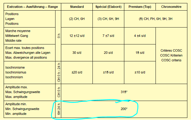

you dropped off a specification like the watch was fully wound up or its 24 hours later? So dial-up and dial down should be as close to identical as possible you have 221 and 215 maybe it's okay but it seems like they should be a little closer. Then as soon as you go to the crown positions dropping below 200.this is definitely a problem watch companies don't care about the maximum amplitude sort of in not supposed to go above 315° on this watch but at the end of 24 hours in the 6H  which is basically the 6 o'clock is up at the end of 24 hours it cannot go below 200° and basically all of your crown positions are unacceptable. Here is what the specifications are
you will note that watch companies do not get obsessed with amplitudes like they do in this group. They only get obsessed with amplitudes at 24 hours for which this watch is unacceptable. although I'm assuming and I hate to do that that this watch is probably fully wound up and it 24 hours probably a miracle if the watch runs at all.

As others have said, amplitude is way too low (assuming this is at full wind). You need to deduct another 10° or so because of the wrong lift angle (as John said, it's 50, not 52). I would rather think that the overall movement needs a full service. I'm less convinced by the hack spring (and setting lever) hypothesis. But it's worth a try to reassemble without the hack spring. Why not.
