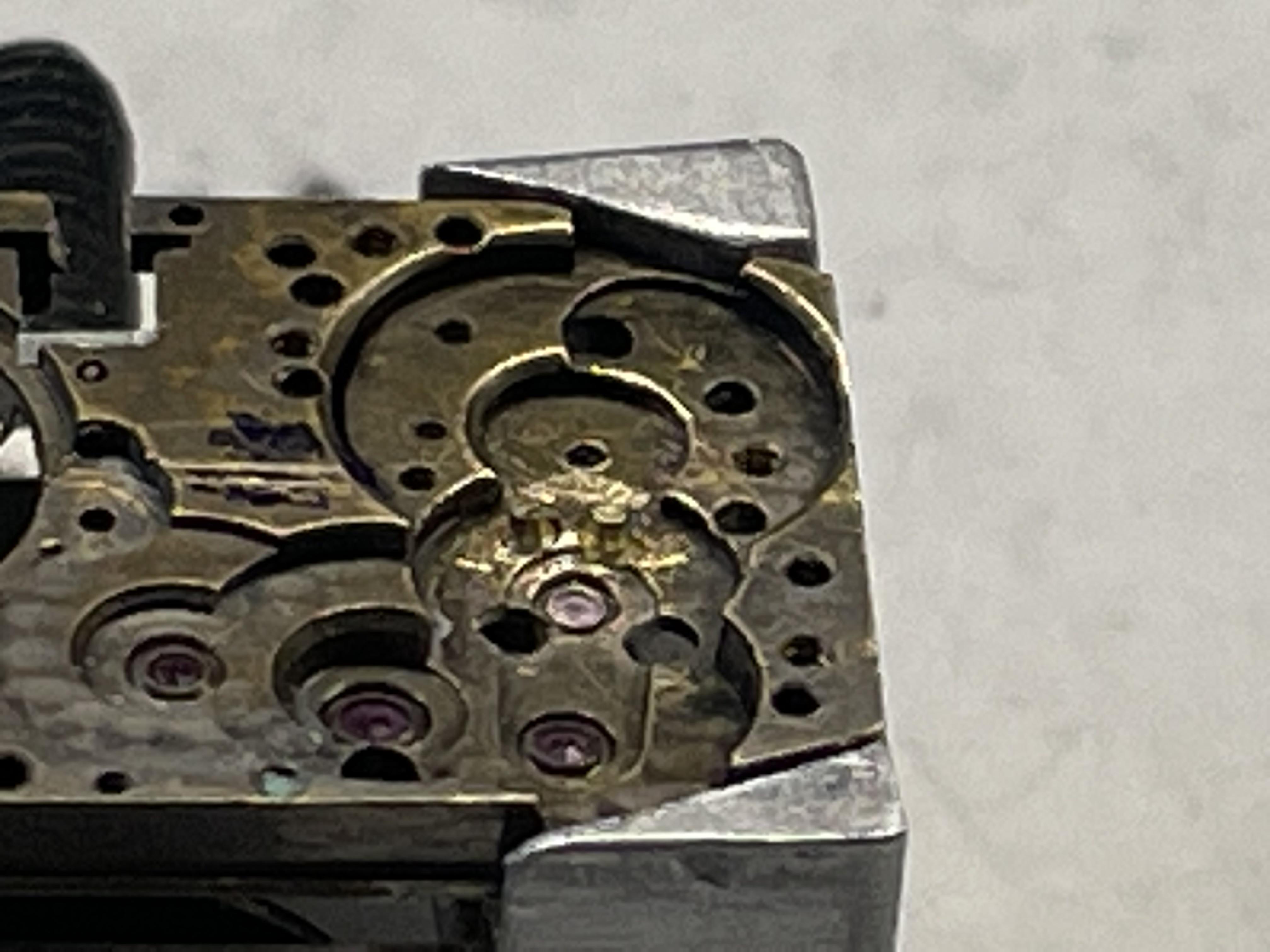

Having trouble installing pallet fork on my vintage Pandow movement. can't seem to get the lower pivot in place to install the pallet fork cock.  Would it be easier to remove the  escape wheel and then try to install the pallet fork??  Then reinstall escapement.
Lower pivot is present and lower jewel appears to be open but can not install pivot into the jewel.

Has the pallet fork been previously fitted to know that the pivot definitely fits in the jewel hole.

Yes the watch was completely assembled when I received it. My wife's grandmothers watch. I had to replace the banking pins but the lower jewel seems OK. See photo.

Upon further inspection  (10 power loup) I found that there  was a slight bend in the frame there the lower jewel was fitted. Very thin brass do to all the metal removal to make room  for the parts. I must have done that then I pressed in the new banking pins.  In the process in flatting out the area. Reinstall the jewel and see where I stand.

Hi dave, what was the reason for replacing the banking pins ?
7FD735FD-3F9E-4CDE-B332-8F074EC037ED.thumb.jpeg.7a7e3cfe357be739a7b05098c1ce6df7.jpegneverenough,
In taking the watch apart I noticed one banking pin was bent. I tried to straighten and it broke. Measured the best I could and made new ones. Had to rebore so I did both pins. It took me a few attempts (and critized for poor workmanship). Redid the work and it turned much better. Attached photo.
In the mean time I noticed that indeed the lower pivot was broken off.  Now looking for new balance fork.  I might be able to replace the shaft.

The pins may have been bent on purpose. Altering banking pins opens a (very large) can of worms. Setting them  correctly takes some effort, and reading up on what is required, as you will find if you search the forum.

Ok so banking pins are not always perfectly straight and it may have been set this way on purpose, possibly even at the factory. There are various checks to be made before attempting any straightening up of them.
At this stage i would carry on as you are, the banking positions will either be right or wrong so deal with that when the time comes. Your first step in having to replace the pallet fork is to correctly identify the movement you are working on Dave
Do you know how to do this Dave ?  Pandow is only a watch co. name, not the name of the movement maker.

Hi Dave,
Sorry, but You have gone wrong too far here.
The banking pins on the photo look wrong as they are too thick and at least one of them is on completelly wrong position. Bending them will not help, may be some filing may open enough free space for the pallet fork, but it has to be done with understanding the interaction fork/ balance and fork/ escape wheel. So You need to learn the escapement action in details.
The pallet fork is something that can not be replaced by size. There are too many sizes in it and their combinations are endless number. You need pallet fork from the same calibre, so You need to find out what calibre it is. Then You will need to source a donor movement. Still palet stones adjustment will be needed to accomodate the pallet fork from donor. Thus, it will be much easier to repair the donor than what You have... The other option is to make new staff for the pallet fork, but it needs lathe work and skills

 I don't suppose  you have a picture of banking pins before you attempted  streightening=ruined now.
It's always helpful to take many pictures, as you disassemble.
Banking pins were in all likelihood bent for basic adjustments in escapement at the manufacturer assembly line.

The replacements dont look too good to be honest.  If one broke then just replace one. In all fairness i guess it doesn't matter too much what the pins look like as long as there is sufficient material to trim back and they still do their intended job of banking, they just ain't going to look pretty.
Just thinking about the above, if the banking pins are angled 'V' shape (which they look like in the photo)  then due to end shake of the pallet fork the distance the pallet fork will travel when in the dial up will be different from the distance it will travel in the dial down, which will make regulation very difficult if not impossible.

The banking would change from DD to DU yes scott, ideally the pins should be kept parallel so that banking remains the same for both positions. I have a picture in an old book where the pins are brought closer together but have a knee bend in them to bring straight again.
So what would change when switching between the two positions if the pins are bent ? The depth of lock would be different, also the safety clearances would be different. So if the pins are bent it might be a good idea to tighten up the escape wheel and fork end-shakes.

Should have asked how bent were the banking pins,
  by 5degrees?       70 degrees?
We tend to think pins only bend a few degrees and for adjustment purpose, however , I can't blame Op for attempting to streighten if the pin was bent by 60degrees, as a result of tool slipping.
