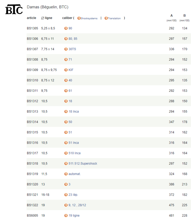

Yes I've looked up the Balance staffs for Beguelin ~19lignes watches and two came up the 588 and the 6002.
But the 588 doesn't fit (roller table fouls the bottom plate) and the 6002 isn't that far away measurement wise....so I'm stumped šŸ¤·šŸ»ā€ā™‚ļø
Hence my question to the forum about the calibre of the watch...was it 'special' ?

Are you sure it's a 588 and can you measure and compare with the below.
Is the pivot jewel sitting correctly.

I measured the length of the staff I bought (588) and it measured 475 long. I used a micrometer and a digital Vernier and they both read the same.Ā
I also inspected the bottom balance staff jewell a bit more closely and it's a bit low for my liking. I have a seitz jewelling set so I'm going to replace it as I'm not happy with it's condition (looks slightly cracked)Ā
So I'm now looking for a bottom balance staff jewell...!

2 hours ago, AndyGSi said:
The 6002 are available but only 0.006mm longer than the 588.
Yes you're right....6 microns isn't going help.....and the B measurement is only 3 microns more too....I'll have a really good look at that bottom jewell set up.
