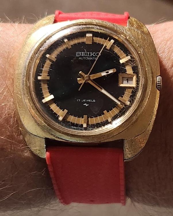

Got this wonderful 1971 $8 eBay find running.
Other than a broken mainspring and a crack in the crystal, it just needed a good clean up.
It did have a beat error problem, but I got it adjusted to a 0.6ms BE, a 260° and positional error of +/-30s. Not bad for essentially a novelty watch probably not expected to make it much past the '70s. I think the hardest part was fitting the pallet fork without jewels. Those holes are TINY!
That brass plating was 10 kinds of awful so I just polished it off for now. I might nickel plate it. Or 24k rose gold, for such an elegant timepiece. 😉

Your hand is going to fall off due to lack of blood supply.  Hehe.
It was a new strap. 😛
