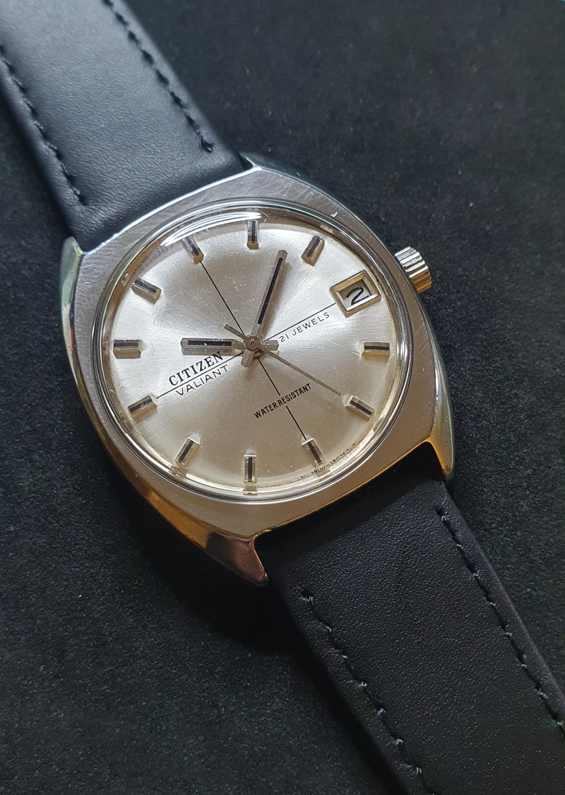

Got a submission for the club, as previously featured on the what's coming in the post, this Citizen ValiantScreenshot_20241025-105340.jpg.c5140212a3bcae9b05ec147a4d64489e.jpg
So price criteria met20241025_151406.thumb.jpg.f37c7274680d73a345bf4267302d836b.jpg20241025_151421.thumb.jpg.28e246326ba31cba4f14630d75ed0fef.jpg20241025_151445.thumb.jpg.3ca06f4df826894b0f7cd724e378057e.jpg
It's either 1963 or 1973, with the plastic movement ring will probably go for 73, and the movement is the 1802. I've had dealings with this movement before, it's one of those that just will not sit nicely in the movement holder so you end up fiddling around with it until you tighten onto the balance, then you hear the pop and your heart sinks. Learnt my lesson there so made sure the balance was out whilst on the dial side.
Only part purchased was the crystal, replaced the crown which I have a bag full, and the strap was a freebie from cousins. Cleaned up the case, didn't go to town on it but now looks a little more respectable. Beat error was really out and took an age to bring back but fluked a 0.0. I do wonder how fixed stud balances get so far out, this one certainly wasn't loose. End result +5/6, 270, 0.020241102_220752.thumb.jpg.db49e1c872873bc14e1ffb6e98aa1d71.jpg20241102_215713.thumb.jpg.c6608cf5856e22eb13e508c603750d38.jpg
Believe it or not, that was the time I took the picture, although I did wait a couple of minutes.

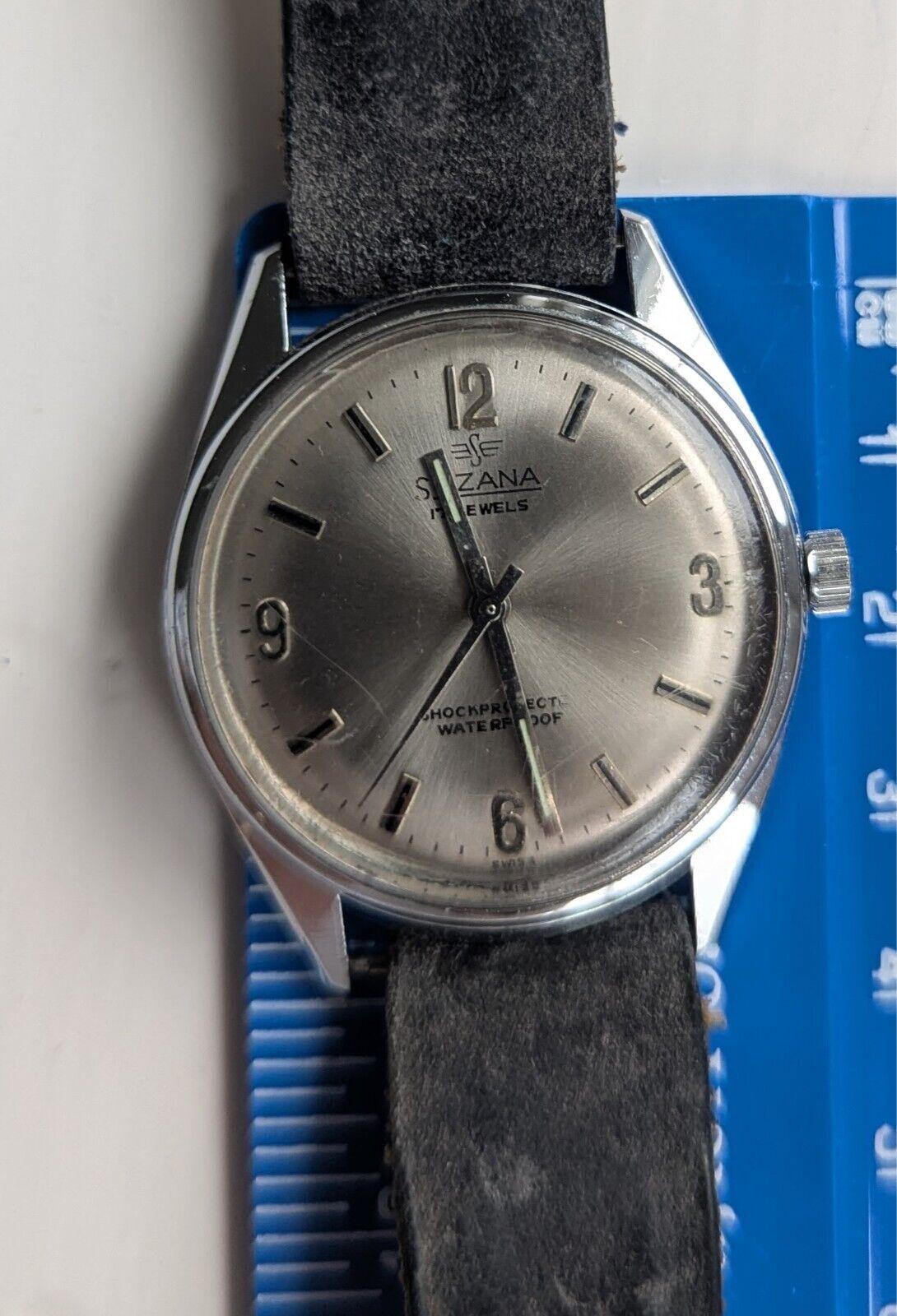

Finally a worthy contribution:
$10 US, a "Splendor" skin diver in a monobloc case. I was hoping for an EB8800 movement, but could tell by the slow calendar change action that isn't it. I also assumed a 2 piece stem and firmly pulled a 1 piece stem right out! But apparently this is by design? It reinserts and still works correctly.
Also expected a tension ring crystal I would have to blow out, but no it is a basic crystal removable with a lift tool. The dial is pretty marked up unfortunately, and the hands don't look great.

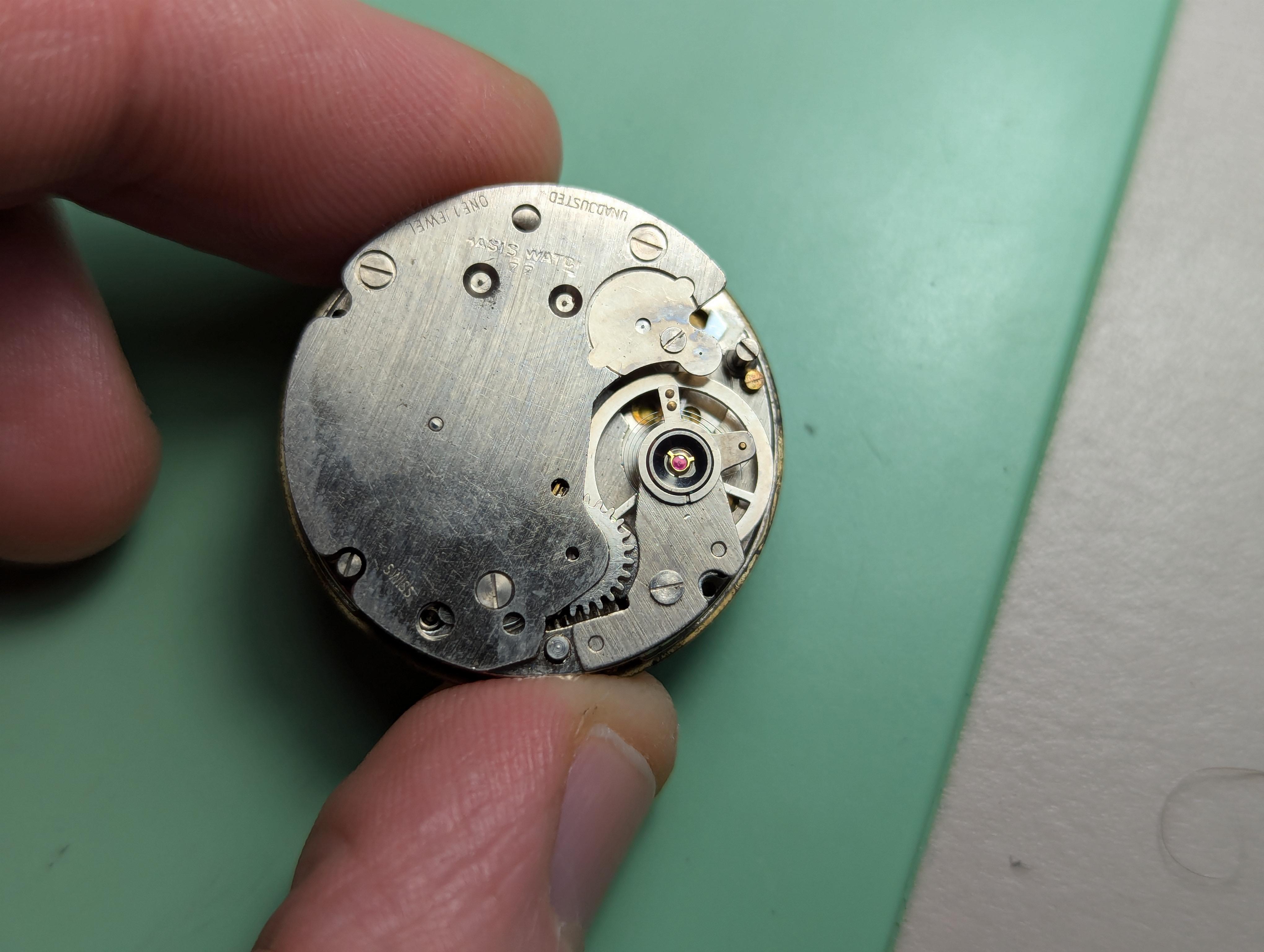

The movement I expected was a Baumgartner 866, but I'm not sure yet what this thing is.PXL_20241114_225512165.thumb.jpg.ae0adc617725981b3caa2e9a4cde1ac1.jpgPXL_20241114_231417356.thumb.jpg.13319e7a17a9e972aa3ebe1cc9c5a1cc.jpg
Edit: Ah, the movement must be a Brac 500 series something or other.

Okay this comes as a surprise. I don't think a 1 jewel pin lever has any business hitting >320° and knocking 8 hours after full wind. I haven't installed the motion works and calendar yet so I'm hoping those shave 5° off the horizontals so I don't have to find other ways to temper it. I really didn't expect a movement like this to run so well. The mainspring is very thin and super long, so I'm interested to find out its power reserve.PXL_20241118_024538240.thumb.jpg.73e49032d83d05e3539a7e2cdba97034.jpg

Mainspring should be 1.25 x 0.125 but can't find any details on the actual length.
I know you say it's knocking but can I ask what you've got the lift angle set at?

Lift angle is 42.0° as I found documented a couple of places. The photo above was taken just after switching to DU from a vertical position, and just before it gained enough to start knocking again. I'm not too worried yet since I expect the calendar to calm it a little. I can't imagine this watch was ever serviced in its life though, and expect the mainspring is original. I didn't measure it before reinstalling, but it felt much thinner than I am accustomed to on 70's and 80's wristwatch movements. I had to wind by hand because the barrel is quite large, 13 or 14mm and too big for any of my wristwatch winders but with an arbor hook hole too small for any of my pocket watch winders.

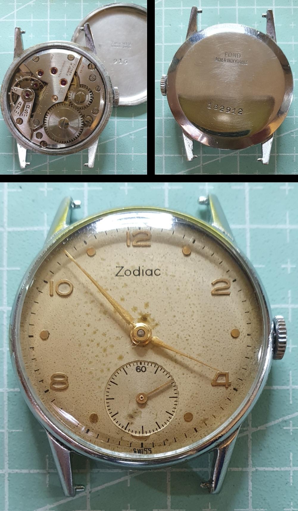

Another contender:Screenshot_20241025-105255.jpg.c56aeca86b1960c8ab3c1816dca43690.jpg
So here we have a 1950's Zodiac with the FHF 26 movement. Purchased for £10 buy it now, on arrival, as you can see, condition not too bad, there is some of the chrome plating coming away from the case. Movement was running, but somewhat reluctantly. Full strip down and clean, mainly just dried oil with a few hairs thrown in. There is quite substantial wear on the movement plate in the stem/clutch area, so not much I could do about that. Some fun and games with the hairspring, my fault, managed to slip and distort the spring whilst addressing beat error, but managed to recover from that. Like mbwatch's watch, I was surprised with the amplitude on this one at 290.
So nothing spent on the movement and case, everything was usable, however, I don't think the hour hand is correct, doesn't match and a bit too long for my liking, but as it's a £10 watch, I can live with it.
What I did have to order was female spring bars, not had any dealings with these previously. It's a small watch from the period and the lug width is 16mm, so ordered 16mm female spring bars. Wrong, I needed 14mm in order to get past the pins on the lugs. Cousins no longer stock these and elsewhere ridiculously expensive, so took apart the 16mm ones, ground down the tube to required length and re- assembled with the help of the staking set to round the ends back over.20241117_202507.thumb.jpg.acccb44bf6a7767abf9f87756b1cda0e.jpgScreenshot_20241118-132215.thumb.jpg.5c7282fa87402cf402f1317179201c4f.jpg

It was early and I didn't see the 42.0° on the timegrapher but find it
hard to believe if everything is OK that the amplitude is correct?

It is correct, confirmed with a slow-motion video and when it knocks it is easy to hear. The thing just has very high amplitude. If I open it again I'll measure the mainspring, but there was no evidence the movement had been disassembled before. Plate screws were factory tight and not a mark anywhere on it.

Final results: after 30 hours, still running 290° horizontal and 250° vertical. With the motion works and in place at full wind it sits at about 328° and hasn't started knocking in DD. For whatever reason, the DD amplitude is slightly higher than DU even though the balance cock has a ruby cap while the lower balance cap is steel. In all, I'm impressed with this cheapo movement.
I just need to get a flat-ish acrylic crystal to put this back together. The hands were filthy but cleaned easily with rodico.
Are you sure the balance staff even touches the jewel? It's been a while since I messed with a movement like that, but last time I did, the jewel was just decoration and the staff fit into a conical steel cup.
A name brand for under £10. Nice! I wonder if some silvering would clean the dial up.

Did you notice the broken jumper spring on the set bridge ?

I missed this a few weeks back - yes it's a real functional jewel. And on the dial side a polished steel cap "jewel". They are fit into real metal chatons with a shock spring. I have seen the decorative type on an EB8800 before though.
