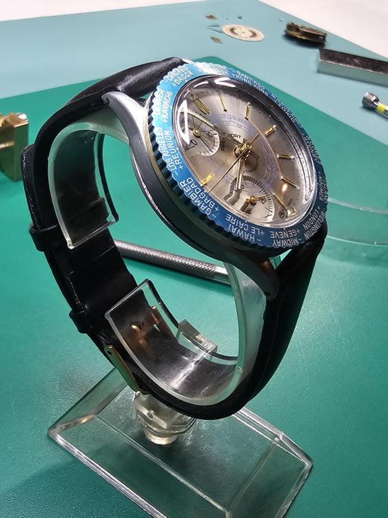

Screenshot_20250223_112238_eBay.thumb.jpg.96e95fb926f6607743b956d88c34cea7.jpgScreenshot_20250223_112244_eBay.thumb.jpg.4966ae85d1cebba1396ddbbe53963b8e.jpg$10.50usd awarded me this cool REGO SPORT "chronograph" with a Lapanouse pin lever movement on ebay. I bought it specifically for the challenge, as it looked like it had spent some time in the pool.
Some deep cleaning, over polishing, shotty hairspring work and a $7 parts movement for a replacement pin pallet and Today it is on my wrist and keeping great time over the past 6 hours.
and the "chrono" functions!
Im very proud.
2 hours ago, spectre6000 said:
What is the "chrono" in real life? What do the pushers do? Without being able to see the guts under that full plate, it looks like a plane jane three hander.
It just starts and stops the watch. The upper sub dial registers in 30 minute increments, the lower sub dial in 6 hour increments. You could theoretically set the watch to 12:00 and use the chrono buttons to time something? Lol idk
31 minutes ago, spectre6000 said:
Which pusher stops the watch, and what does the other do? I'm trying to decide if this thing is clever or not...
Sorry, only the second hand stops with the top pusher and starts with the bottom. The rest of the watch runs.

Is there a way to reset the second hand/counter dials to zero, or is it just a two button hacking mechanism?
Set the watch to 12:00 lol
I found this on the interwebs-
"Calling this movement a chronograph is generous. Technically, it is, but its limited features has it referred to as a "lap timer" by some.
The chronograph's upper sub dial registers 45 minute increments while the lower totalizes 6 hours. As shown in the above image, one must manually advance the time to 12 o'clock sharp and allow the seconds hand to reach 12, too. Pressing the top chrono pusher will stop the seconds hand.
One the bottom pusher is deployed, the time advanced until the top pusher is pressed. The above shows 45 minutes having passed. The top chrono hand made on full revolution for it measures 45 minutes only. The bottom register stopped at the 45 minute sub dial indicator, one tick mark before the 1 hour spot. To regain the current time, one has to refer to another timepiece and re-adjust using the tradition push-pull crown."

I absolutely love clever ways to short circuit otherwise overly complicated things. I.e., dual inner rotating bezels and a three hand movement in lieu of a full fat chronograph a la Bulova Type A-15. That comes close, but doesn't quite bridge the usability gap. Still, very cool movement!
Its the loudest watch I've ever heard run. My wife thinks a man must've drowned wearing it and it's haunted.
