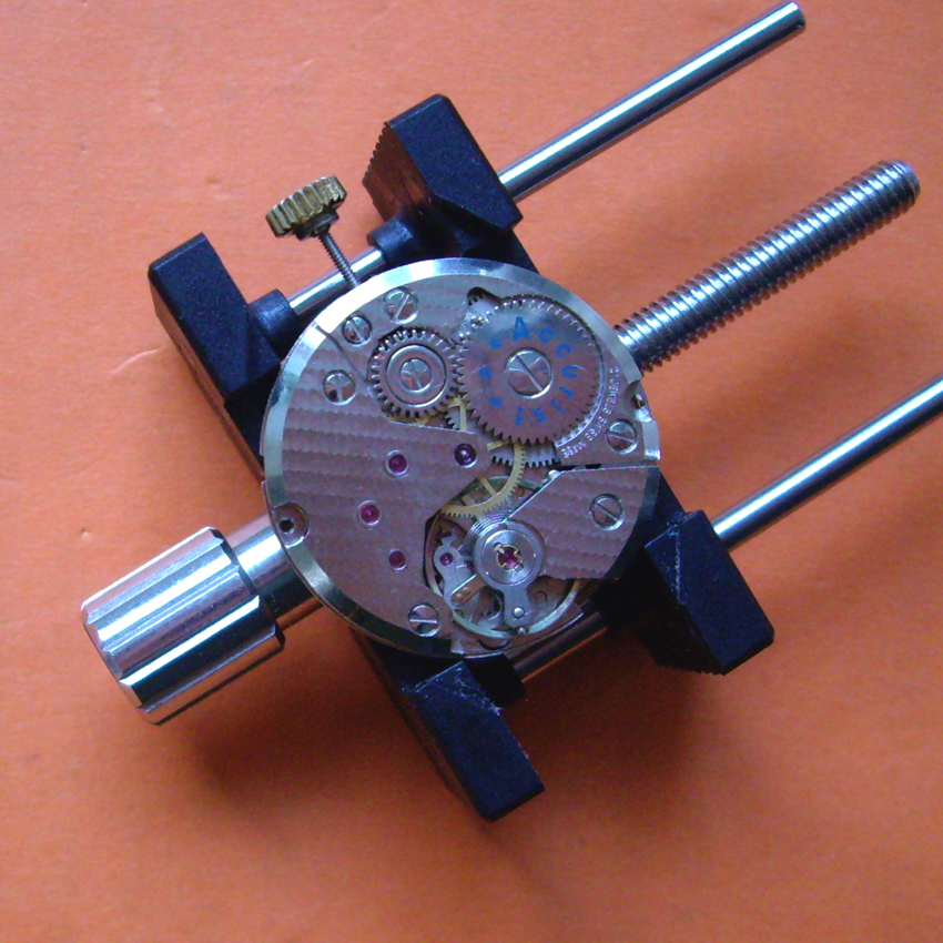

I've just serviced an Accurist 21J Shockmaster and got it running nicely. To lube the balance pivots I've done the classic and lost the top jewel retaining sping. I thought I was being so careful as well, but 'ping' off it went somwhere.
The movement is a Peseux 7066 with date function, so I assume the same spring is used in the 7060.
Can someone identify the spring clip required for this one. Part number and source please. I would not know where to start.
They seem to differ, I saw this one online which is probably a later 21J version or not a 7060/7066
Thanks in advance.

They are not the same shocksprings .If you look att the top one it has a slot on each side . But the lower has three slots . What kind on the other side of the movement .lLooks more like incabloc springs?

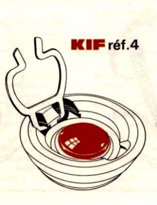

I still think it's a KIF spring Roger. What do others think?

It looks more Incabloc than KIF. But if you look closely at the dial side spring there's a small tongue on the spring that's in line with the slot. Maybe that was an early Incabloc.
All a bit strange, the one Canthus shows doesn't look like the one in the picture posted by Systeman.

Just to clear up any misunderstanding, the spring I'm trying to identify is for the Peseux in the first (orange background) photo. I'm not trying to identify the spring in the second photo. That photo is just to show how a similar movement has a different anti shock system to mine. I agree that one is KIF.
I'll try to upload a better photo tomorrow.

I'm back with good news.
While I was taking a photo of the jewel and spring on the dial side, I decided to give the movement a little tap. Guess what fell out, not just the spring, but the jewel as well. Truly remarkable.
So here we are then. It would still be nice if it can be indentified. I'll refit it and upload another photo in another couple of days.
Hi all,
Thanks for all your input. Here is the spring refitted with the orignal jewel and cap jewel.
Anyway, now I've refitted them I'm back to square one. It runs for a while then stops. Time to dismantle and take a closer look.
