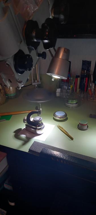

15 hours ago, mbwatch said:
I don't have a microscope, I don't have a Jacot tool. I'm mostly stuck with whatever condition my pivots are in, beyond cleaning them. I imagine there's quite a bit of potential power being lost there.
If you don't have a Jacot tool, you can still give pivots a bit of a polish. Use some pegwood with a hole in the end, and some abrasive like jewellers rouge, then spin the pegwood between your fingers to give them a clean. Also the pinion gear teeth (leaves) can be dirty. I use some sharpened pegwood to clean between the teeth.
I do use the light green fine Eveflex pin polishers, i dont make it a habit only if  pivots look badly tarnished. Good idea with the pegwood hole thing mike, do you pack the hole with rouge ? Could be a good alternative to the Bergeon pivot polisher, I also use polinum for various hole and pivot buffing mixed with a bit of paraffin to soften it up and give it some extra gunk removing power.
Between these two options, I would feel safer (less likely to break pivots) with Eveflex pin polishers. (knowing it's only really a clean and not able to repair scoring or reshape) Though I believe I remember some derisive attitudes toward that method in the past. I do usually give pivots a sort of scrub in pithwood, though I doubt it is very effective at anything beyond dislodging dirt chunks.
The rougher grades will pull score marks out, you'll end up with a thinner pivot but you would whatever you use .
Not just thinner but cone-shaped. That's one reason EveFlex or similar methods can't replace a Jacot tool. EveFlex is good for cleaning but I wouldn't use anything coarser than the "extra fine grit, soft".
