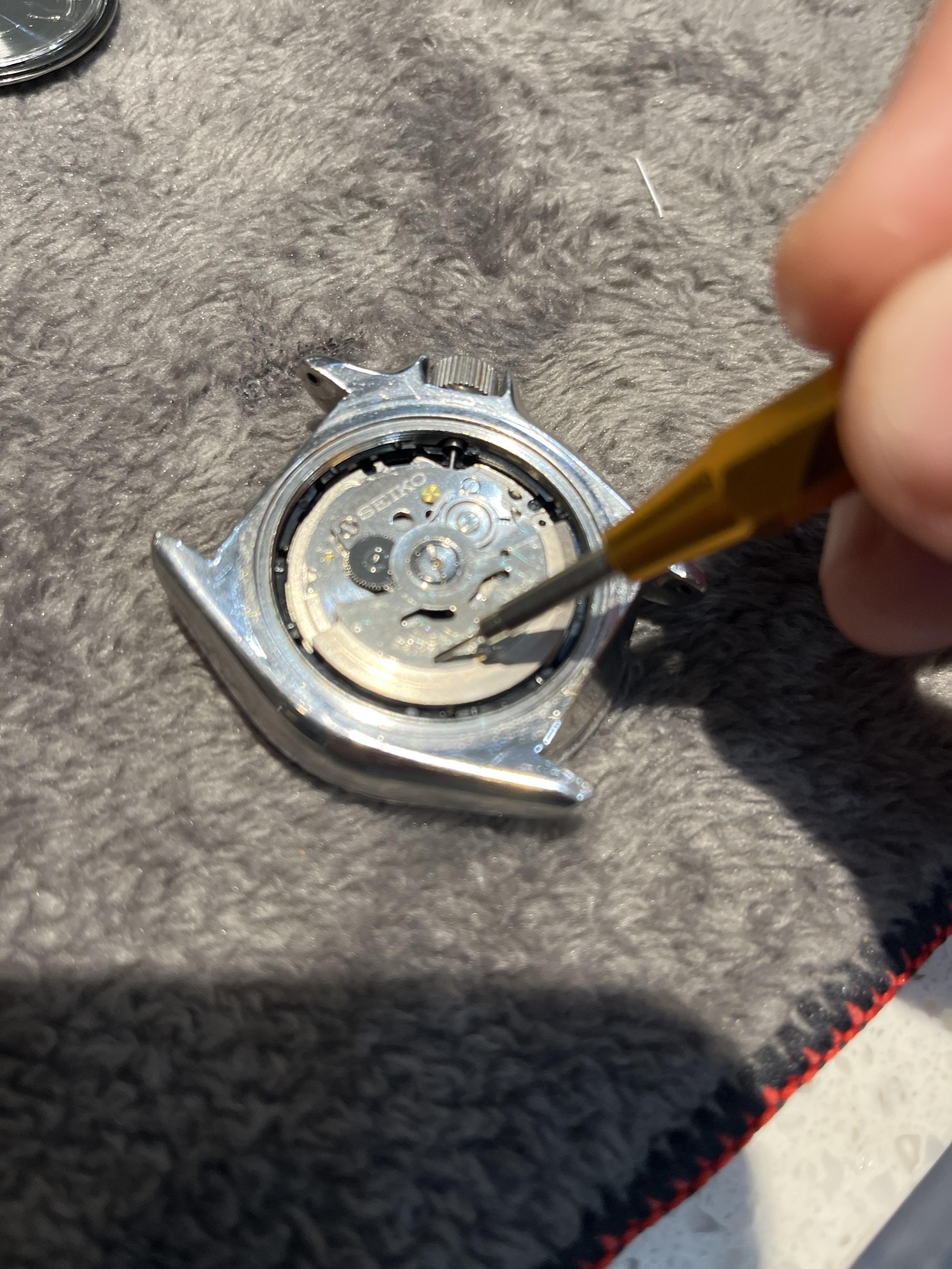

I am a novice at tinkering. I’ve built and modded a few seiko skx’s and have really enjoyed them. That being said, I’m stumped. After replacing the crystal with a flat sapphire one and regulating the time over the weekend, as it was about six minutes fast per day, I now have a stuck movement. I’ve tried reseating the crown a few times. Tighten the counterweight screw and still no change. I perform the drill shuffle and nothing unless I wrap it with a little force and all hands advance rapidly for a short time then stop. Any and all advice welcomed.
Could the rather large regulation adjustment have distorted the hairspring & caused it to bind?
Other than that I'd take the movement out & remove the hands and dial again, then see if it runs OK? If so, you know it's something binding or catching when assembled.

At what point did the movement stop running ?
Hi As we assume all was ok in the first place and the watch was running THEN you had a problem do as @rjenkinsgb suggested remove the crystal and start again, if it runs ok the crystal is binding the hands.returning to the status quo.would give you a starting point
Take the movement out of its case and see how it runs. If it works you know it is something to do with the case is the glass the correct one is it seated right. If it stops you then need to find the reason, start by just have the basic running and work from there up so that you end up with the complete movement working.
The stoppage started day three after crystal replaced. Final adjustments made prior to stoppage were as followed: 1 made minor adjustment to move the rate lever to the negative side in effort to slow it a bit. 2 closed the watch back up. 3 did the Seiko wobble and noticed a different sounds of metal on metal. 4 reopened the back and found a screw had backed its self out. Tightened the screw and now stopped or stuck movement. All was in working order prior.
When you say stuck movement, does the weight still rotate and wind the barrel (don't try too hard if it doesn't want to move)?
It could be the fourth wheel that's moved so you may need to remove the bridge or at least loosen the screw again to re-engage.
Something under that auto has probably moved out of position
Thanks to all for your help! I’m going to crack it back open, remove the weight and take a look. Admittedly, I’m a little apprehensive as I’ve haven’t yet disabled beyond that. Previous experience has been more of the cosmetic sort; face, hands, crown, crystal, chapter ring & bezel replacement. I fancy myself pretty mechanically inclined, so going to give it a go. In your experience, is there something I should avoid doing or be looking for? Any chance there is a pic of the fourth wheel location? Once again, sending all a large and humble Thank you.

Hi all the speculation in the world is not going to fix the problem it’s going to have to come apart carefully checking as we go. Hectors advice is best followed first as it’s the least invasive. Just power down the movement remove balance and pallet then check the train for freedom , if still stuck the bridge will need to come off to go further. Take pictures at every stage and ant notes that may be aplicable
I would follow @oldhippy advice and remove the watch from the case and see if it will run, if yes then it's the case/crystal. If it will not run it's something to do with the movement. I would then remove the hands and dial, again if it runs or not will tell you if it's the dial/hands, if it runs then its the movement. Next remove the cover plate on the dial side and then the cannon pinion this separates the front of the watch from the back, if it runs without the cannon pinion then the issue must be on the dial side and vice versa. So with these few steps you can home in relatively quickly where the error lies.

can we have a picture of the front of the case? how long have you own this watch in other words how long has it been running perfect?
based on your level of expertise it sounds like this is going to be your first possibly complete servicing of a watch. Because if you're going to have to disassemble very much of it and based on what I'm seeing it probably should be completely serviced. Where it's always nice to start learning about watches with something that you don't care about and is disposable. Also nice to start with something a little simpler and maybe a little bigger. but with all the helpful answers it looks like this is your first watch the service as soon as you figure out what the problem is. then it would be helpful probably to have the service sheet so I'm attaching.
