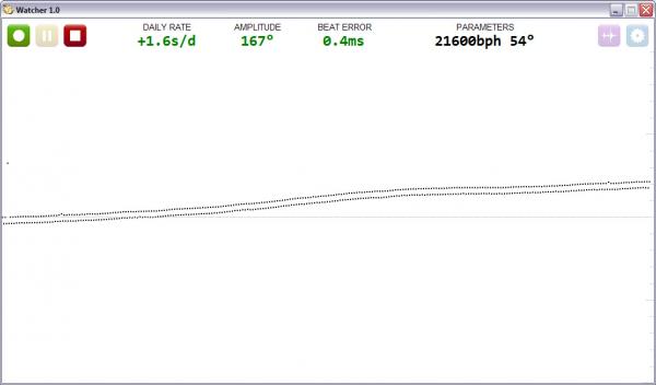

The next picture shows the timing trace from my "Black Lagoon", a modified Invicta 8926OB with a Seiko NH35A movement (yes, the amplitude is quite low and tends to fluctuate, topping out around 220 degrees - apparently this is par for the course for Seiko movements):

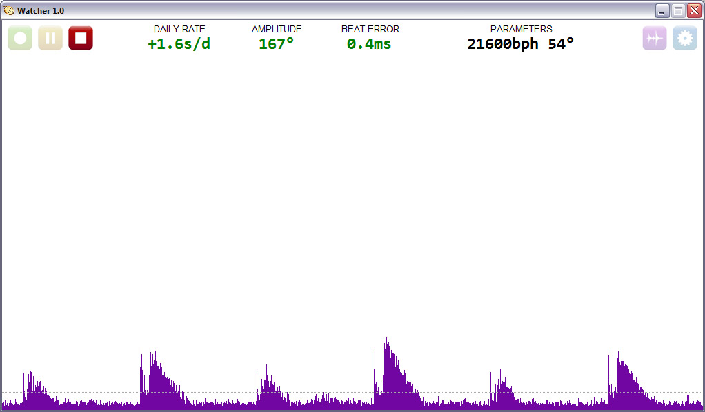

In this picture, the software is in scope mode, showing directly the ticks and tocks. Notice how with this movement, they alternate in loudness. Since the scope mode was run after the timing mode, the scope also shows the threshold that was used by the timing mode to detect the start of each tick.

  • Horizontal "paper tape" mode with sub-pixel vertical resolution that can show fluctuations that are too small to see on a typical stand-alone timing machine.

Last night, I finished servicing my Poljot 3133-powered Sturmanskie chronograph, and had a chance to use my timing system "for real" for the first time:
Note that the annotations you see on the screenshot were added by hand, although I plan to add a feature to do that automatically.
I first used it to test the performance in four different positions, then used it while adjusting the watch, and then tested once more. Until now, I'd been recording the watch and then measuring ticks by hand in Audacity (an audio editing program). It was really nice to be able to have the performance displayed in real time.
