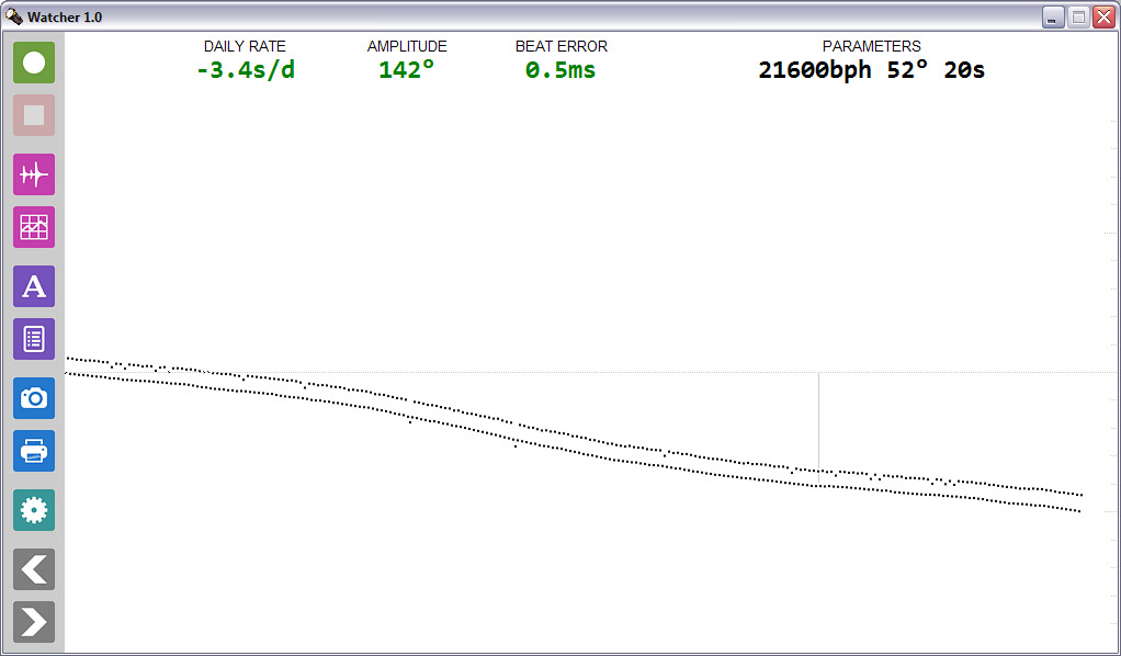

Another update. I've been busy working on the timing machine software, implementing features on my want list. Overnight last night, I ran a long term test on my Sturmanskie:
I started the test very shortly after 10pm. Notice that at 11:30, the watch starts to speed up, reaching a peak of about +12/d. This is during the date change, which puts more load on the mainspring, thus reducing the amplitude and increasing the rate.
Notice also that there is an hourly variation rate of about +/-1s/d, probably due to something being slightly out of round.

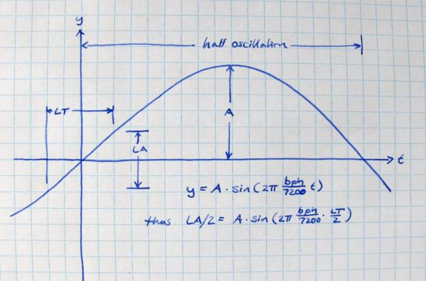

regarding http://www.stefanv.com/watches/restoring-a-russian-alarm-watch.html :
What formula did you use to obtain the amplitude from the tick length? ("With a 37ms tick length before the overhaul, the balance wheel had a swing amplitude of only about 85°")
I red your article but I didn't understand the connection between the tick length and the amplitude until I red http://www.witschi.com/download/Witschi%20Training%20Course.pdf
Thank you!
Bogdan
Hi Bogdan:
The formula is:  amplitude = liftAngle / sin(2 * pi * liftTime * beatsPerHour / 7200)
Where:
  • amplitude is what we're trying to compute, in degrees
  • liftAngle is the movement's lift angle, in degrees
  • liftTime is the measured tick length (time from start of first sound to start of third sound) in seconds
  • beatsPerHour is the nominal beat rate of the watch
I'm assuming the sin function is working in radians. If you're using a calculator or programming language where the trig functions work in degrees, replace 2*pi by 360.
So the example from my article you quote above is:
amplitude = 49 / sin(2 * 3.1416 * 0.037 * 18000 / 7200)) = 89
(I made a mistake when I wrote the article. I had the "2 *" outside of the "sin(...)" in my calculations. I've just corrected the article now.)
Bogdan and I just had a PM discussion, and it turns out that the numbers I had in my article were actually correct, and the proper formula is:
    amplitude = liftAngle / (2 * sin(pi * liftTime * beatsPerHour / 7200))
In other words, the "2 *" does belong outside of the "sin(...)". I will now re-correct my article. :-)
For those interested, here's how the formula is derived ...
If one were to plot the angular displacement, y, of a point on the balance wheel over time, it would be sine wave.
A sine wave of frequency f and amplitude A, the equation is y = A sin(2π f t), where t is the total time elapsed, measured in seconds. The frequency f is the number of full oscillations per second. The "beats" in "beats per hour" (bph) of a watch are actually half oscillations, so to convert from beats per hour to full oscillations per second, one has to divide by 7200. Thus the equation becomes:
y = A sin(2π (bph / 7200) t)
Now consider the following diagram, which shows one half oscillation (and small portions of the previous and next half oscillations).
The lift angle (LA) is the portion of a full oscillation during which the balance wheel is being propelled by the escapement, and is fixed by the design of the particular movement. The lift time (LT) is the amount of time this takes, and is measured by one's timing machine. During the beginning of a half oscillation, the movement is propelled through half the lift angle (LA / 2) for a period lasting half the lift time (LT / 2). Substituting these quantities for y and t into our equation above yields:
LA / 2 = A sin(2π (bph / 7200) (LT / 2))
Finally, rearranging to solve for amplitude (A) yields the equation from my previous post (with the variable names substituted by the ones I used in the diagram):
A = LA / (2 sin(π (bph / 7200) LT)
Q.E.D.
PS. Sorry Bogdan, I didn't use omega. I wanted to keep this brand neutral. :)
