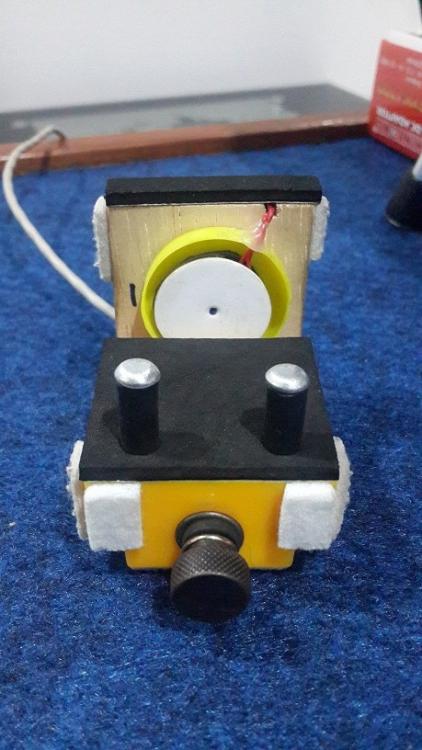

Dear Stefan, attached is my mic stand, i use felt as cushion, is there anything than can cause resonating?

From the pictures, I suspect that the resonance you are getting is physical, not electronic. That yellow plastic around the microphone might be resonating, or whatever is behind it might be. Did you use a bare piezo element, or is it enclosed in some sort of plastic housing. If it is enclosed, _that_ might be resonating.

The resonance is probably caused by a combination of factors. Perhaps with some watches, the yellow plastic dish vibrates against the plastic of the watch holder? I would suggest removing that dish entirely, since its shape will cause echoes, and the edges can easily vibrate.
already removes the yellow plastic, resonance problem still exist..

Dear Guido, the purpose of white plastic in front of the piezo disc is to prevent dent on the piezo disc surface when fastening the watch crown toward the mic, but indeed it may reduce the sensitivity of the mic, i will find another way to prevent the dent.

Regarding the plastic piece that covers the piezo, it definitely alters the sound of the watch. The Piezo is actually a "vibration sensor". And plastic is a bad driver of vibration. I have an original microphone from a time control machine. (Timing machine). Brand Elma. And the sensitive parts are metallic. And curiously they do not pretend to "touch" the crown, but rather the "case" of the wristwatch.

On the other hand, I can make a suggestion from the information you share. You say: 'I use the plastic on the piezo in order to avoid denting.'
I think you're squeezing the microphone stand too tight. In doing so, some things happen: it flexes the piezo and deforms it with what changes its acoustic response.
