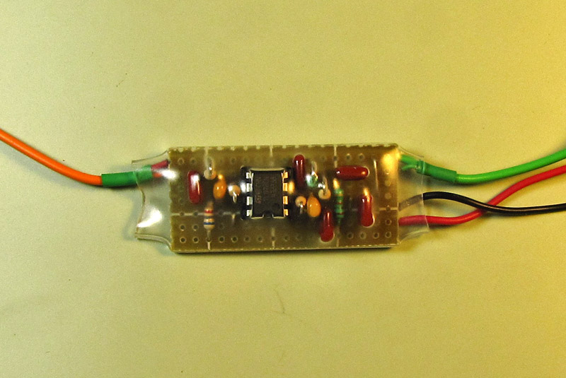

Hello Svorkoetter,
Could you advise whether it would do any harm if I was to drop a 470 ohm resistor with LED into the circuit between the battery + side and pin 8 of the TL072 - I
forget to turn things off and I find a glaring red light helps :) .  Also another silly question from me - which resistor is the Pot or variable one and do you have any recomendations for the pot or is it just bog standard.
I am getting all the components together now.
Cheers,
Vic
You could add a resistor and LED, but it would reduce the battery life by quite a bit. As it is now, the circuit will run for about 100 hours non-stop from a 9V battery. That will go down to about 15 hours if you add the LED as described, which isn't even long enough to do a power reserve test. By the way, I use a rechargeable 9V battery (8.4V actually) so as not to use up 9V batteries.
There is no pot in the current iteration of the circuit. I found that with the original circuit, I always had the pot turned up all the way, so I just left it out and replaced it with a fixed resistor, R5, which is part of the output filtering circuit.
One important thing to keep in mind is that the completed circuit should be installed in a metal enclosure, with the circuit ground connected to the enclosure. Otherwise, despite all the filtering, AC hum will be a problem. Also, if you're using jacks for the input and output, it's best to use shielded cable between the board and the jacks.

A quick update. I've just finished building an amplifier as per my posted schematic (which is slightly different than the one I built that is in the photos earlier), and it works fine. Also, I've found that if I use shielded cable between the circuit board and the input and output jacks, then a metal enclosure is not necessary after all (sorry Vic). The previous amplifier had more cabling due to the potentiometer in the circuit, and that one did benefit from a metal enclosure.

Here are some photos of the amplifier I just completed, built exactly according to the schematic and circuit board layout I posted earlier.
I borrowed a trick from my electric R/C flying days, where electronic speed controls often used heatshrink tubing as an enclosure. Here the tubing just acts as a sub-enclosure to provide some strain relief:
Here it is in the case:
Vintage style labelling:
Oh, by the way, I measured the exact current consumption to be 3.63mA. Adding a red LED and 470 Ohm resistor would increase this to 19.2mA, thus cutting battery life to less than 1/5 of what it would be without the LED.

Soldering the output lead directly to the board is fine. Whether it's a 2 metre tail, or a 5cm tail with a 2 metre cord plugged into it, makes no difference. In fact, you could solder the lead from the mic directly to the board too, and do away with all connectors except for the plug that plugs into the computer. If I commercialize these, that's probably what I'll do, since connectors add both material and labour costs.
