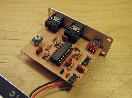

I've been busy with a new geothermal heating system that we had installed over the holidays (we like to say that we now heat with dirt), but finally got around to finishing the prototypes of the new preamp design:
The preamp is now fully enclosed in aluminum.
For me, performance of the new preamp isn't that much better than the old one, but I'm hoping it will work out better in electrically noisy environments.

Hi there. Would you be willing to share the latest design for the preamp? I'm thinking of building one and giving it a whirl.
Sure. First the schematic:
There is only a single chip, a TL074 quad op-amp. R7 is a trimpot, since you really should only need to set it once, but you can use a panel-mounted pot if you want. Just be sure to use shielded cable from the board to the panel.
The main differences between this circuit and my previous one are that this one uses a stabilized and filtered virtual ground in an effort at further hum rejection, and it uses three stages of amplification instead of two. There's also more high-pass filtering, but at a lower cut-off, so hum rejection from that should be about the same, while allowing more low-end sound from the watch through.
Here's the circuit board component layout, as viewed from the component side:
And circuit board artwork, as viewed from the copper side:
Note that I have built two of these. C1 was originally omitted, so it won't appear in the photos I posted earlier, so technically I have not built this latest version which adds C1 to the board layout, but I did retrofit C1 onto the existing boards.
EDIT: The locations for C2, C4, and C6 have three holes each, to allow use of capacitors with either 0.1" or 0.2" lead spacing. If using the former, be sure to use the correct pair of holes.

In the interest of super low noise why not another battery for true dual rails? I have always found the noise to suffer when a virtual ground is used. I'll give it a shot :) sometimes a good enough design is well, good enough.
That's worth a try. The op-amp is good up to +/-18V (i.e. 36V total rail-to-rail), so just using a pair of 9V batteries should work just fine. It'll be interesting to see if it makes any difference.

p.s. I built the first "model", with the help of a friend, and it works just fine when I listen to it using some headphones. When I input the signal into PC or laptop, the entire hell breaks loose - although I put a 10K variable resistor at the output, like you put at the second model) and the noise is also too high. The microphone is also listening to the laptop, desktop... things I say...
+/-18V is the maximum that the chip can work with, but you don't need to go that high. The minimum is +/-3.5V, which is a 7V range (and thus a single 9V battery is sufficient).
Note that ligangyi is not proposing to simply increase the voltage, but to remove the virtual ground part of the circuit, and use a dual polarity power supply (i.e. two 9V batteries).
Regarding the noise, I'm not sure what's going on. A watchmaker in the UK who I've sent one of each of my amplifier models to is having the same problems. It seems like some PCs (and especially laptops) inject noise into the amplifier, which then gets amplified and sent back to the PC. Other PCs (like all of the desktop ones I've tried) work fine. With many (but not all) laptops, the problem goes away if you run the laptop on batteries instead of the AC adaptor.
