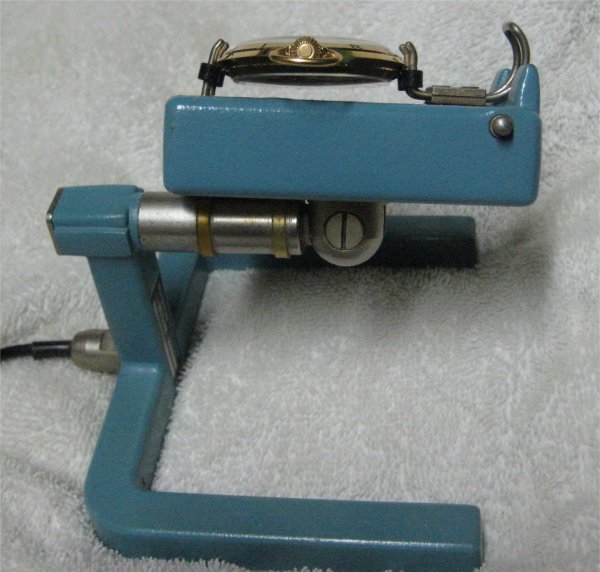

So the blue pickup is what I consider a classic at least it’s timing machine that it goes with is a classic the Portescape B200. So the pickup as you can see can be rotated in a whole bunch of positions for multiposition timing which is really nice for troubleshooting. Then this pickup is very similar to the Greiner at least before it was converted. So basically the B200 timing machine is a very very popular timing machine found worldwide for a very long time until replaced by the modern electronic machines.
So now we get the confusing part. Watches held in the holder it’s a spring-loaded holder to make contact on the pins which transmit the vibration to the square crystal on the other side. The two large black headed screws hold the plate in place except which is not visible it’s held in place with rubber mounting. You can actually move the pins on the watch side and the plate does move a little bit. Then confusing wires because there are coils on the other side not visible for picking up balance wheel electric watches.

I think I can answer the question regarding the Greiner Microphone with a photograph. Here's a photograph of a unmodified original factory pickup.
