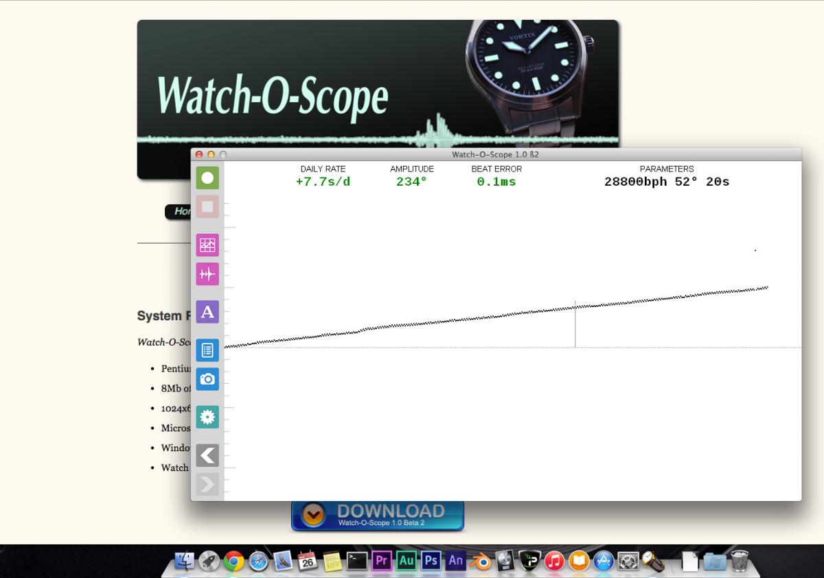

Just for giggles I thought I would try it on my MAC and it seems to work fine. I am extremely impressed!
Wow! I would not have expected that to work. What software are you using to run Windows applications on the Mac?
