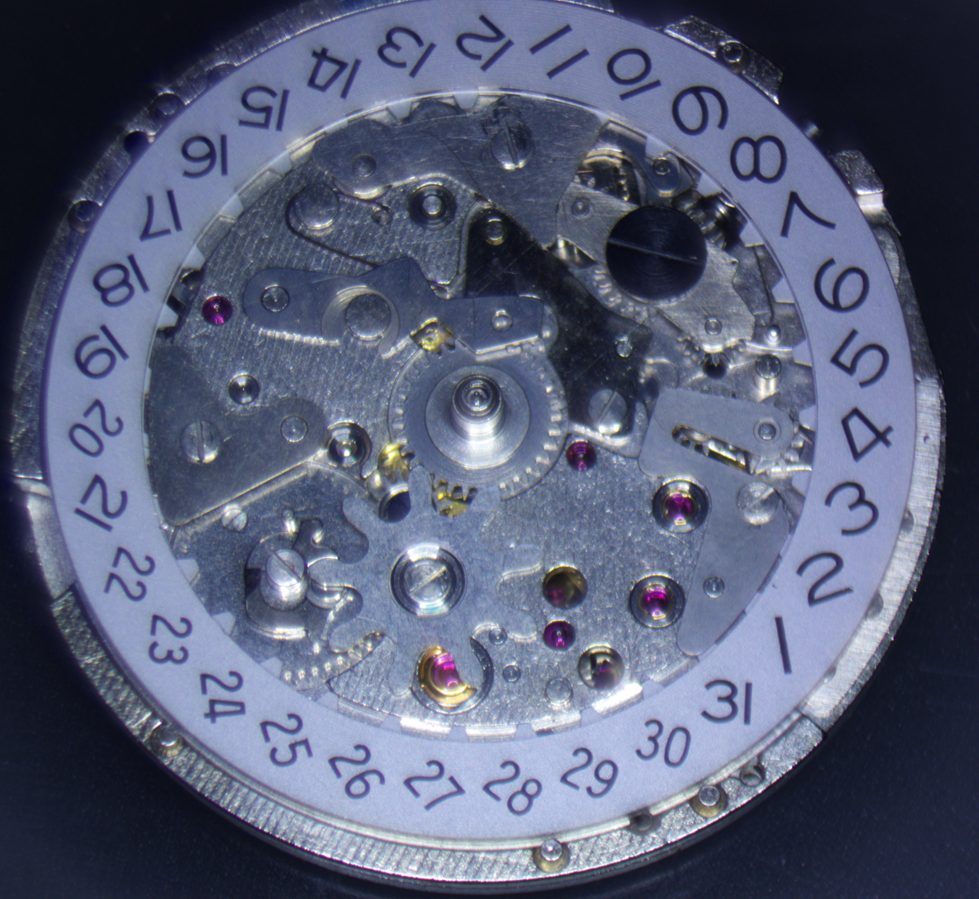

I have a Citizen Crystal 7, cal 5204 with 33 jewels. It looks similar to your movement.   I remember it has a hell of a lot of springs (with 4 just on the dial side). I notice you seem to have a number of springs in the tray. Ping !
It all seemed a bit over complicated for just day+date.  It put me off Citizen a bit, as Seiko do it so much more simply.

Hey it's been a while! I've been so busy this poor guy has just been sitting on my bench, cleaned and ready for assembly.
I tried a couple of things in a corner of the dial, and no, the yellowing is not coming off.
I did finally get the mainspring wound and installed, and the train side together. At least to the balance, which started up immediately and beautifully.
If you take a careful count, there are 6 pivots in that bridge. You can't see the jewel inside the tube for the center seconds arbor. It's a testament to both the quality of the movement and my patience that I was able to get it assembled on the first try.

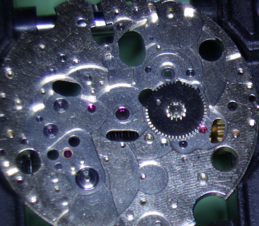

Well, it finally happened. When I first put the click on, I noticed the threads felt a little soft. I had to take it off and put it back on, and this time the screw just spun.
The post is very worn and there are a lot of tool marks on the parts, so I'm not entirely surprised. But I'm stuck with "now what"?
Not having a lathe, I don't think I have a whole lot of options. Ideally I'd like to make a whole new post to fix the wear (you might be able to see how oval it is in the photo), but for now I'd be happy with the screw staying in place.
  • I tried a sliver of aluminum foil, but there are zero threads in the hole, so it just spins.
  • Tapping for a larger screw isn't an option, since it's in a post.
  • I thought about waxing the screw, then setting it in place with some superglue, so when I unscrew it there are new threads.
  • I also considered finding a whole new mainplate, but that seems like overkill for this.

58 minutes ago, AndyGSi said:
What size is it?
The OD of the post is about 0.033", or about 0.8mm. If I do ream it, I can probably just do a press fit in the plate, right?
Yes but at that size you'd need to find a 0.8mm tube with probably 0.15mm or 0.2mm wall thickness.
What size is the hole currently?
Edit
At that size you'll be best looking for 1/32" instead of 0.8mm
Edited by AndyGSi
Random eBay screw assortment saves the day again! I was able to find a screw just a hair larger that got enough purchase to tighten down without expanding the tube.
Thanks for the suggestions!
