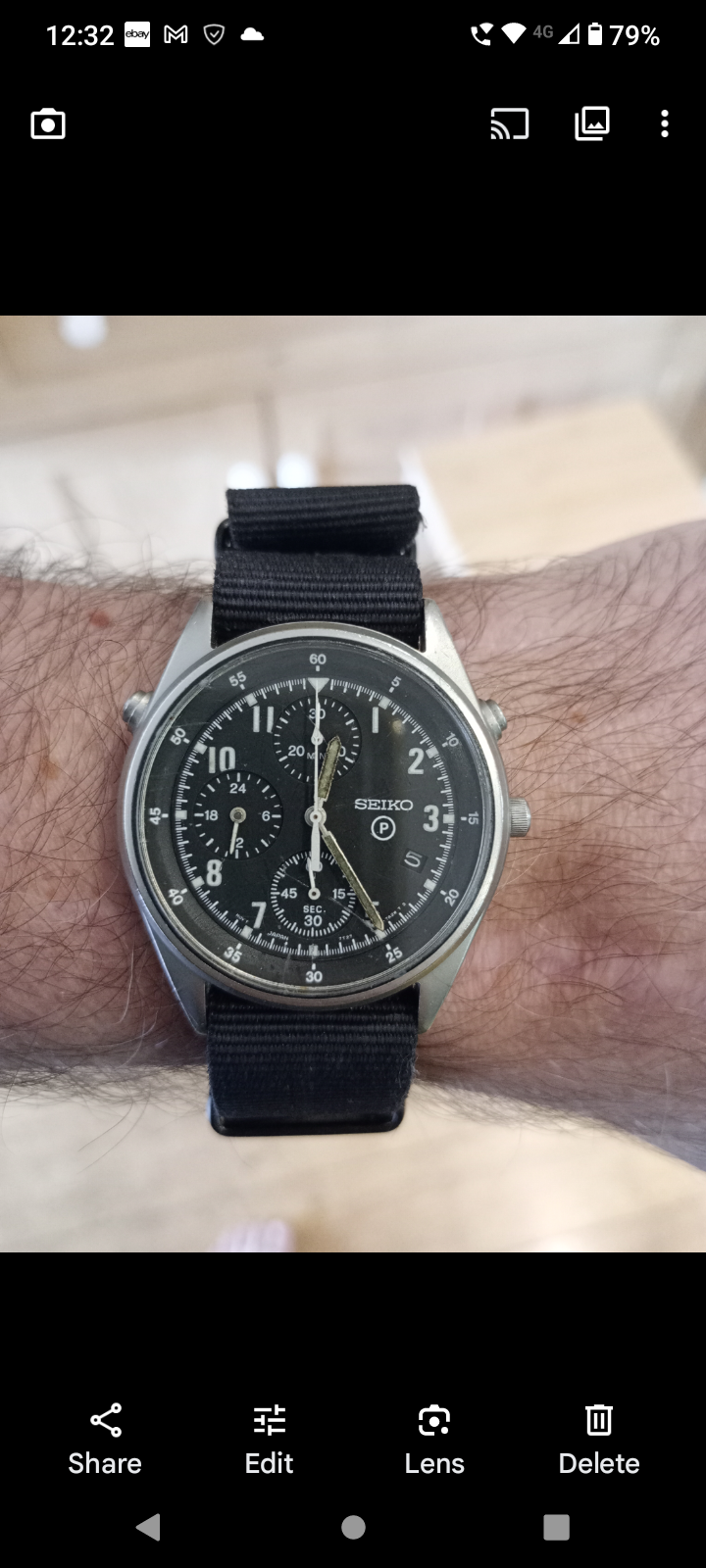

Well... it's only gone and started! Couldn't tell you what I did, came home late from work thing and decided to offer gentle persuasion... turned it around to get the movement out and noticed it ticking, result! Screenshot_20240716-2107122.png.06ac834f219ab24fae1542d94cf31ea5.png

Pleased with this one - as a fairly new convert to fixer uppers I've learned how to refurbish and relume (badly!) hands, I've switched the movement over including date wheel swap and rear plate, fitted the tiny hands for the first time and done my first non acrylic crystal swap. Here's how it arrived:Screenshot_20240704-123213.thumb.png.64b225a042f4246ea8ead7db54182e91.png
Might have a play with diamond polish on the original crystal at some point... Need a rear gasket and strap too...
Ah so I'm not completely sorted yet - woke up to find it stuck at 12 midnight. The date had changed though I'm wondering if it's calendar wheel related or possibly those relumed hands catching... Moved it past twelve o'clock and everything restarting fine and it's happily ticking now.
I'll wear it today and see what happens, though if anyone has a suggestion I'm all ears.

Well it's kept ticking fine - since I wasn't happy with the lume on the hands and I was suspicious it caused that stoppage I decided to bite the bullet and relume... went a bit thinner on the mix and spread on lighter with the correct (ish - used an oiler) tool. Happier with the results and hoping that it keeps ticking...IMG_20240718_114507.thumb.jpg.c5fc19dd4a9c4bff31537305e938745a.jpg
Got some oddness here on the hour subdial - I've read it between one and four hours out at different times. Wondering if it's catching somewhere? Any other possibilities?
Other than that it's all good - might have a go at cleaning up the OG crystal and will have a think on that hour hand.
