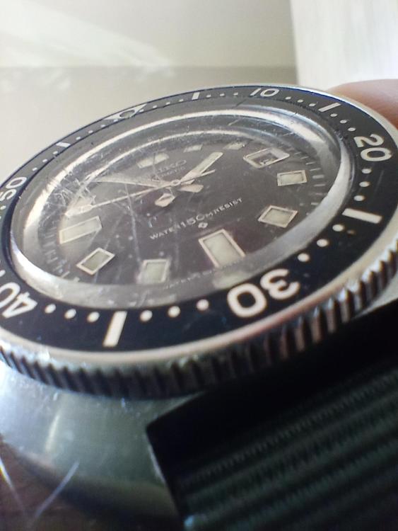

So I've come across a 6105 very much in original form - it's a beauty, albeit with some wear (which you'd expect from a watch of its age)... the crystal is far and away the worst part and while I have an aftermarket replacement on order I'm toying with keeping it as is, partly for sake of originality, partly because I have a shiny and pretty near identical 'homage' I put together a while back that I'm quite possibly going to keep for sake of sentiment.
So, it's a case of would you show off the dial/hands with a replacement, keep it as is or perhaps even tidy it up as best you can (diamond polish?) and go with that? Thoughts welcome!
In my completely worthless internet opinion, I consider crystals one of those parts that need to be replaced like gaskets or mainsprings. Unless the scratches have sentimental meaning (like "this is the scratch from the hospital the day my first child was born" or "this is the scratch I got pushing the busload of nuns and puppies off the railroad crossing") I see no reason to keep what is essentially a damaged part. If originality (not authenticity) is the goal, then sure, you could keep it looking like crap or spend hours sanding/grinding/polishing the scratches out but why?
Problem with polishing is that often these hardlex crystals get chipped on the edges so it might be impossible to get satisfying results. I don't mind an aftermarket crystal but I don't mind a few scratches either. I just bought the same replacement crystal for a different Seiko model. I haven't installed it yet but it seems ok quality. Spencer Klein claims to sell very exact copies of the original, mine was some random from ebay.

Difficult to see from the photos but my opinion is that if everything is
still legible then leave as is or maybe try and give it a light polish.
Also on something like this for me would have to be an original crystal or nothing.

Originality means something, and since I'm as sure as I can be this is the original crystal that counts for something in my yead... But yes, I didn't feel the same when replacing the gaskets (I did a bit on the bezel one, but only because I had the bezel working nice).
Maybe there's a middle ground of waiting it out to find an OG, or fitting the new one while attempting to tidy up the old one (which incidentally is my plan with the Seiko raf).
Yeah - this has a small chip so I'd be trying to get better rather than perfect, which I doubt is possible with hardlex anyway. I'll have a look at Spencer Klein's site - there's seikosis too and another guy who did type 4s and was on about doing type 2 as well. Pretty sure the one I have on order is the same dimensions as the type 4, though I'll see what it's like on arrival.
Hard to photo but while I can live with the scratches on it I also know how much pleasure I'd get from seeing that dial/hands in HD!

Appreciate the input - if it was acrylic I'd definitely polywatch it so maybe I'll try polishing up that other one first with diamond paste and see how that turns out.

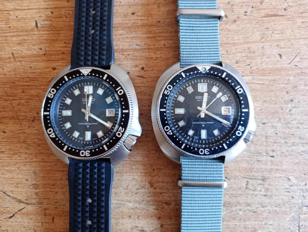

Update time. Crystal arrived and I was a bit disappointed - dimensions/bevel was fine but it lacks the distortion of the one fitted.
I should have stopped there, but true to form I thought I'd 'just have a look'... the good news is I had my first proper look at the dial and hands uncased, and I'm very pleased. Bad news is the crystal is out, and unfortunately the gasket can't be reused...
Onwards - ordered a gasket for the short term (not 100% it will fit an if it does it will be the wrong colour), in the longer term I have a repro gasket and crystal on the slow boat from Australia.
At least I have my copy to wear!
