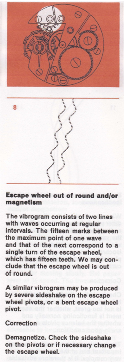

so basically what you're saying is magnetized hairsprings are overrated as to the consequences of them being magnetized? Here's a image from a timing machine manual they show an interesting sine wave effect that could occur
then does it really look like this well sort of it depends upon the timing machine. Normally most people will demagnetize their watch before even putting it on the timing machine. so normally this is something you should never see at all.
except a long time ago somebody purchased a Chinese 1000 timing machine apply recommendation and he was bewildered by his collection of watches. his meant I did not follow the normal procedure but instead placed all of his watches one of time on his timing machine and for reference compared the mine and you'll notice in this image magnetized watch
then identical watch demagnetized and now comes some other interesting things. There is a minor problem of it's really hard to synchronize both timing machines's they're always be a little bit of variation of exactly what part of the waveform they're averaging but to still really close. you will notice there is not a spectacular amount of it's running fast because it's magnetized. Yes this watch along with several other was watches were extremely desperately in need of proper servicing. So the amplitude totally sucks and yes the watch is out of beat.
then this is not a modern hairspring this is a blued steel I believe it was a Howard pocket watch. So obviously it's going to be much greater affected by magnetism that a modern watch but it does show there is in fact. Often times at work they forget to demagnetize wintertime a modern watches so if they see anything that looks a little off then they'll do what they're supposed to do to make things look a little better so true it's not a spectacular amount but it can be seen on the timing machine.

Not at all. What I am saying is that the effect of magnetism in a scenario where the coils do not stick together is significantly less the impact that sticking coils has. I'm certainly not trying to suggest that magnetism has no discernible effect.
It's interesting to note the differences between Alex's magnetised trace in his video, which I would (rightly or wrongly, I'm happy to learn) attribute to a shortened effective hair spring length and the wavy traces you presented above which might be explained by magnetised wheels with poles whose orientations change relative to each other periodically as the wheels turn relative to each other.

I think classic laypeople think that magnetized hairsprings are stuck together. But they would be running it so insanely fast if they were the timing machine wouldn't even show anything at all at least not the conventional timing machine and even then you'd be going insanely fast. I think you're more likely to see worst-case scenario what I showed down to just minor variations. Then yes is not fun putting a super magnet on top of the balance wheel. Not something normally recommend but interesting thing to do anyway.
