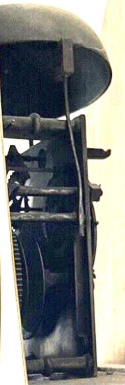

Lets see if you have learned anything
oldhippy
It appears that the movement parts include some stamped brass and CNC machined shafts. Also various unfinished or rough looking parts, that I do not think would be allowed by any decent clockmaker.
I don't think it's very old. Another modern reproduction.
You are right it is another Chinese fake. The chinese carriage strikes always show the striking works on the back plate and not between the dial and front plate. The bell is poor and it always has two holes in it. You hardly ever have a sweep seconds hand on French carriage strikes. The platforms are normally of a white/gray metal and the platform screws are not positioned as you find with the French types which have four screws while the chinese tend to have three.
You are both having a go which is good. I do have a good laugh over these little teasers. Don't forget I have years of experience when it comes to clocks, I don't expect many to hit the nail on the head first time.
Have a go Neverenoughwatches and RichardHarris123. Pick the bones out of this when I saw it I burst out laughing, I thought this is just right for my friends to have a go at. Who ever points out the most will be the winner.

A weight driven movement without accessible arbors through the dial. Might be wound like a cuckoo clock?
Could it be an one-hand movement with just an hour hand? The minute hand is replaced by the numbered disk behind the dial. Then not only the hands but the dial with minute numbers are wrong here!

It looks like Mr. Caygill of Asrigg liked that general style of movement, with various complications - there are a few other examples around that look to to have similar movements? eg.
https://drumfarmantiques.co.uk/shop.html#!/products/an-18th-century-oak-longcase-clock-0x2c--the-dial-inscribed-caygill-0x2c--askrigg
https://www.johnmoran.com/auction-lot/a-george-iii-caygill-of-askrigg-tallcase-clock_8C343C9979
One without winding holes in the face, as with Oldhippy's example, but movement not shown:
https://auctions.tennants.co.uk/auction/lot/1405-an-oak-thirty-hour-longcase-clock-painted-arch-dial-inscribed-c-caygill-askrigg-late-18th/?lot=2174874&sd=1
So what we have is a complete nightmare. It is a marriage but it is obvious, when a marriage is created with clocks it is done in such a way that only those with a professional eye now what to look for, but this a blind person would spot it.
So first the movement, the reason it has no key holes it is a 30 hour movement they work on a continues chain or rope  and you wind it up by pulling on the chain or rope it works on  a single weight, some also have a tiny weight which is called a donut and it helps to feed the chain such as prevent tangling. It strikes on a count wheel on the back plate which you can just see. This dial is a bit of a mystery because the number 5 has a short tail which was used up until 1710 but the pattern should be latter? As for the sweep second hand as you can see it is a modern red one they never existed not in 30 hour movements, I’m wondering if the seller just stuck it in to make it look good the other hands are modern and the look as if they are from a battery movement. You can tell by the movement and the room it has sitting on its seat board that the case doesn’t belong. The case or should I say the hood is in the style which is called Swan neck very popular. The long door is a sign of around the nineteenth century. As you see it really is a bag of spanners.
