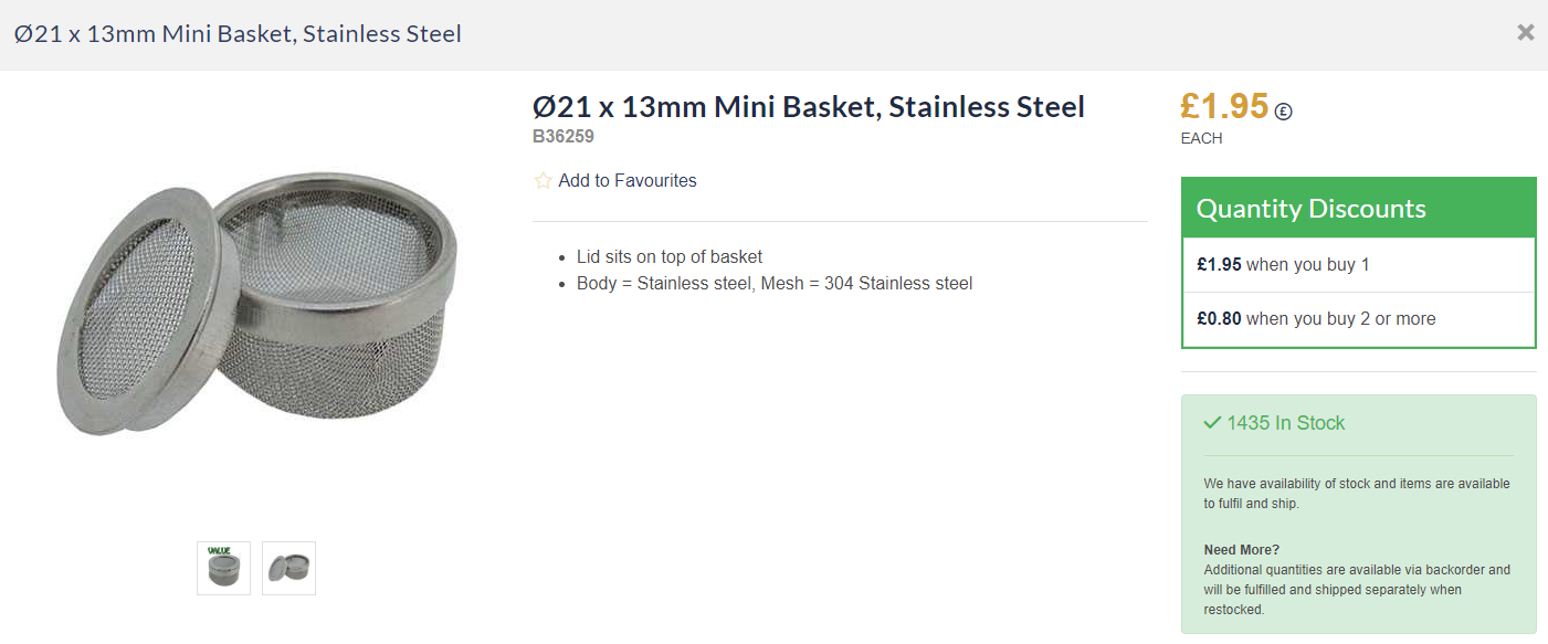

Good Afternoon fellow enthusiasts.  I am newer to watch repair and am enjoying the hobby so far, but I'm having an issue when I run things through my ultrasonic cleaner.  Some of the smaller screws seem to escape the mesh baskets I have, and I'm looking for the best to keep everything inside, so I do accidentally lose tiny parts.  These are what I have now, and the mesh is too open, apparently.  5 Pcs Ultrasonic Cleaner Baskets, 304 Stainless Steel Jewelry Steam Cleaner Baskets Ultrasonic Parts Cleaner Basket with Lock and Hook for Cleaning Jewelry and Small Parts https://a.co/d/8LdGSZH

8 minutes ago, CYCLOPS said:
David1984, get some of these tiny baskets for smaller parts, I saw these on eBay, there are other styles too...
Tbh, i dont like these, the brass screw together is heavy and blocks valuable solution getting in, i might put big parts in,but anything with a pivot.......🤔..the baskets roll around a lot....a pivot pokes through the mesh and its days are duly numbered. The best cheapish ones around are some that @Jonposted a few months back for ali.x , they had a finer mesh and good lids.
I use that style in different sizes, though I pack them in an outer basket, all upright, with extra one if required so they cannot roll around.
They work fine in the ultrasonic - but I would not use them in a rotating style machine, due to things being thrown about , as Neverenoughwatches says.
I use the tiny stainless L&R like above myself, the brass ones for overflow needs, the brass is generally less expensive too and most on here just dip there movement/parts to clean also....
On 10/17/2024 at 9:55 AM, HectorLooi said:
I found that brass baskets react with ammoniated cleaners and shorten their useful lifespan. And with the cost of L&R #111, that can really hurt the pocket.
I agree that they do the first time or two, but then seem to stabilise - I've used mine dozens of times & still only half way through my first can of L&R 111 (which included doing a couple of mantel clock movements).
