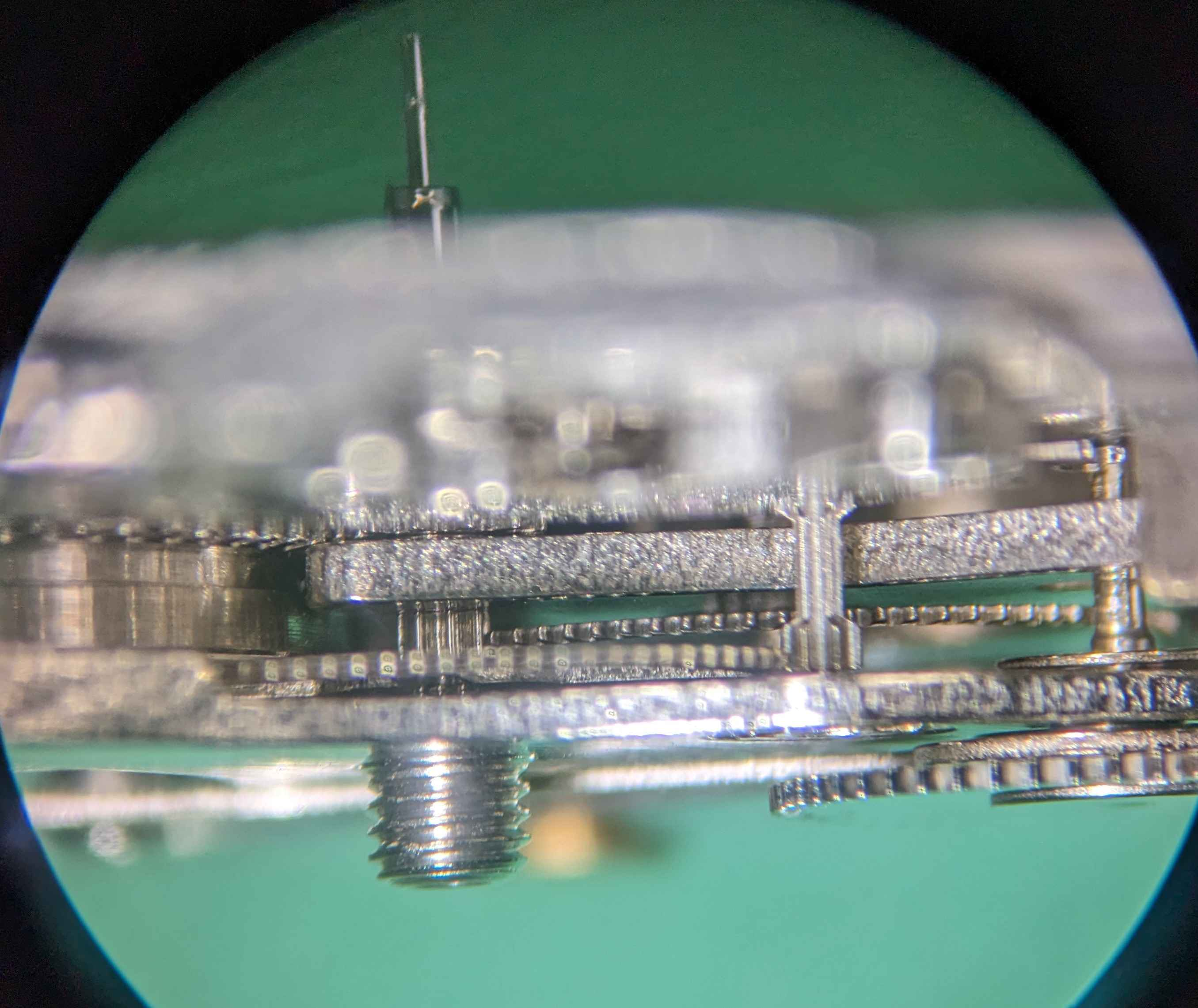

1 hour ago, Birbdad said:
Couple photos of the gear train. Endshake all seems fine, nothing rubbing that i can see.
So how free is the train spinning col ? If there is more friction than normal , you'll see some abrupt motion reduction, sometimes it can be quite subtle though to make a difference it would be quite noticable. Can you post a 30 second or so vid of you winding in some power .

4 hours ago, mikepilk said:
Is it possible the barrel could touch the centre or fourth wheels ?
So it SORTA Looks from the picture that the barrel is touching the center wheel bridge but i can confirm it isn't. I do not believe it's touching anything but i can't see it from all angles enough to determine that.
Another option you could try Col, though a bit laborious,  is to try installing one train wheel at a time, checking the end and sideshake as you go. Lack of endshake is an obvious amplitude killer and can be seen on each wheel ,sideshake can be less obvious if only looking at one wheel at at a time, cumulative excess sideshake over the complete train can foul up the wheel and pinion meshing, can be difficult to pin point with it all in place , but introducing one wheel at a time makes it easier. Not just dial position checks so include crown positions.
