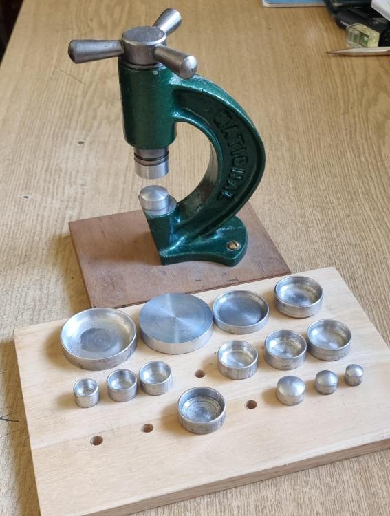

Absolutely, this is my National press. I have seen these go for less than £10 on eBay in the past and it is a great piece of kit.
I only have plastic and Bakelite dies for the Robur which are fine for standard crystals but the edges are a little too delicate for things like press on bezels and case backs. The National only has aluminium dies (I also have a few brass ones that can be adapted) so this gets used for more demanding tasks, but it would only require minimal modification for your dies to fit and you would then have a very viable alternative to the Robur at a fraction of the price.
Thanks marc, thats great information,  I'm pleased i asked the original question. It just made sense and I've seen a few of these pliers presses with shallow curved bakelite dies before. The National press, there was one the other day on ebay and that sold for £10 , different name but the same press in black. I like it, feels like a good idea 👍

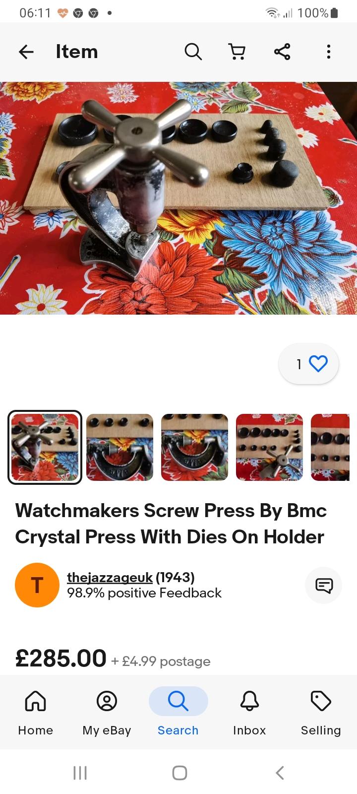

 I have also seen these branded as BMC.
I think someone is having a laugh

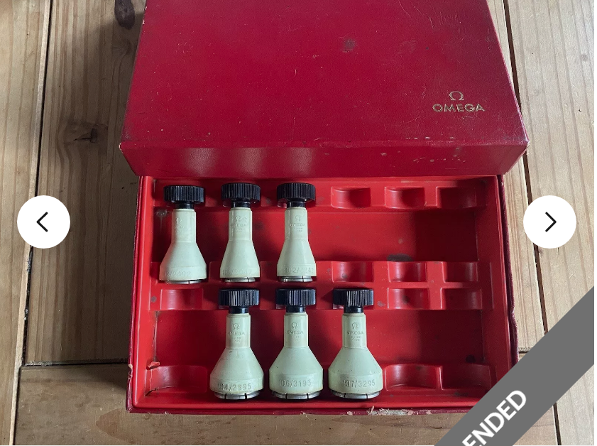

I had this set for Omega watches, this is all I could find in images in a box as you can see this is incomplete. I had the full set.
2024-08-22 11_50_12-RARE Omega Watch Crystal Vintage Remover Tool Glass Repair Original Swiss Made _.png
Ive been after those for ages expensive, rarely seen as a full set now, occasionally sold in singles.
