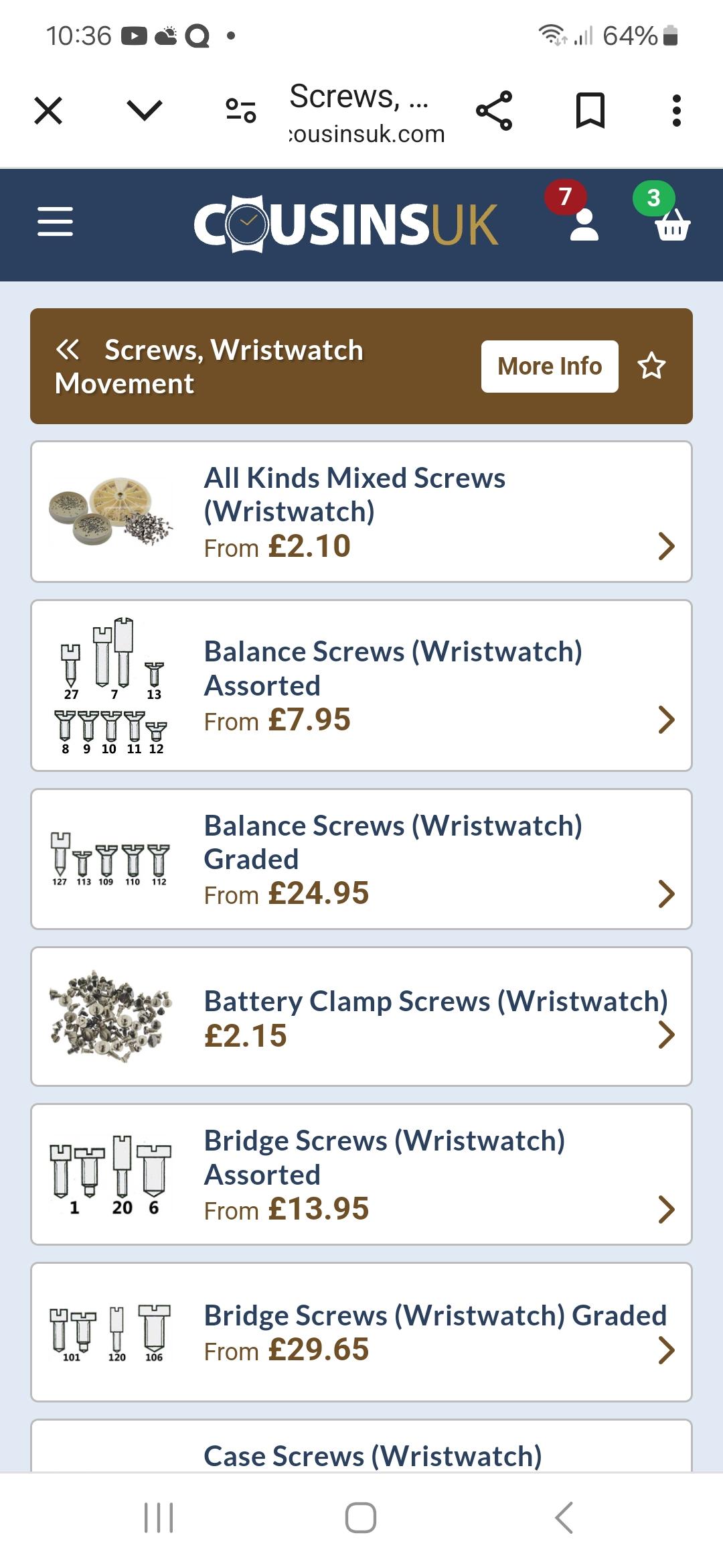

I'm now looking for an assortment of watch-sized screws, washers and other tiny bits needed for this hobby. Where do you all source stuff like that?
