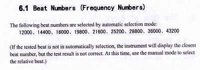

I'm Doc Krebs and a watch repair hobbyist. I recently purchased a weishi 1000 and have tried to learn it. Any watch I place in the mic stand, reads at 12000 the the system resets to auto detection mode without giving a full reading, graph or otherwise. Any tips? Thanks in advance.
I'm attaching an image out of the 1000 manual and you can see 12,000 is the lowest of the automatic frequencies. The only problem is I don't know of any watch that runs at that frequency so the machine is definitely having an issue if that's what it's defaulting to.

I think we have a confusion here? For instance your software it automatically will detect the quartz watch?
I snipped out an image from the manual for my timing machine. This is the witschi watch expert two and this is for the automatic range. Notice the lowest frequency 12,000 not 3600. Up above I snipped out the image from the Chinese manual which has one more frequency higher up because they kind of sort of cloned the witschi watch expert three which has a higher frequency.
But poor show is a sad description of a witschi timing machine.
what I suspect is the problem of not reading the users manual where it very clearly states that this is a timing machine for what exactly? Let me snipped out an image. It appears to be a timing machine for mechanical watches.

rather than guessing I thought experiment would be in order. The Chinese 1000 machine did not perform as described by the original person asking the question. In other words the LED flashed once a second indicating my stepping motor watch was in the microphone but it just sat there with the screen waiting for the ticking of a watch. So in other words is an automatic mode it it's not knowing whatever it is that it's receiving.
I then changed it to manually 3600 and now it out of the auto mode into the graphical display mode but no graphical display or numbers. I guess the timing machine knows that it's not acting right for a mechanical watch.
On the other hand the witschi version number two is different? First it did flash its LED and it has a speaker so I could hear it ticking once a second and it said out of range. So in the auto mode it defaults to it knows it's not her auto range were in the auto range. So then I changed it to frequency mode which the Chinese version does not have and of course it confirmed that it was a 3600+ or minus one second which I found amusing. Then it still refuses to display anything because the amplitude was out of range. But once again witschi has more options so I put it on rate only mode. so basically it does the rate only does not do the calculations for the amplitude or beat and usually you can force it to give you something if it's having a problem with whatever it's hearing. Now it did give a graphical display and said my watches running slightly fast and based on the graphical display if this was a mechanical watch it would be having severe escapement issues as it was not producing a nice straight line across the timing machine.
So the interesting thing here is and for anyone that has the Chinese 1000 machine you should put a quartz watch on and see if any of us can simulate the original problem?
