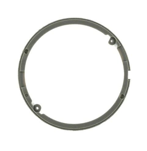

Adding dial feet to a dial to align with a Seiko NH 34 movement. I have the coordinates of the feet. Anyone have an accurate way to transfer location of 3 and 9 o’clock to the back of the dial so I can scribe a reference line on the Bach side . I have a Sherline mill with x and y control but I need a starting point
Anyother method of locating feet would be appreciated.

I dont know how the dial feet are held to a NH34 and without looking but could you temp attach the dial with sticky and mark through the feet mounting holes on  the movement ?

The dial feet just lije up with the spacer ring.
That looks relatively easy to do.

Feet are held in with slight friction fit in plastic ring around movement.  I have dial stickers so I’ ll locate the dial and then scribe back thru dial foot hole.

Or you could just position the spacer with rodico to hold it in place and then mark through.
I've seen people before now just glue the spacer to the dial and forget about the feet.
 Remove all remains of broken feet from dial ,  to a flat surface.
Fit the dial feet in dial foot holes of mainplate.
Put half a drop of  Epoxy 5 glue on back side of the dial plate, where the feet is to be located.
Install  the dial ring on mainplate.
Put the dial plate on top of feet, roughly positioned to show hours right.
Put the whole thing in the watch case, adjust hour indicators to exact position.
Let the glue cure.
You now have exactly positioned dial indicators and the glue has cured.

20 minutes ago, mikepilk said:
Cousins sell selection of dial feet for just £5.95. The heads are thin (0.1mm) so don't take up much space.
 On these type, the glue can go streight on top of the pins, you then put the dial on top , case the movement, stem in , and fine adjust the hour markers, holds strong enough so no need to solder. ( saves dail paint).

I think leaving the crystal or bezel off will help to line up the dial when the movement is cased, there is a good chance the dial will slip around while casing up is carried out.
There is also the thickness of the adhesive to consider, this could easily be thicker than dial feet base depending what is used.
