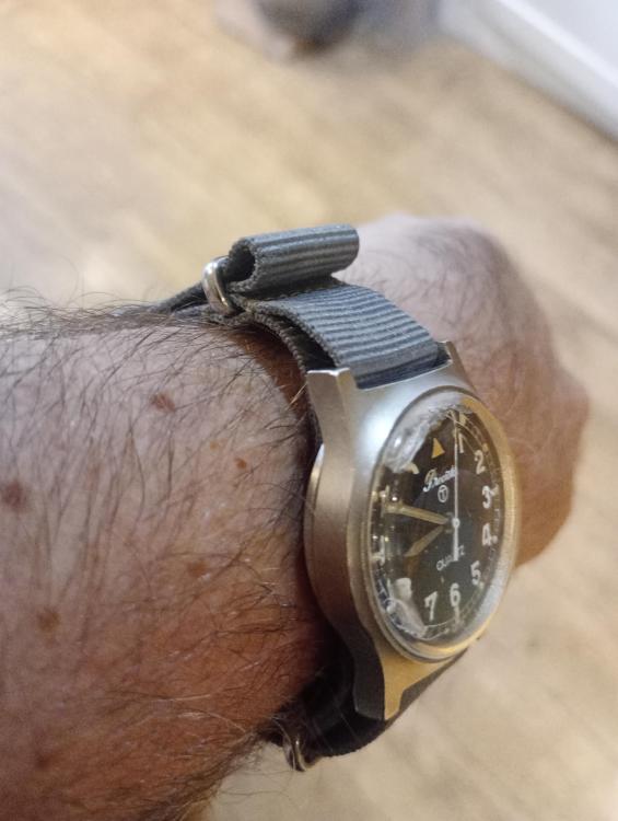

So I've an old Precista G10 fatboy here that I'd like to remove the movement from as it needs a new acrylic - I've tried using a syringe to pop it out to no avail and really would like to give the case a clean too...
So yeah, in theory (based on reading) the movement drops out with the case back  removed by inverting the watch, in practice this isn't the case and I'm not sure what the process is for helping it out? Any ideas?
Pic below - I think theres an inner movement ring that's the full height of the watch case which I assume is gunked up a bit?
Should add I've tried a crystal lift to remove the crystal too.

Crystal lift is a cheap one, which is probably why it's not working! Maybe I'll have to take it to someone with a decent one...
Thanks for the link - I know that one well and what a great blog. Not sure if the Precista version is put together slightly differently - the crown assembly/gasket setup isn't what I was expecting from my later version cwc so perhaps there are other differences.

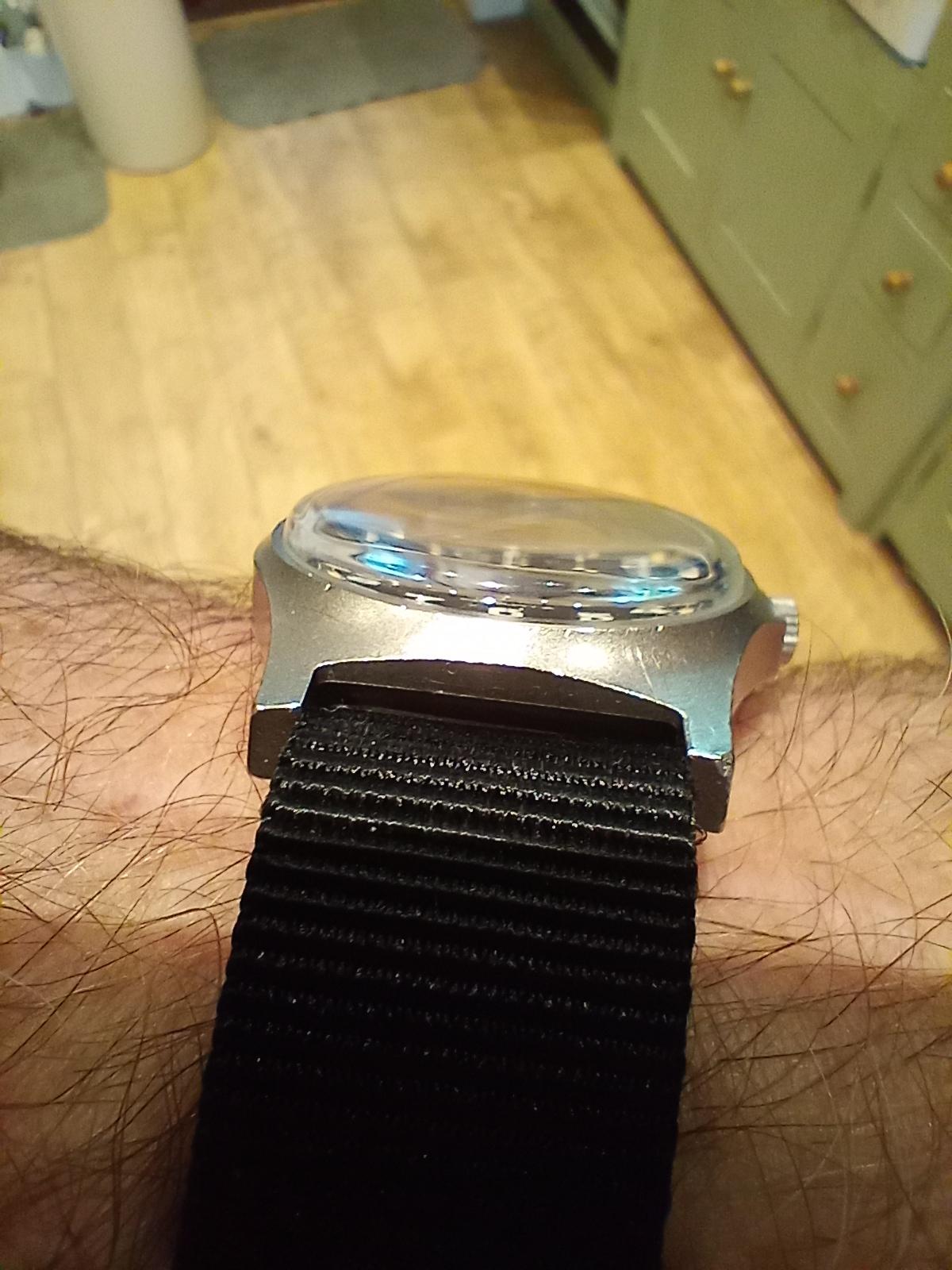

Here's a photo of the front side - you can see why I want to replace that acrylic though I'm currently trying to convince myself period warts and all is best!
Watch is running great as far as I can tell - arrived yesterday via mail in a jiffy bag which felt very wrong!

Manage to get it out with compressed air, albeit with slightly more aggressive form.
1 hour ago, AndyGSi said:
Did it come out the back and was their a movement ring?
I removed the crystal and pushed it out gently from the dial side - while I didn't seperate the movement from the ring I'm pretty sure that I could have done, so to answer your question yes I'm pretty certain the movement is held in place by that ring shown in the picture above.
Because I had one I've fitted a domed mineral for now - looks great though I've the correct part on order that I'll make decision on later...
