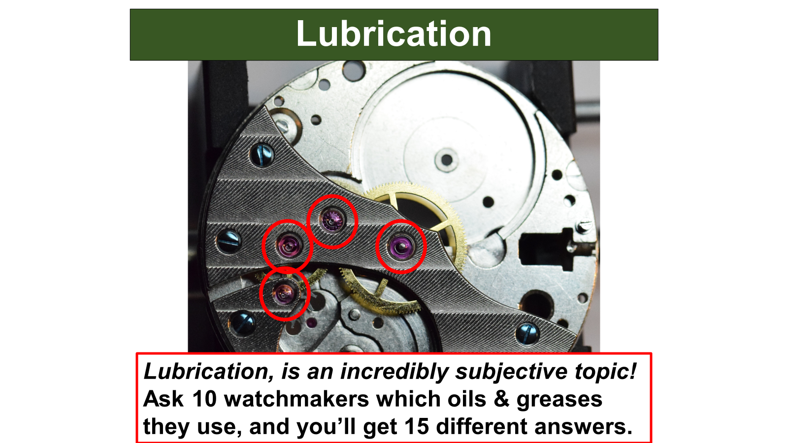

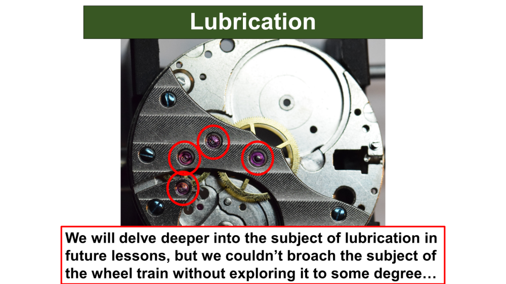

Hi guys,
I know this might stir up a hornets nest, especially talking about lubrication, but I really think this is a very subjective matter in watchmaking that needs explaining to anyone who is new to horology, or isn't quite sure to buy yet another lubricant because the service manual says that is what is needed. Higher end isochronistic movements tend to have a bigger variation of lubricants, but they are not always needed and equivalents can be used.
I'm not here to tell anyone what to use as a lubricant, I want to explain what I use and most importantly why and it has all to do with torque and speed of the arbor needing to be lubricated.
So, the slides will explain more than words, but the important thing to remember is you have high torque/low speed at the barrel and low torque/high speed at the balance cap jewel and staff, there will varying degrees of torque and speed as the force travels from the barrel to the escapement and if you know what that is, you can choose a lubricant to suit that particular torque and speed based on something specific.
I once trained a watchmaker of 13 years from a very well known watch company here in England (I won't say which one) and when I asked him what lubricant he used and where, he told me he uses the same as the guy on the next bench. When I asked him why, he told me "Because he uses them." So, he was basing his choices of lubricant based on the guy next to him, with little understanding of the subject.
When I started out it was confusing what to use and where and WHY!
Also, taking into consideration the size and age of the movement will sometimes change the decision of what to use, where, but most importantly why, because your choice is based on some science and experience, rather than the guy sat next to you. That kind of science you only learn by listening to the guy down the pub tell you what is best!
