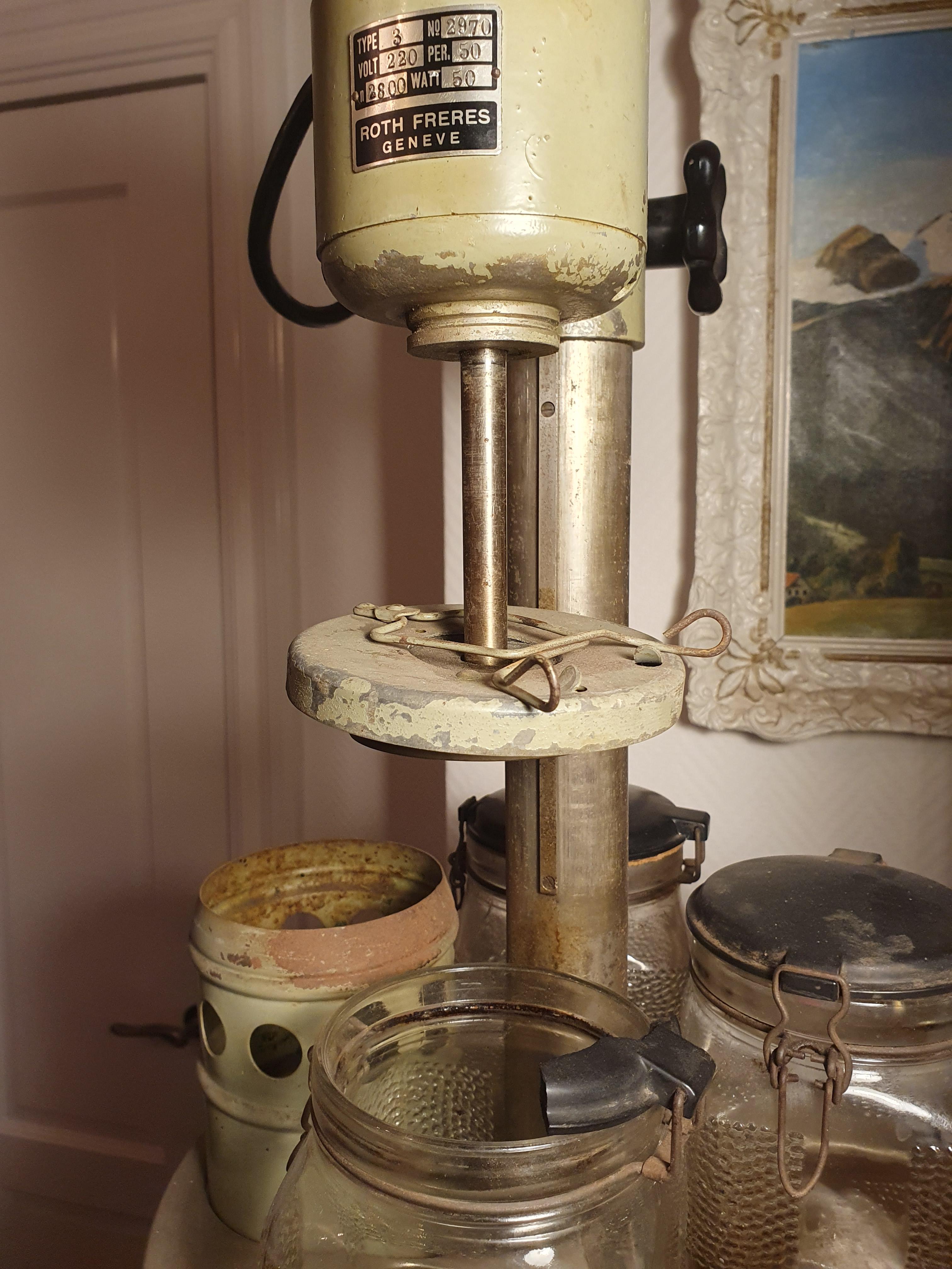

Does your machine have any way to cover the jars when spinning off the excess liquid?
If it hasn't, you might consider making something like there is on this Roth Freres machine (still in it's "original" 😀 state..).
