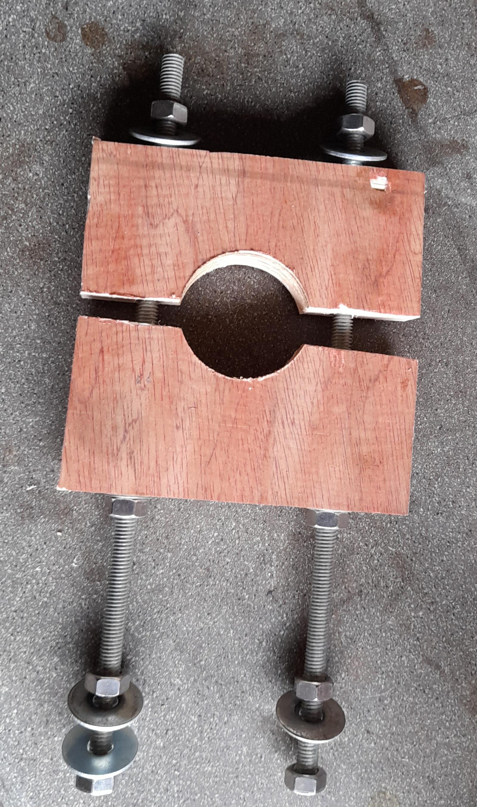

Good evening,
I hope someone can point me in the right direction. I'm in the process of building (attempting) a mainspring barrel removal device. The challenge being to build it as cheap and safe as possible.
I've looked for ready made mainspring barrel sleeve's The ones I've found are really expensive and I can't really justify the cost. I've read about hole saws with the teeth ground down and using copper pipe adaptors being used. Are either of these practical and safe? If they are does anyone have details of the sizes they used?
Here's a couple of photos of the progress so far. Still need to determine the size of the axle which is dependent on the solution for the sleeves.
I need to rebuild the clamp as I'm not happy with the holes aren't straight and I'll to get some wing nuts
Thanks in advance
Hi.  What you are attempting  has already been done by may from the plans put forward by Joe Collins.  If you look up mainspring winder by Joe Collins you may still be able to get hold of the plans and other information;.  Initiall builds for 400 day clocks they have bee adapted for all types of clocks except fusee clocks which have a very powerful spring.
i have built  two of these and another in metal under construction as time permits. Regarding the spring retainers , I tried several DIY versions but in the end bough5 ready made ones as they are quite strong.

I have a set of unused ones that I would sell they owe me £40 so that plus postage if interested I will post pictures.

Thanks Watchweasol. Good to hear feedback on the sleeves, and your confirming my thoughts as to purchasing ready made ones.
I've seen a number of videos of varying quality and trawled the interweb, again seeing similar but not a whole lot on the type of sleeve. The Joe Collins lead did bring up a picture of a winder using a hole saw, I may go down this route yet.
I'm not tackling 400 day or Fusee springs, just the ones on my Westminster chime Haller movement.
Dell, thanks for the offer if you have any pictures and dimensions that would be most useful.
