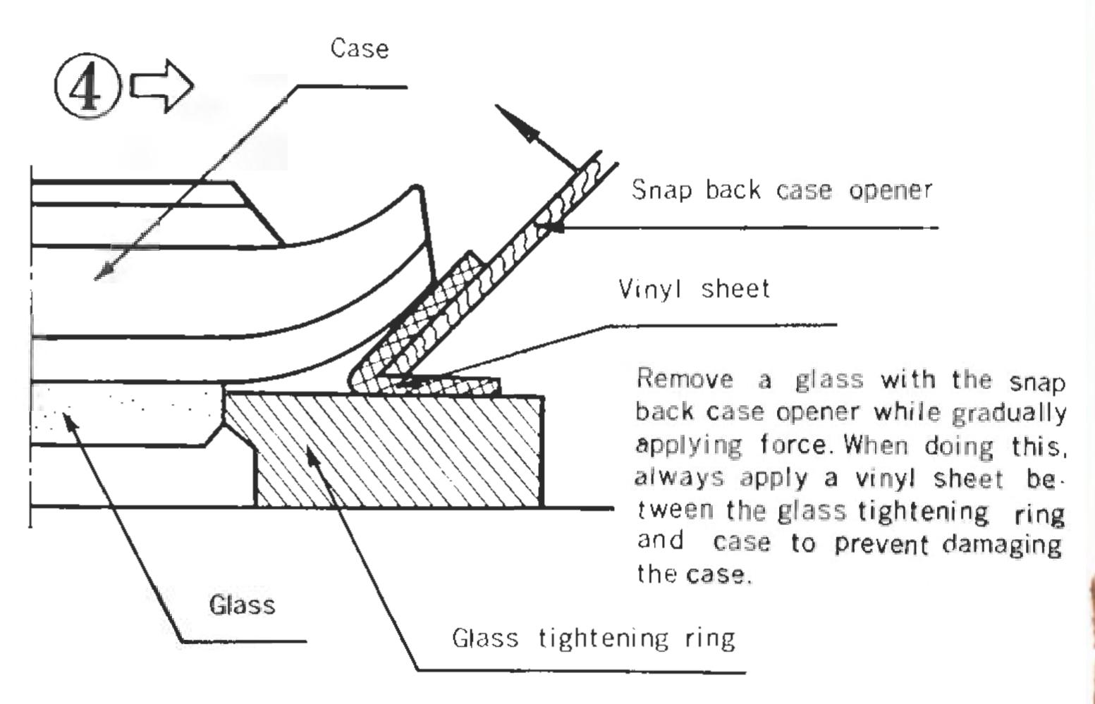

I would have loved to have such a tool when I recently popped off the stem from my grandfather's Elgin with monocoque case, but the tool is way too expensive.  I tried my cheapo Presto tool and it didn't work.  Resorted to using end cutter pliers, carefully getting the jaws under the crown.  A bit of pressure and the stem popped off.
The other challenge was getting the crystal off.  I used one of those claw crystal lifts (cheap version of a Bergeon 4266).  The crystal stubbornly didn't want to come off.  So, I had to tension it a bit more.  Got it off, but the crystal cracked.  The alternative for the claw type crystal lift for me is a Mido Ocean Star tool.  Got one from a watchmaker friend of mine.  Practiced with the old crystal and that looks to be a much better solution.  The Seiko S-14 tool set looks to be another option.  Not sure if you can find the Mido or Seiko tool new.  I do see them on eBay, but probably not too frequently.

Seiko S-14 is a more gentle alternative to the claw type. You're not supposed to tighten it to the point that the crystal releases (cracks). You first apply enough pressure for the ring to hold the crystal. Then you tighten it a bit more and wedge the crystal off with a case knife as pictured in the manual. These are affordable and abundant in Japanese auction sites.

Seems like a good idea when the crystal wont quite release, i wouldn't use a case knife though,  too risky for case damage even with protection. Just something to lever between the case and lifter, a simple chisel shaped delrin probe would suffice or two as opposite levers.

Cracking the crystal was not my intention, of course.  I tightened the claw to get a good grip but had to keep tightening it until I was able to pull off the crystal.  Hadn't thought of using something to pry between the claw and the case.  Anyway, the claw type lift seems too likely to damage a crystal.  If not cracking the crystal, leaving marks where the claws bit into the acrylic.  The compression type wrenches seem to be a much gentler option.
