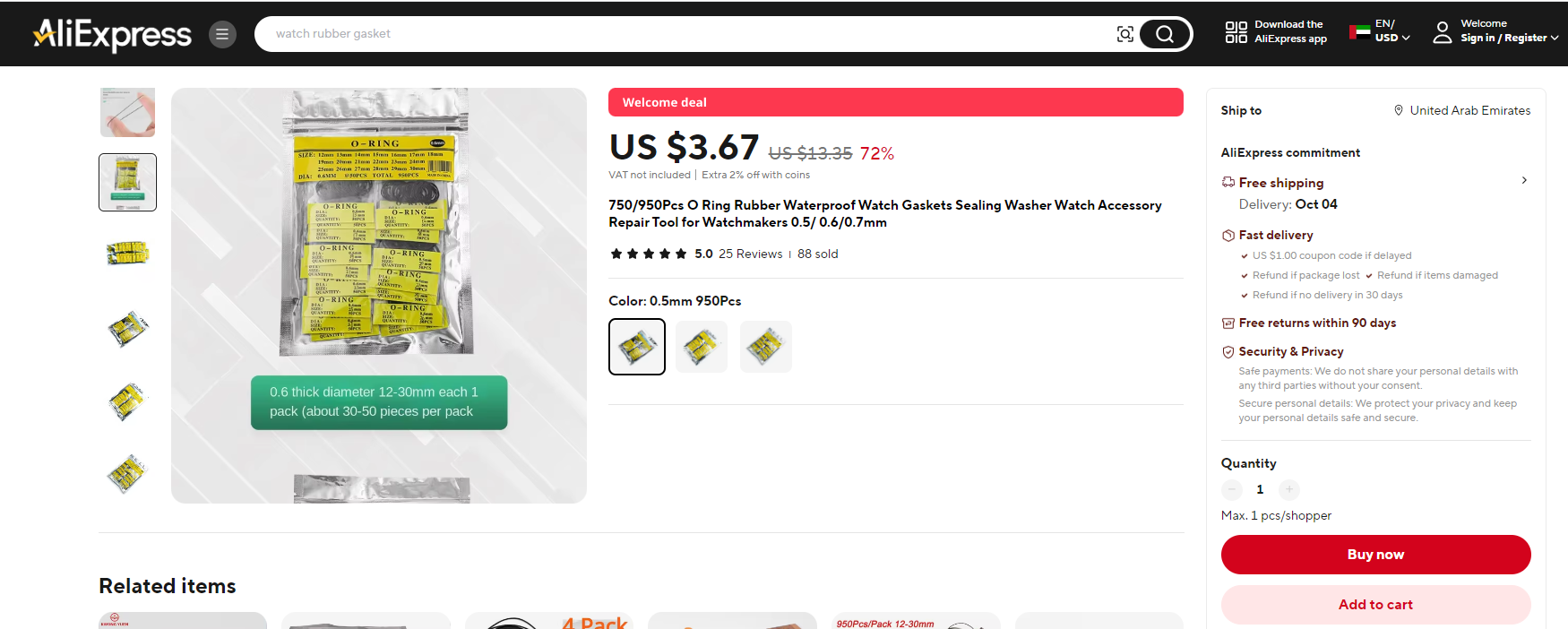

Timex guaranteed water resistant for only one year as long as the watch had the original crystal, stem\crown and case back.  Point being made is moisture can also be getting in from the all three.  BUt the case back is a good start.  I use generic rings that came in a multi size package.

Measure the old one and purchase a new one
This is easier said than done, perhaps the easiest way is to use a measuring cone:
These can be expensive, but if you have a access to a 3D printer you can make your own:
https://www.printables.com/model/471050-o-ring-sizing-cones/files
To calculate the outside diameter (OD) of the o-ring, you just need to measure its thickness using a caliper or other tool and then use the formula below (credit here):
To calculate an o-ring's outside diameter (OD) you may use this formula: 2(CS) + ID = OD
If you have the OD and need to find the ID use this formula: OD - 2(CS) = ID
Another slightly less accurate (but still more than good enough) method to approximate the o-ring size is to cut the old o-ring and then measure its length = circumference...
So diameter of the o-ring = length/π
Finally, o-rings can break fairly easily, dropping them in a cup of hot water will soften them up and allow them to be stretched a little more without breaking - in a pinch I have even used a cup of coffee on an oil rig at 3:00 am in the north sea to do this - you can't always find hot water but you can always find coffee! ha ha.... but not suggesting you use coffee here, before I get strung up, just an amusing anecdote.
