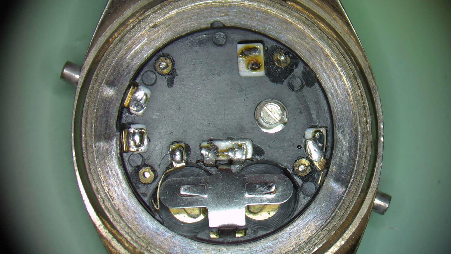

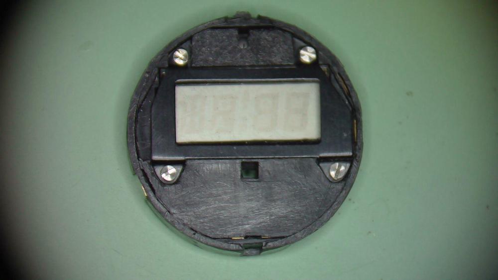

I'm servicing a Rodania Quartz and I'm unable to figure out the type of batteries required to get it to work again. I can't locate any numbers on the movement and a search of the internet via Google or ChatGPT hasn't produced any results. If I post some pictures of the movement & watch would someone be kind enough to advise me of the type of batteries I need to buy? The batteries would need to be thicker than I'm use to as the depth of the battery pocket is larger than I've seen before. Thanks in advance for any help that can be provided.
I'd expect them to be an SR41, SR43 or SR44 but if you measure the diameter you'll be able to see what's required from the list below.
Edit
This just shows the Low Drain SW Versions but you may be better going for the High Drain W Version.
Edited by AndyGSi
Thanks for the help. Using my digital caliper I was able to determine that I need to order two SR41SW / 373 batteries. Where did you find this chart as there maybe one for a high drain battery?
